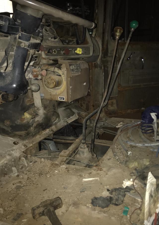

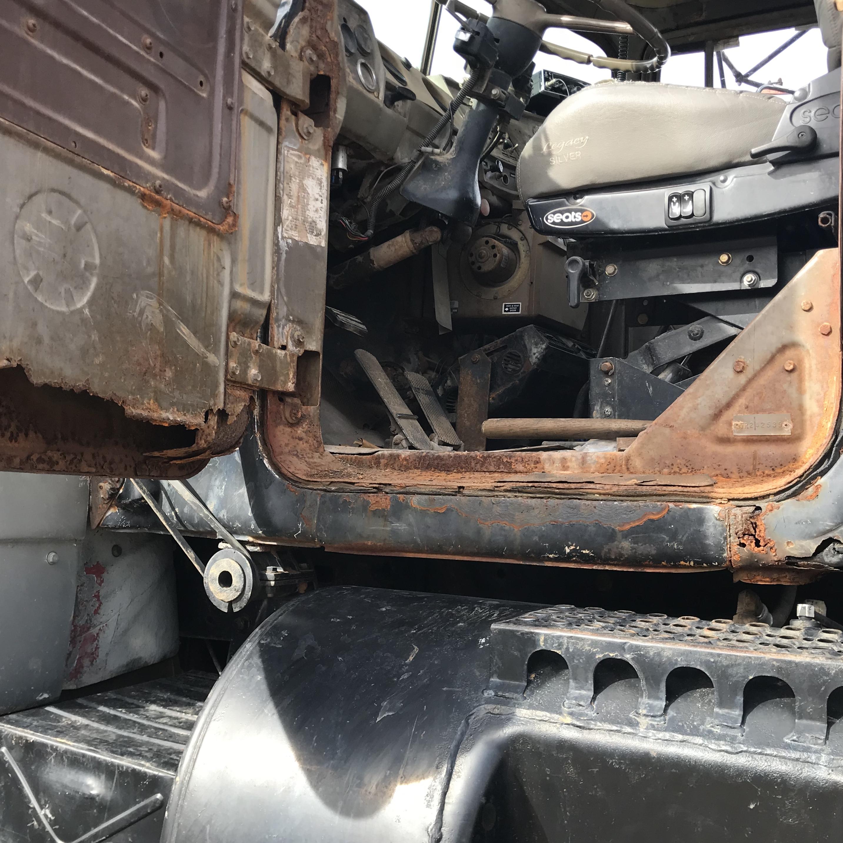

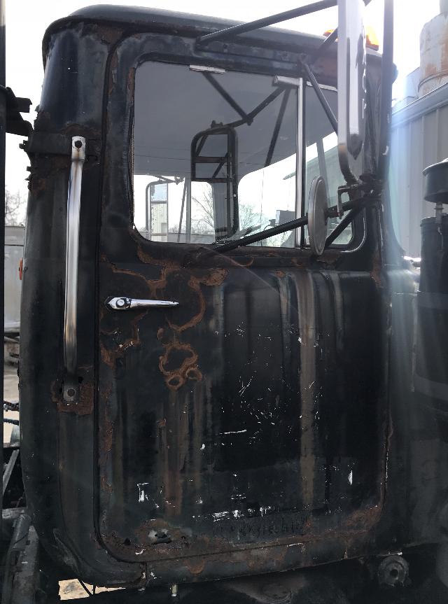

There’s a few pictures of the rust bucket. Thanks to rob for help with loading pics.

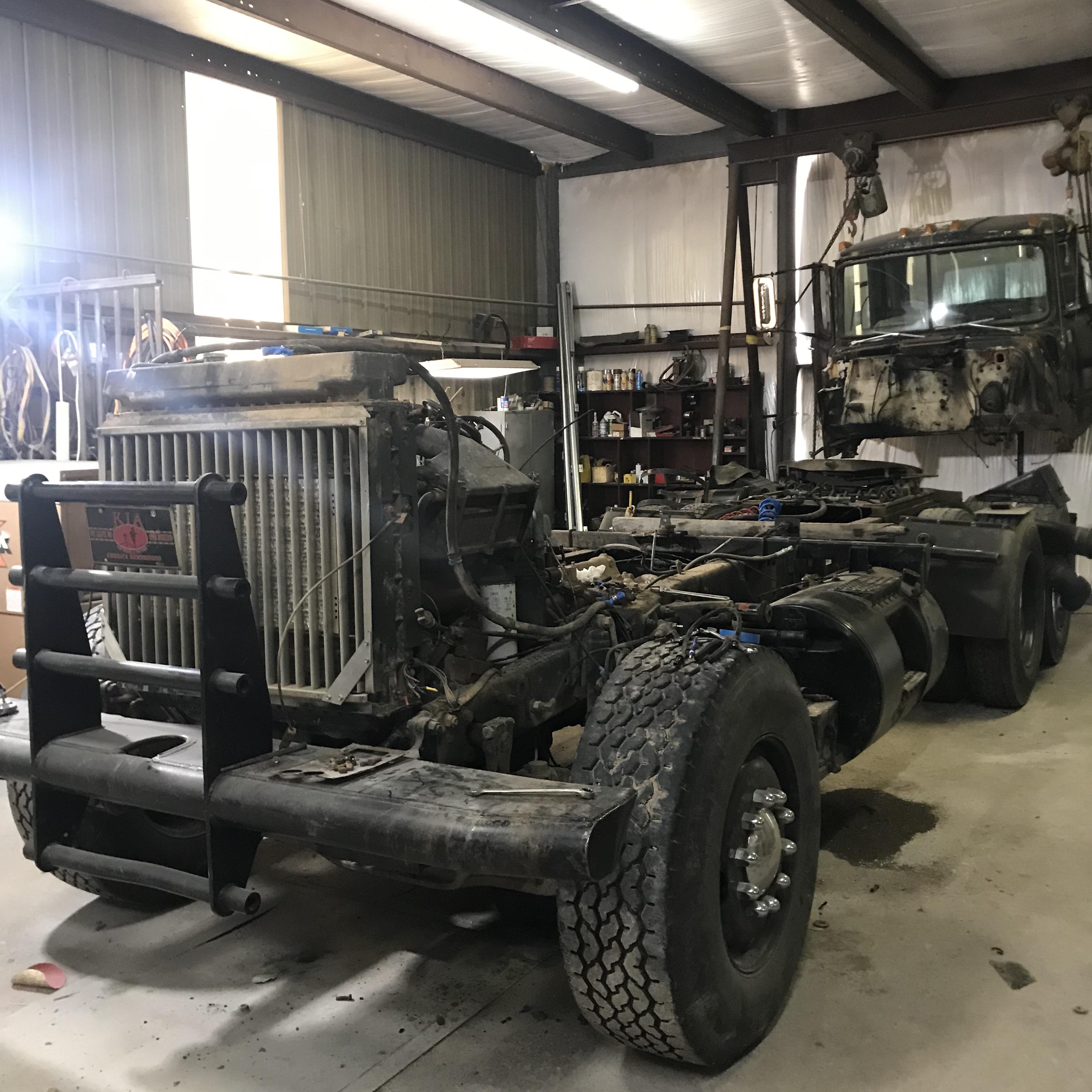

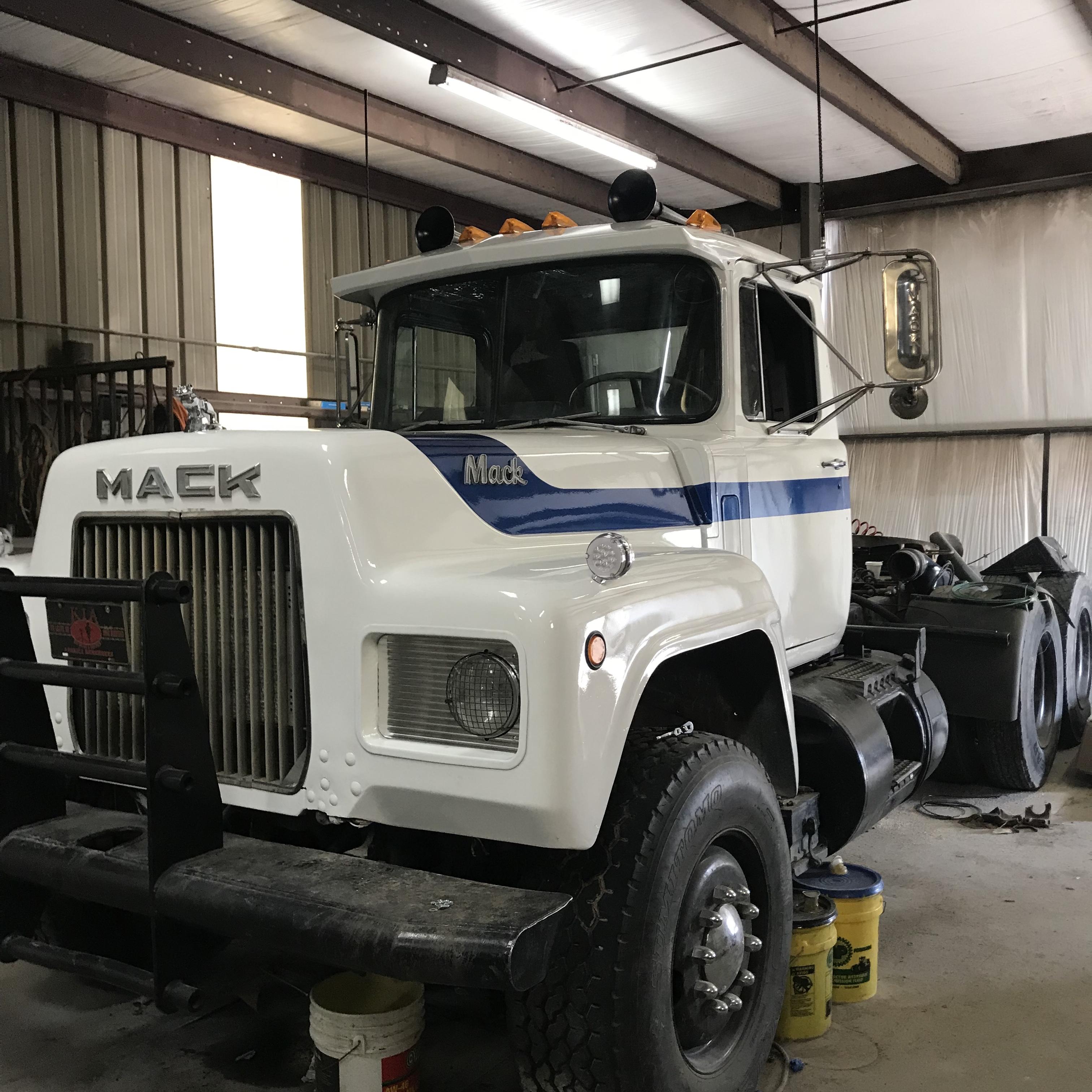

Got everything apart and started back together today. I went ahead and pulled the 107 and put the 9LL in with a new ceramic clutch kit today. Got the new to me cab and the hood painted with DuPont imron.
