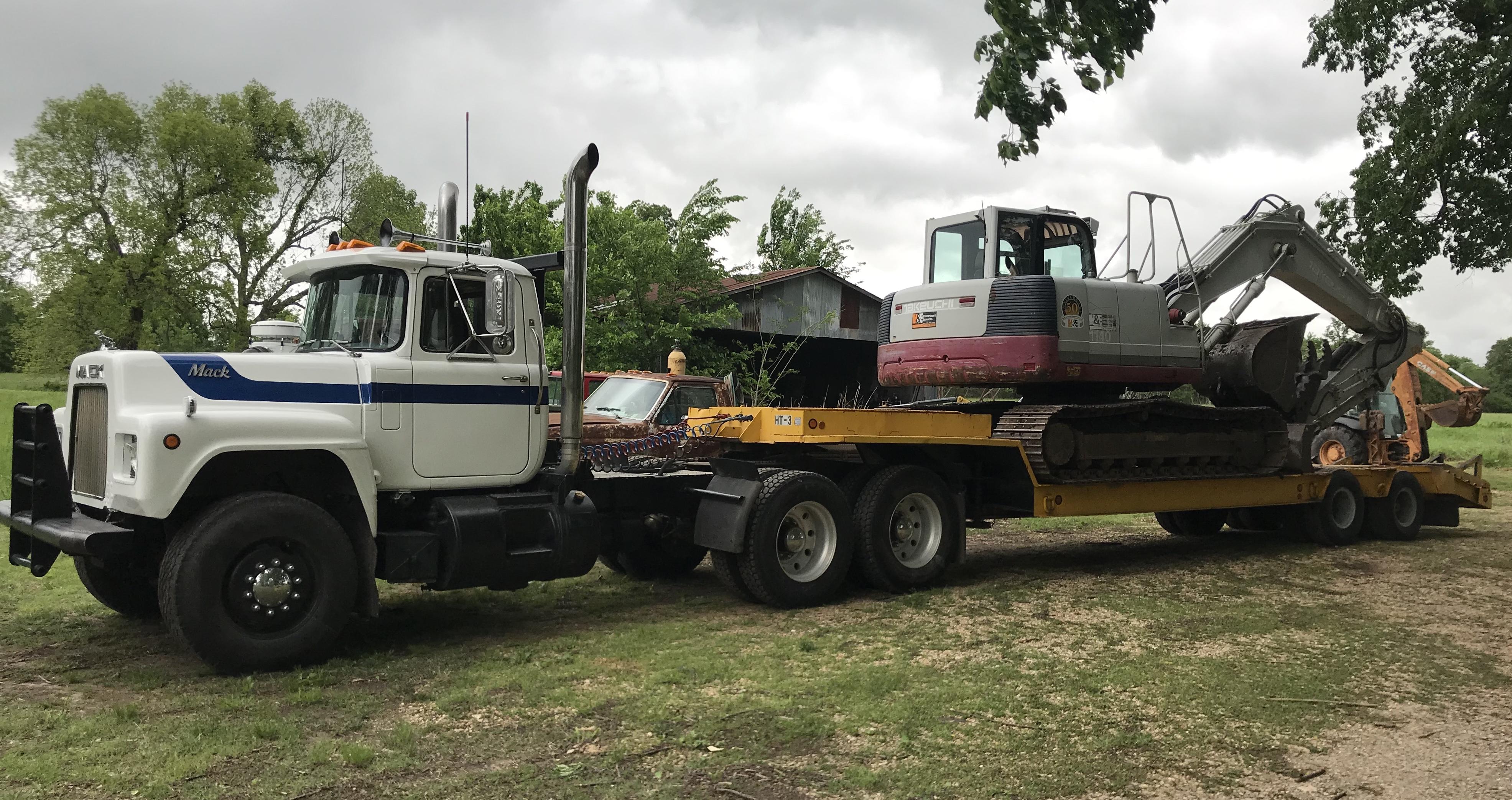

I have a 1978 R685ST with a 285 maxidyne and the 2 stick 6 speed with 4.17 rears and tall 24.5’s. Truck is getting a new cab this week and paint job. Old cab is rusted out badly. I have an Eaton RTO14909MLL from a wrecked mixer truck with E7, I think has mounts that will work. Now would be the time to swap transmissions if I want. I was thinking it would help lower my rpm at highway speed and give me a little more top end and maybe help me out on hills. I live in an area with lots of hills. Pull a lowboy to move my equipment and pull an end dump. I like the 2 stick but the gap from 4 to 5 is pretty big with all the hills and I can only get about 60 mph or so on flat ground to the floor tached out. Transmissions look to be within 1”-2” of each other in length. U joints different. Would it be worthwhile to swap? Since the cab is off anyway

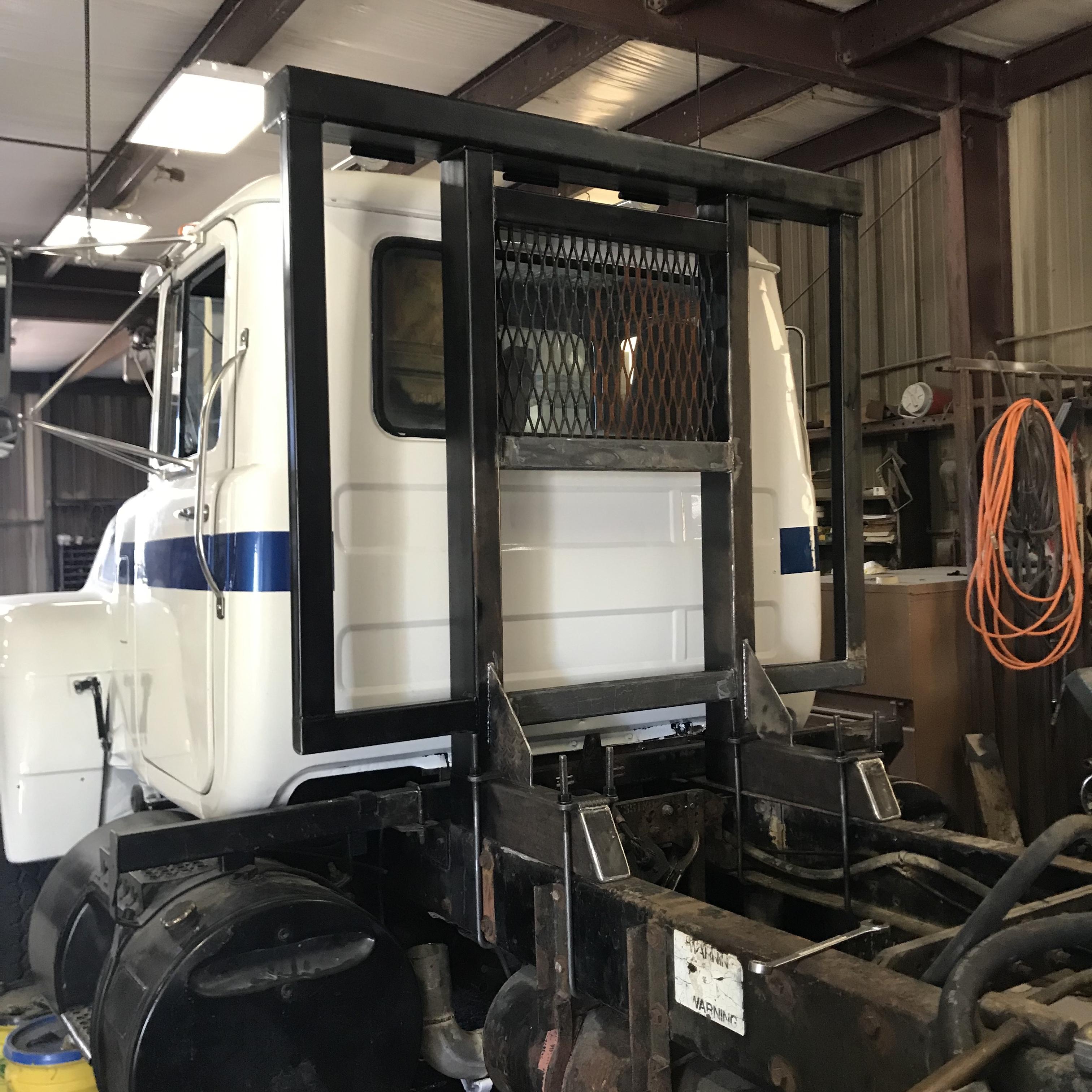

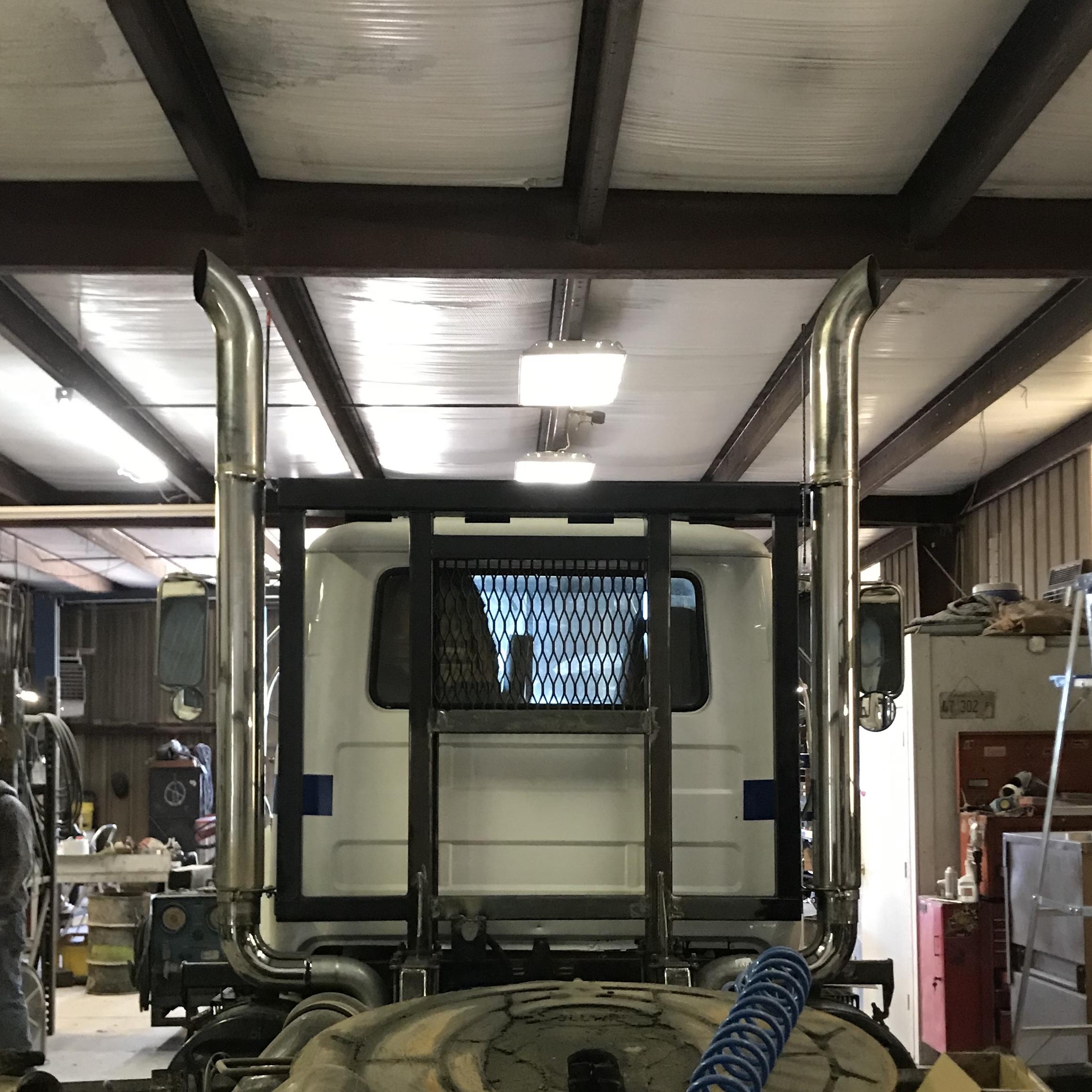

I’m planning to work on the truck tomorrow. I’m gonna try to fab up something different for the stacks if I can. I just do not like the headache rack. It’s just too tall and way wider than the cab. If I can figure something out I’m taking the rack off.

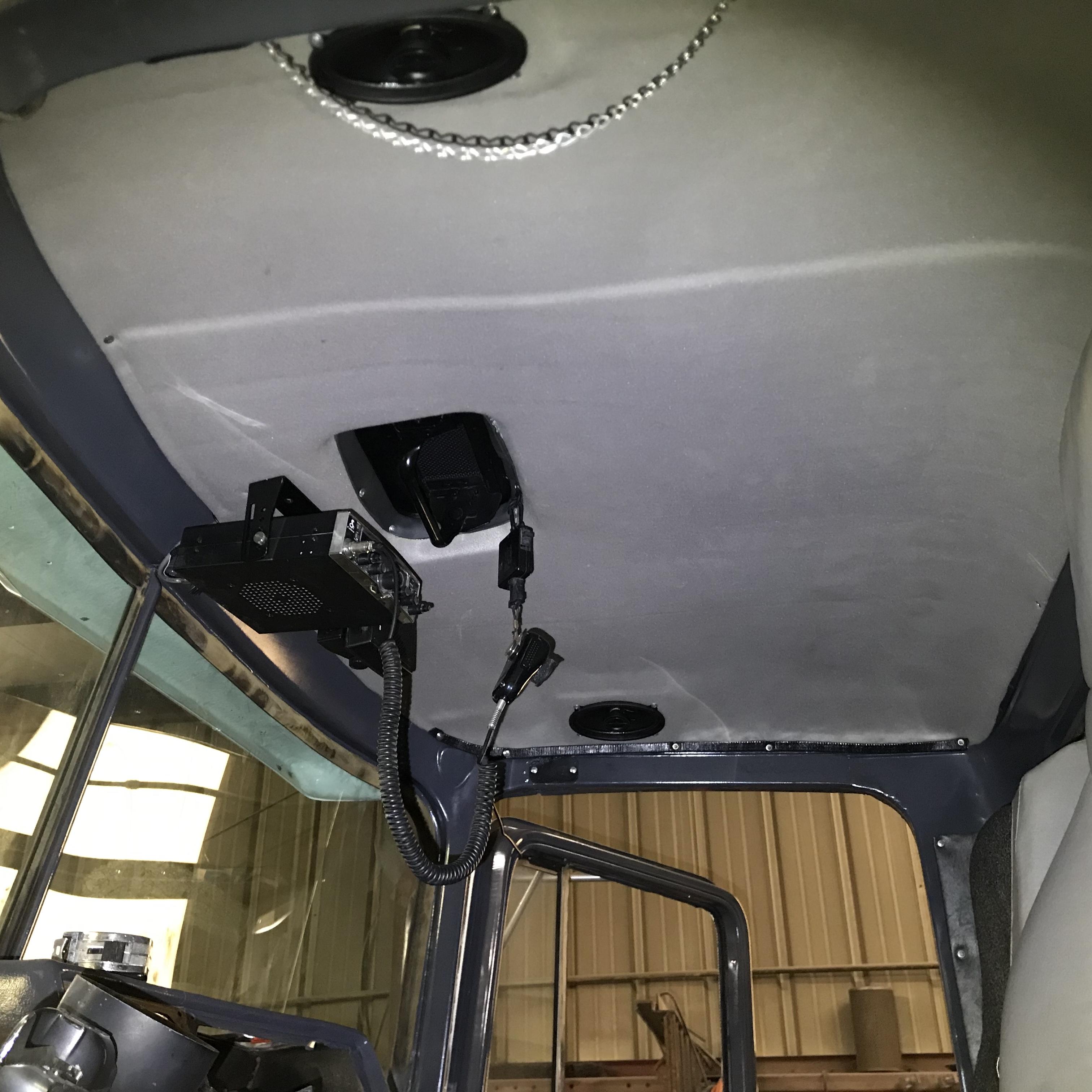

Thank you. I hope so. I’m anxious. Lol. I got the new kingpin kits put in it today. Naturally when I pulled the front drums the shoes were pretty much done so I’m off to hunt down new shoes first thing In the morning. May as well get 2 new tie rod ends too. I got a new set of drive tires to put on and I came up with 4 Alcoa’s from a buddy for the outside rears. Need a little polish work but I think I can get them to look well enough. Oh and after putting all that insulation in the cab I’m gonna pick me up a new stereo while I’m in town getting brake shoes...😁
