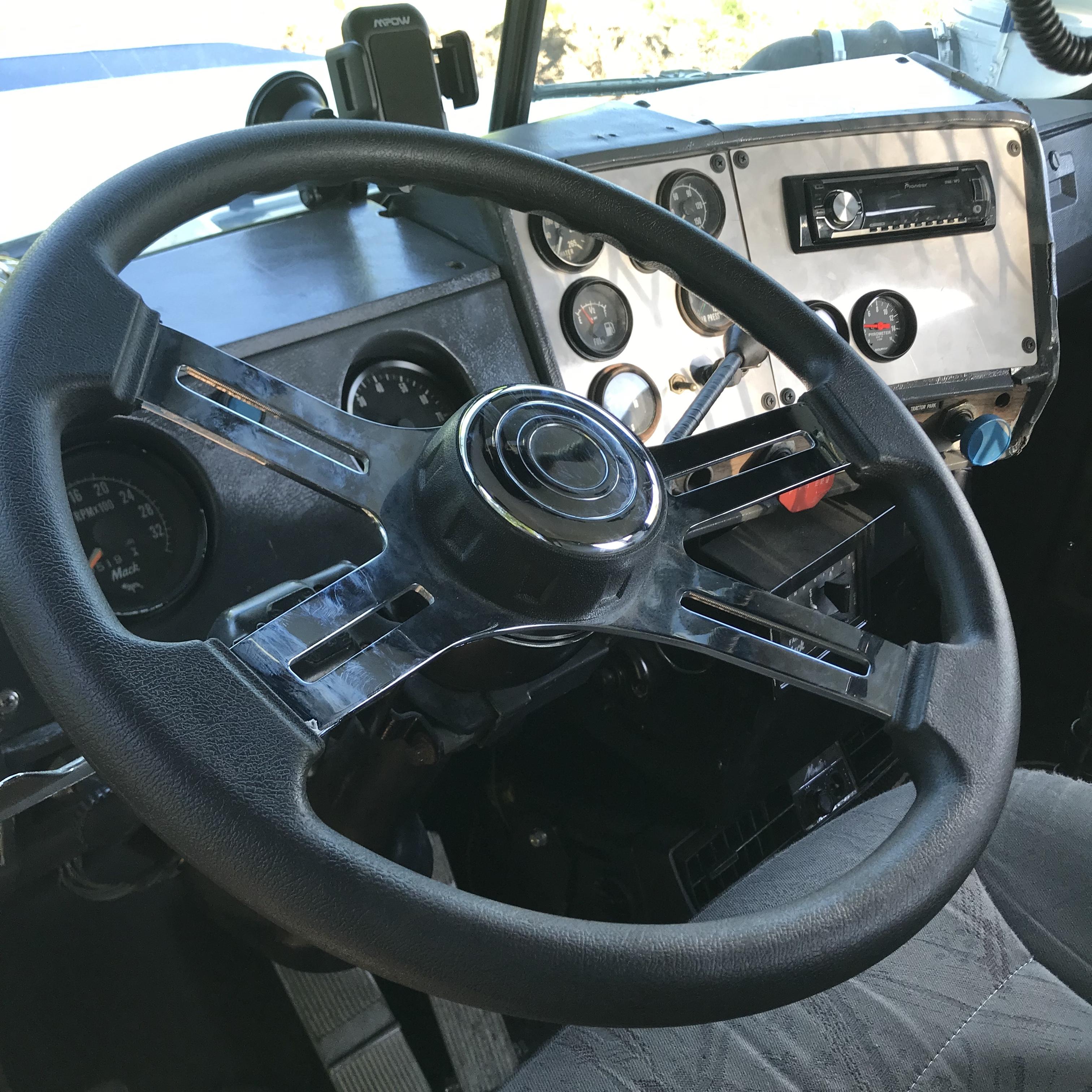

The steering wheel is an sci brand called classic polyurethane steering wheel. I got it from Raneys and I think it was the cheapest one.

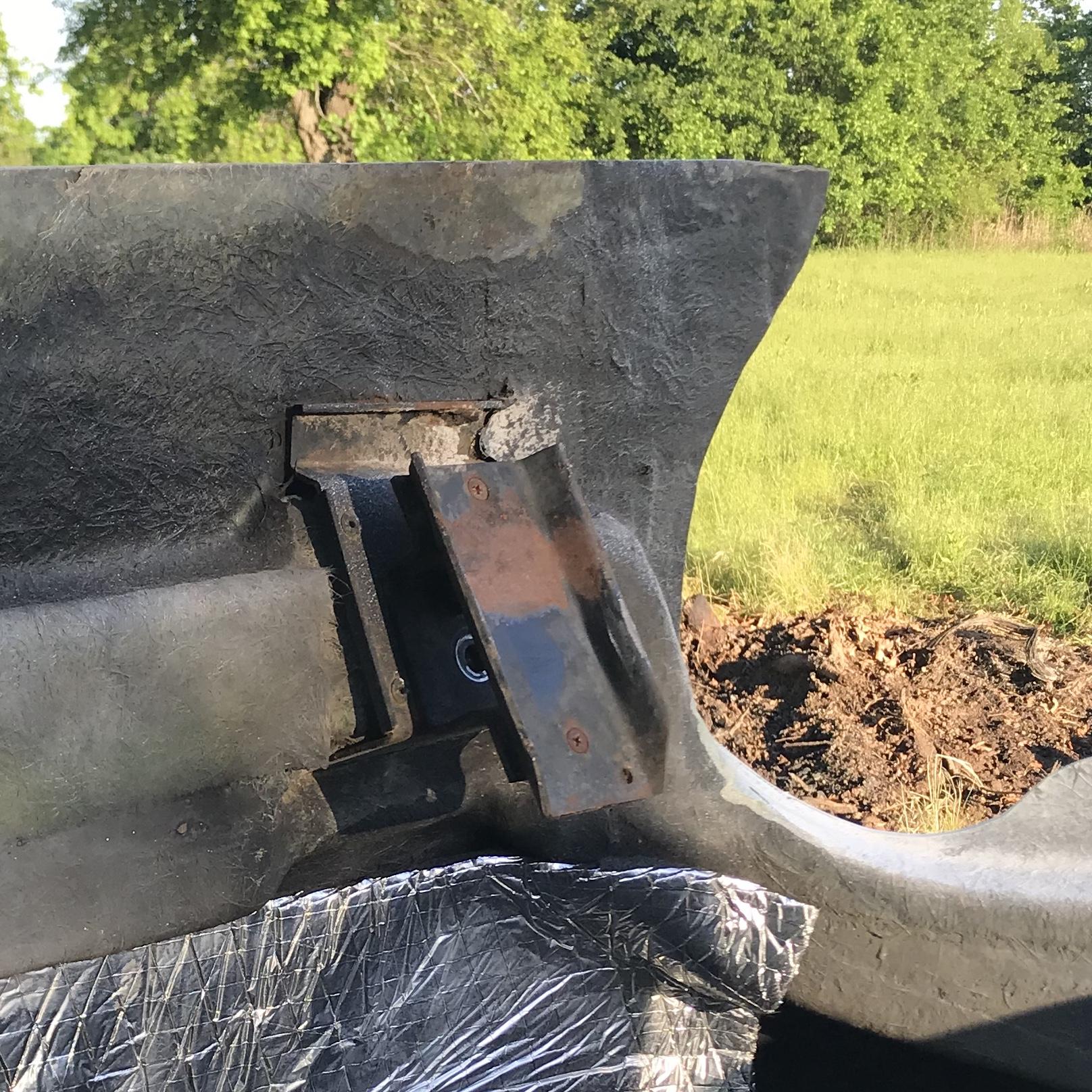

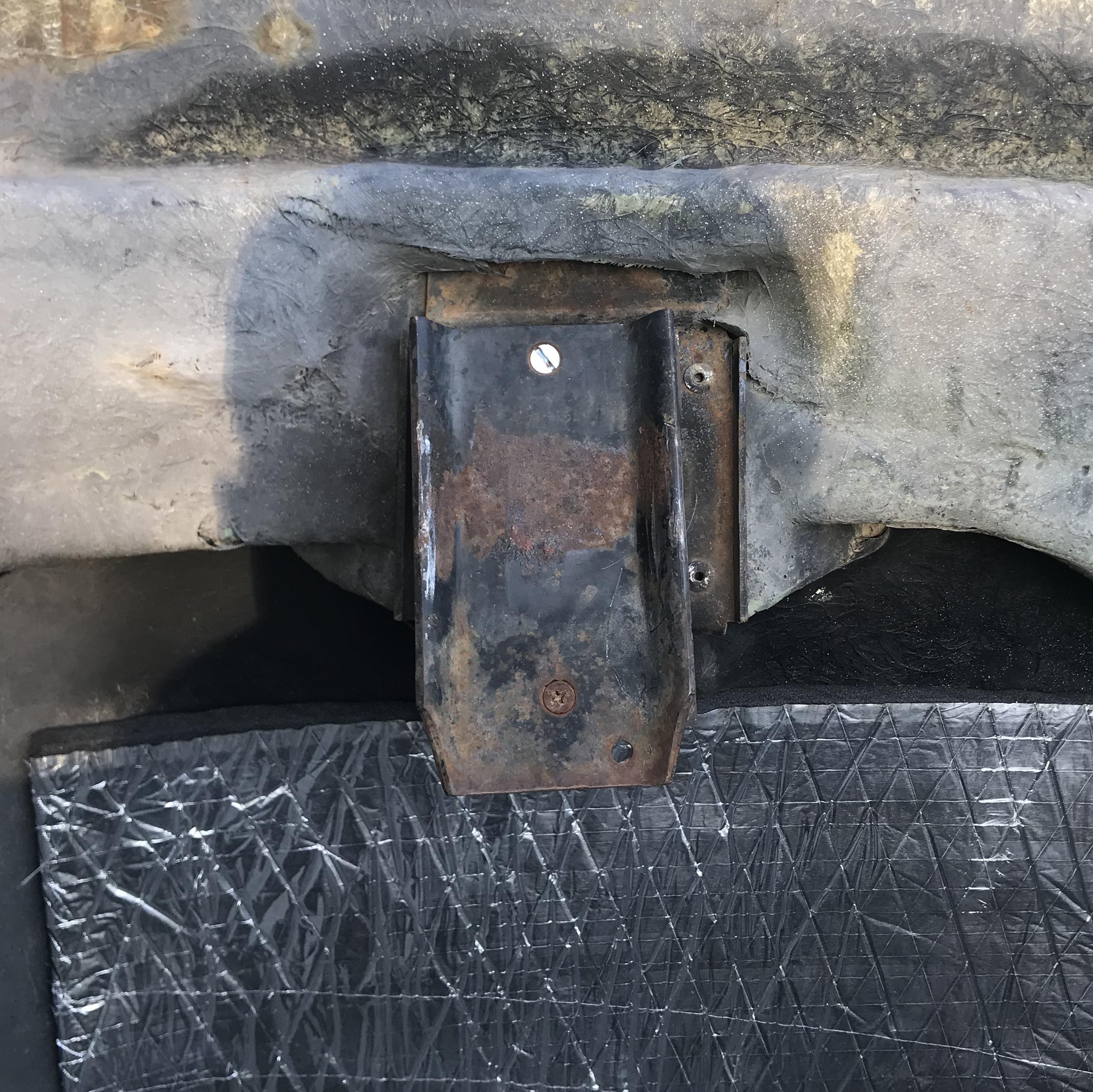

The insulation, I bought off Amazon. After some research. The first layer is a sound deadener. Something like hushmat and dynamat. I put it on every surface I could in the cab. (It’s an adhesive back) Inside the door skins. On the floor and up the firewall as far as possible. Even the bottom side of the floor pan. Up the back cab wall to the bottom of the window. The entire cab roof. Second layer was a adhesive backed 8mm thick foam. Stuck it right over the sound deadening material. Third layer was thermal insulation foam with a foil back. Then on the floor and up the firewall I layed in the factory floor mat and a layer of mass loaded vinyl for a little extra sound resistance. Put the foil back under side of the hood and outside on the firewall as much as possible.

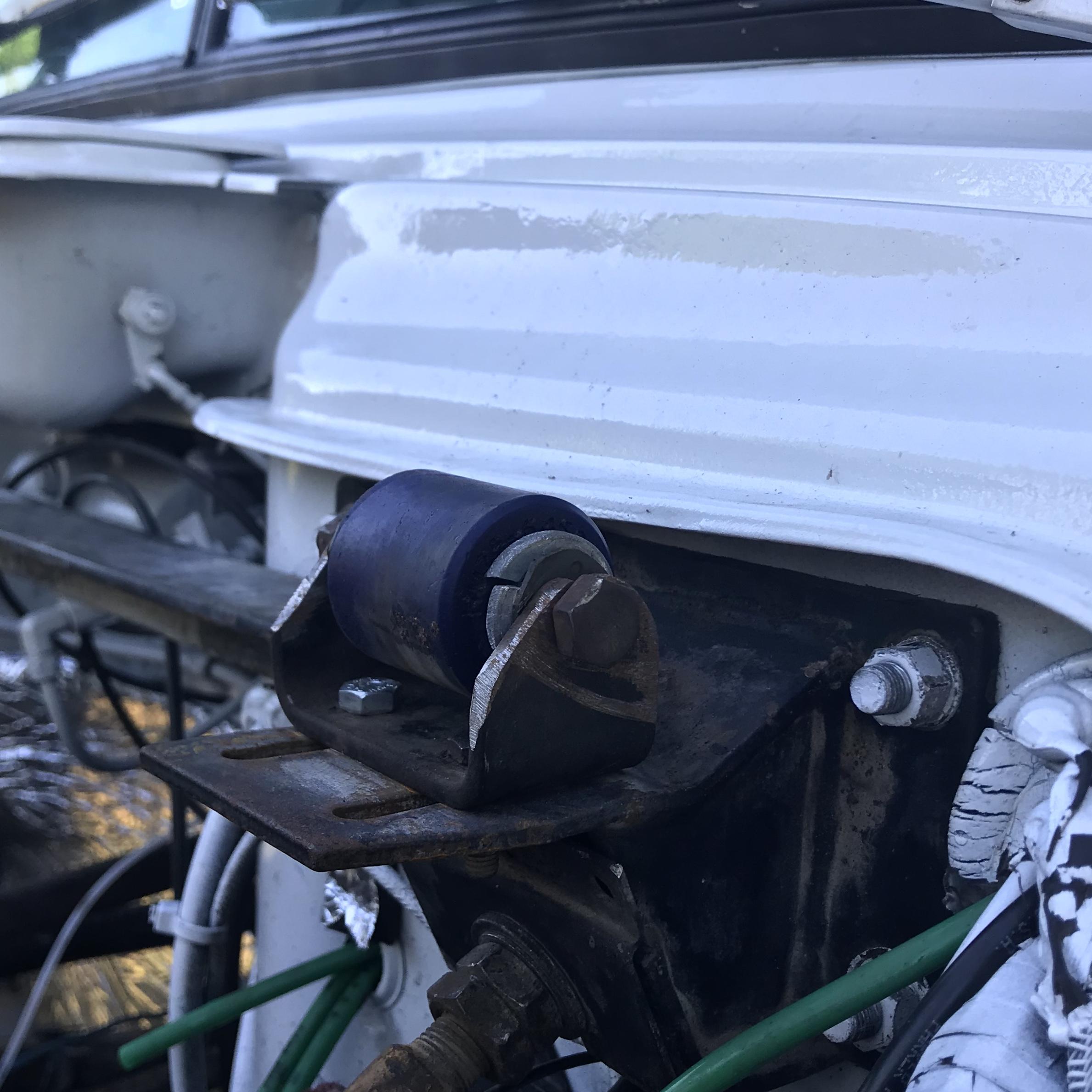

The hood rest set was off a doner  truck. The rollers were gone but I was able to make some peterbilt replacement rollers work on my mounts/rests. The Pete rollers were like 6 bucks each. It took a little trimming and trial and error fitting but it all worked out.

There is a cup or whatever on the top of the column under the wheel that’s held by a single Phillips screw. I should mention that on my particular truck I had to trim or grind or machine about 1/8” off the top of that cup before the new steering wheel hub adapter would clear without rubbing a little
