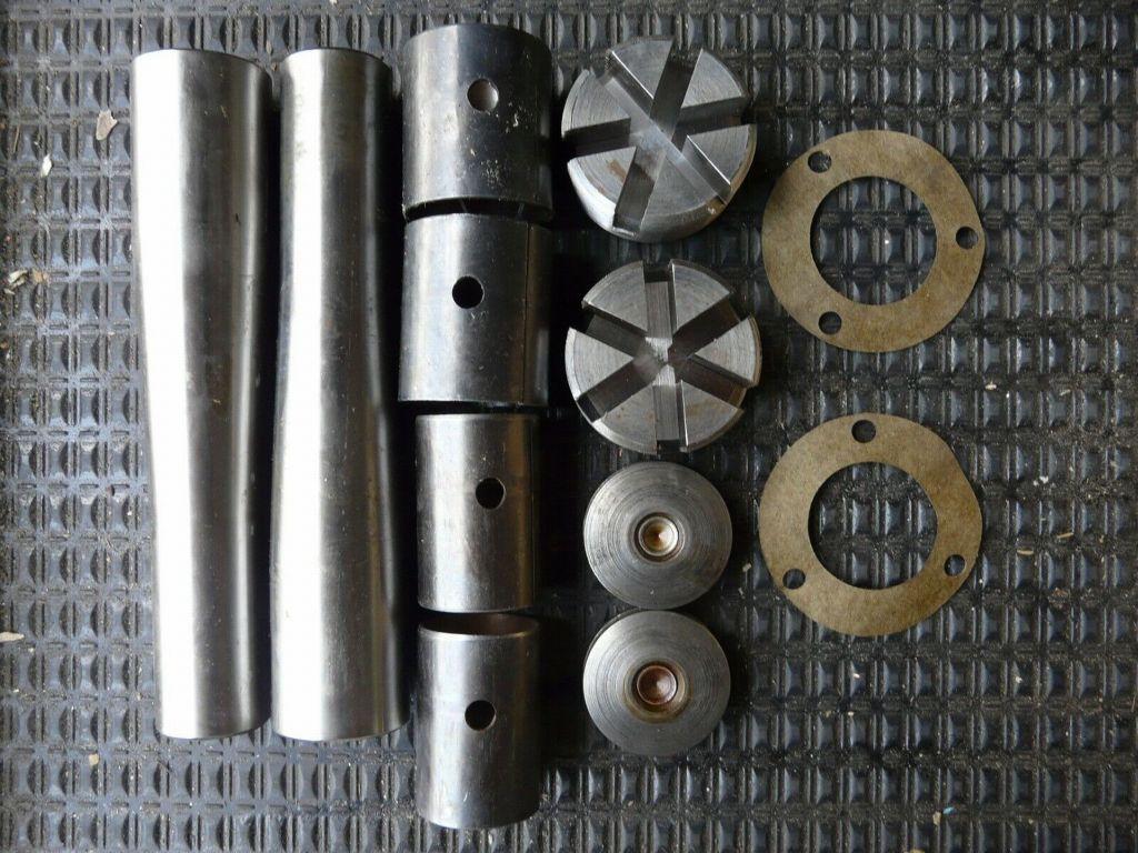

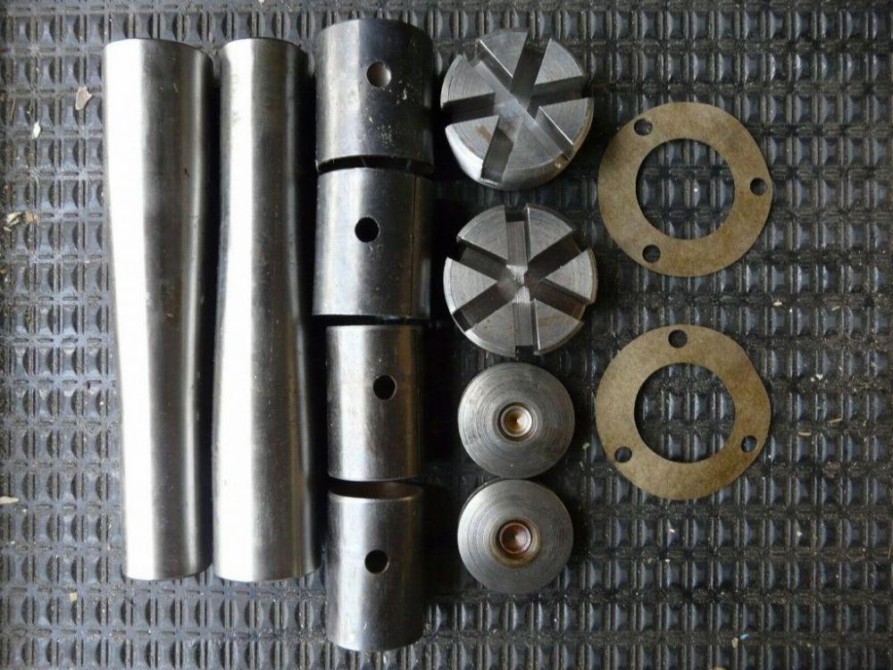

This guy says these fit the FA511 axle, but he lists the Mack cross reference as 301SQA32C. Other places I have seen the Mack number for the 511 axle as 301SQ45A, so I don't know if this kit will work.
https://www.ebay.com/itm/NOS-MOOG-Mack-truck-king-pin-bolt-kit-FA45-FA401-FA501-FA511-FA400-FA500/273760818853?hash=item3fbd6a96a5:g:GagAAOSwhUpcioHU
https://www.bigmacktrucks.com/topic/56162-king-pin-set/
I'm not aware of an FA-511 axle ever using full bushing type king pins. They were needle bearings at the top as I remember.
https://www.bigmacktrucks.com/topic/56162-king-pin-set/#findComment-418237
AXLE – FRONT 10 KING PIN SETS – MACK PART NO. APPLICATION     301SQ32B FA511 (Prior to 1963)    301SQ45A FA511 (1963 & up)
full listing page 10.
Believe his set is for the 400 series axles
