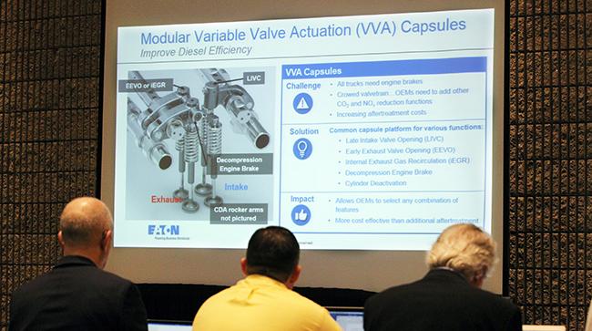

Eaton is addressing engine air management with modular variable valve actuation to allow better control of combustion and better regulation of emissions.

Its hydraulic lash adjuster is intended to ensure precise valve seating and optimize engine air flow and fuel management, Dorobantu said.
