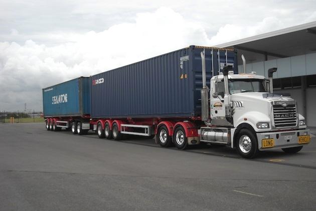

Finally, in 2010 a combination emerged with the potential to make the quantum shift required to give PBS some credibility, providing the sort of productivity boost for which the industry had been crying out.
Ironically, the A-double is probably the simplest of all the combinations, comprising two semi-trailers linked by a tandem-axle (there are A-double combinations with tri-axle dolly) converter dolly. But herein lies one of its greatest strengths – versatility – because it can be easily separated into two standard semi-trailers.

“We came up with the A-double concept because it gives us a significant step up in mass – up to 85 tonnes gross combination mass (GCM) – a significant step up in trailer length and in so doing we significantly improve emissions and congestion with a safer vehicle.”
Fast forward to the present and according to Mark Johnston, the success of the A-double between Toowoomba and the Port of Brisbane has been phenomenal and there are now more than 150 of these super-efficient combinations plying this route. He estimates that this equates to around 200 less trucks used for this purpose compared to before the A-double was introduced. However, he maintains the ongoing stumbling block to wider use of higher productivity PBS-approved combinations like A-doubles is the approval process.

Prime Mover also spoke with Les Bruzsa the Chief Engineer of the National Heavy Vehicle Regulator (NHVR), who reiterated that the original purpose for developing the A-double centred around carrying containers from Toowoomba to the Port of Brisbane.
He explains that the original A-doubles have an overall length of 30 metres and are able to carry two 40-foot containers and up to four 20-foot containers, depending on how much each weighs, providing 100 per cent productivity benefits for specific freight tasks like containers
For example, two 20-foot containers of grain weighing up to 30-32 tonnes each can be carried on the centre of the trailers for the inbound journey and four empties carried on the return trip, which is not possible on conventional combinations like B-double or prime mover semis.

For example, he cites the development of A-double combinations with an overall length up to 34 metres which enables larger axle spacings between the axle groups leading to less strain on older bridges.
“The original 30 metre A-double is still probably the most common but we now have shorter and longer versions including 26 metre and up to 34 metre units which still meet Level 2 PBS requirements.
“We have some A-doubles operating in Victoria at longer than 30 metres because at the 30-metre limit they would have had too large an impact on certain bridges.”
In summing up, Les remarked that A-doubles represent a good option compared to B-doubles due to the extra axle group.
“This means a given load is distributed over more axles and a longer distance which reduces the impact on roads and bridges.”
