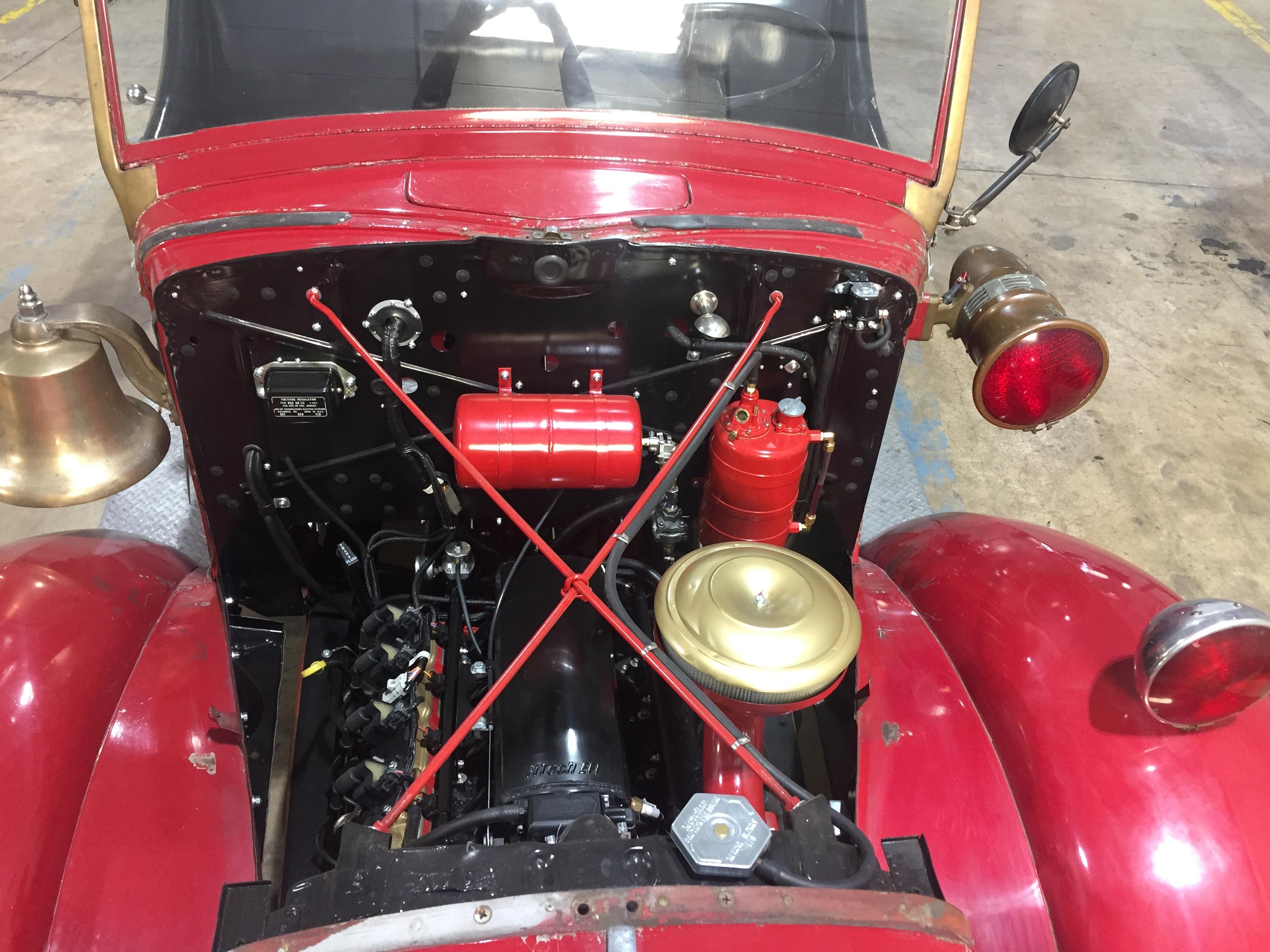

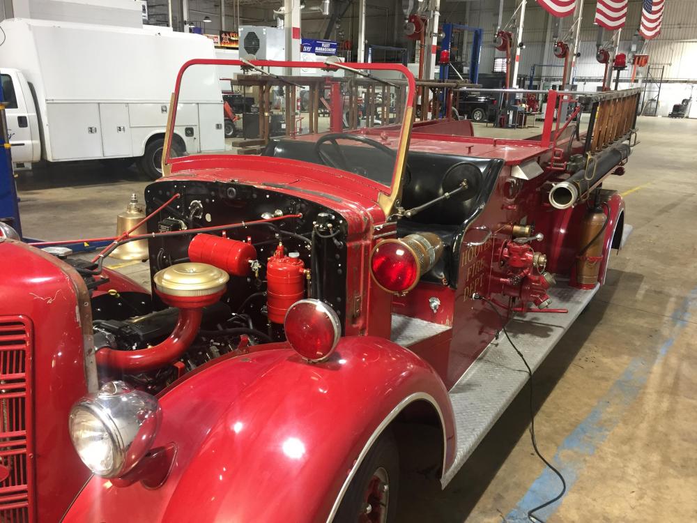

I know some of y’all think it’s sacrilegious to do what I did but I love it. Took her around the block for the first time the other day. Wiring is 100% done and there are only a couple minor things left to take care of. Hope to have her at her first show in about a month.

I was trying to keep it as “period correct” as possible as far as the engine swap went. A lot of the original pieces either got rebuilt and reused, cleaned or repurposed. I tried to stay away from modern conveniences like plastic wire loom, zip ties, aluminum parts and really anything that didn’t fit the time period.
As the British would say, it looks very tidy under the bonnet.

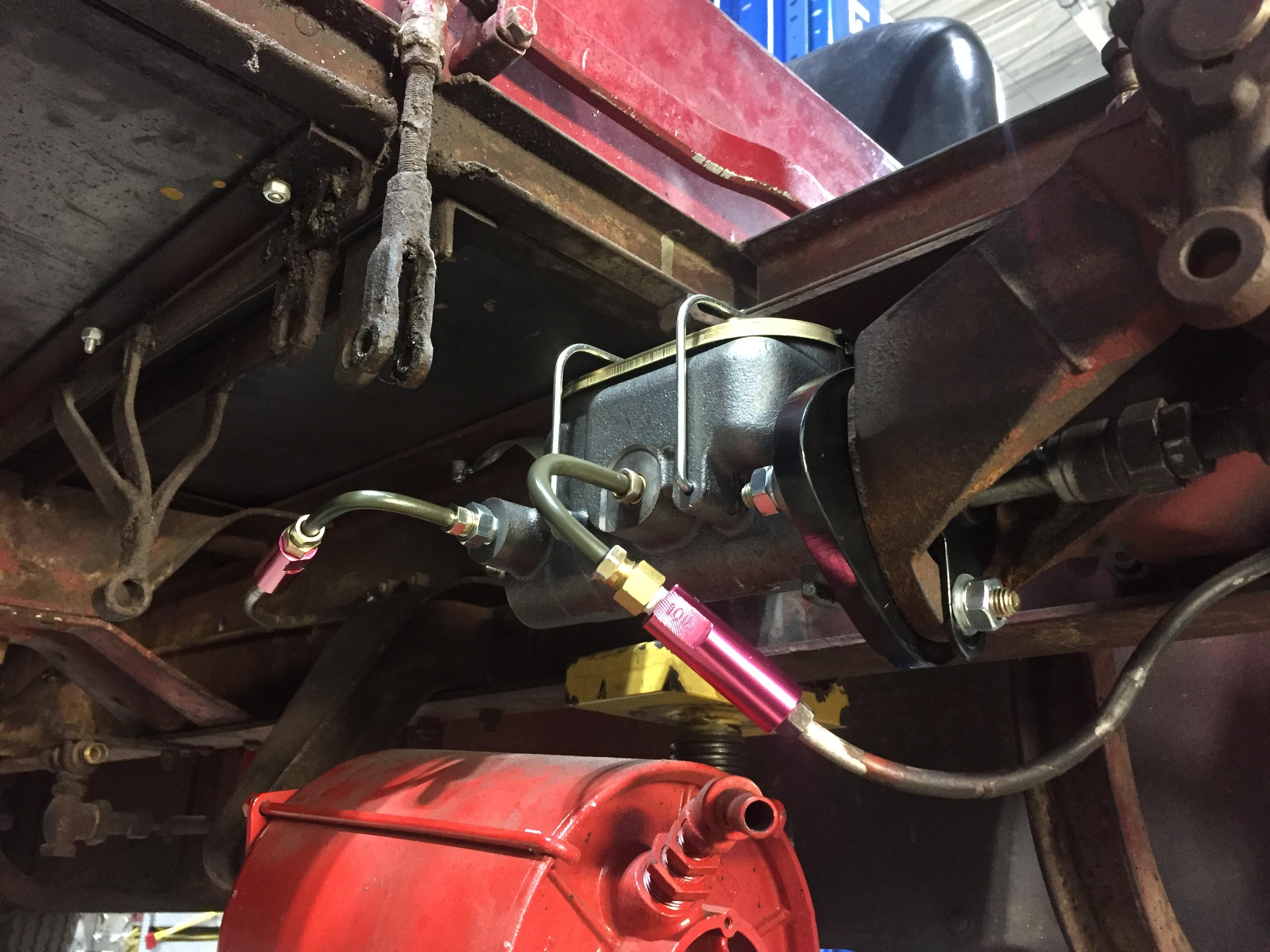

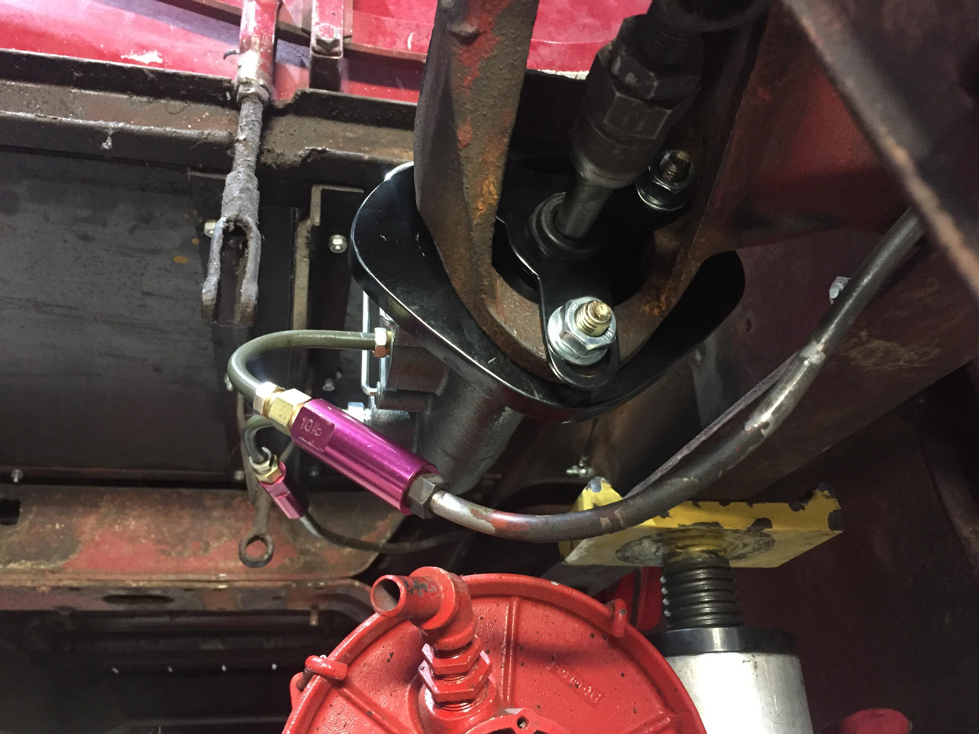

Those are residual check valves(I see they are 10 psi).  Need any time you mount the master cylinder below the level of the brake cylinders.  Keeps from sucking back the wheel cylinders as the fluid tries to run back to the master cylinder.
