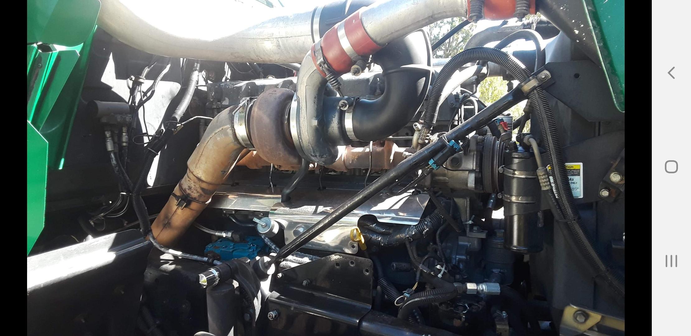

Watch for engine codes.
When the key is first turned on you should see the lightning bolt turn on for a bit then go off. That's the check engine light. If it stays on, with the cruise control switch off hold down the set/decel button a few secobdst until the check engine light starts doing stuff. It'll blink out a 2 digit fault code. Write it down. Hit the set/decel again, it'll blink another fault code if there is one. Keep doing it til it doesn't give any new codes any more.
Some of us here have invested in the books on these trucks and can tell you what the codes mean.
The tiniest dent in the side of that computer is all it takes to destroy it, or so I'm told, so be careful with it if you buy the truck. Clean looking engine!
Very clean engine!
