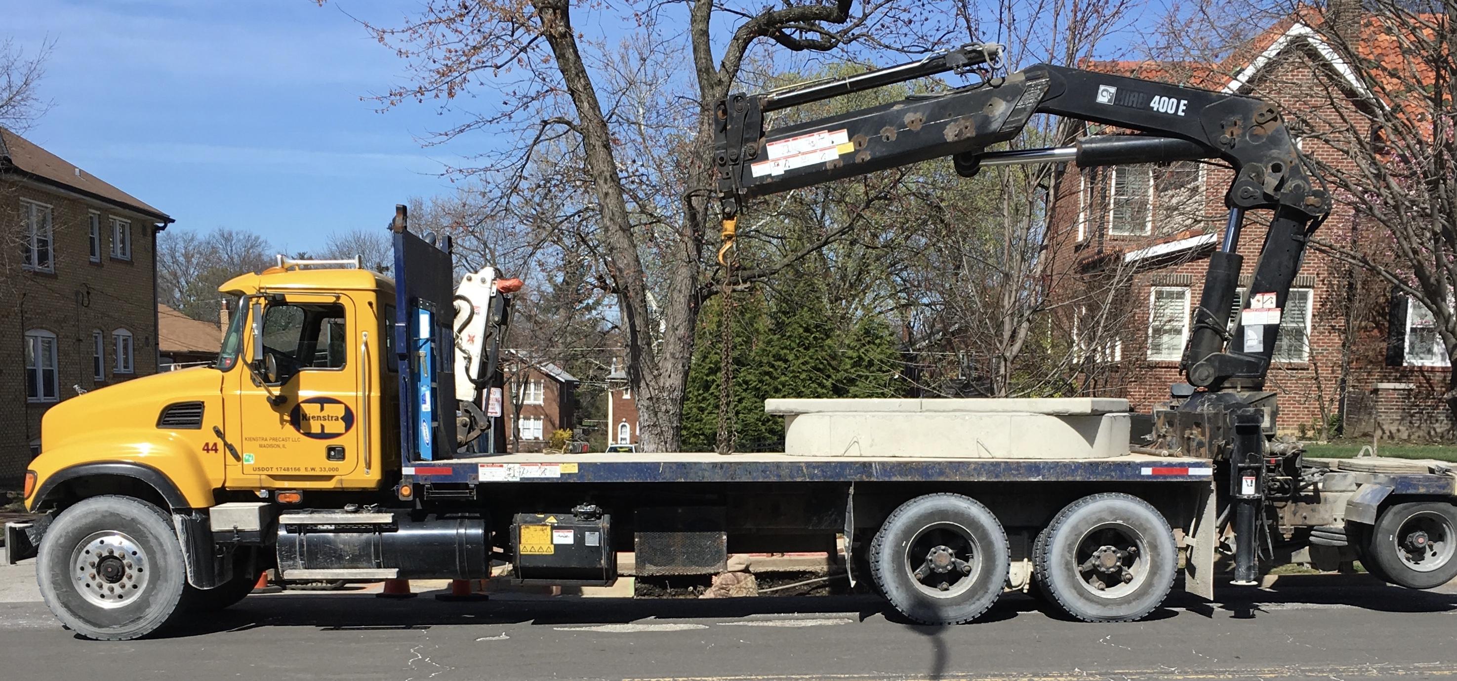

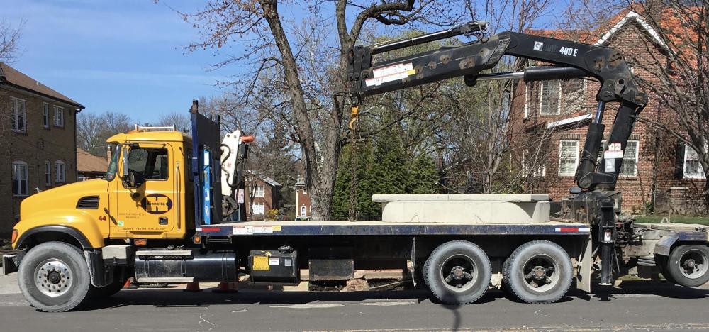

Love the look of granites with spokes, great mix of modern and old. Realize they are not the most practical wheel but they remind me of my childhood. The only granite I have seen in St. Louis with spokes is below. Would love to see pictures of other granites rocking spokes.

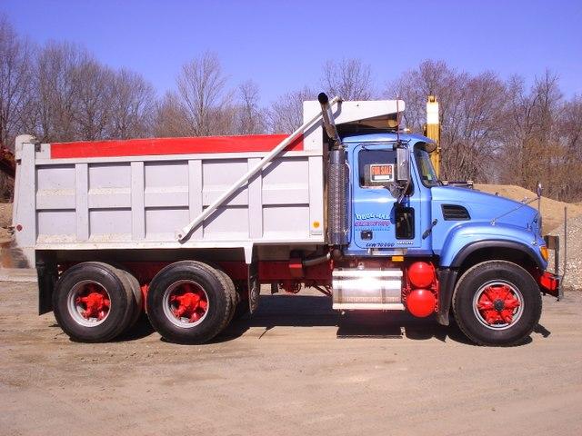

I always like spokes on the drives. Budd on the steer. Lot's easier to change due to weight and balance. Steel Budd on the rear were heavy for a wimp, (me). Looks like he's sporting a flat on the rear outer in the photo.
https://www.bigmacktrucks.com/topic/56581-granites-with-spokes/#findComment-419917
I do like those aluminum rims for steer and lift. They look real sharp, recessed in just right with a wide tire I like that style granite, looks more like a work truck than the newer flashy ones.
Take your pick, heavy wheels or heavy hubs. In theory I think I'd rather buds on the rear, because I'm a wimp too. Don't relish the idea of pulling spoke hubs off by myself for a brake job. Only time a bud hub needs to come off is when a wheel seal goes bad.
But we only have spoke hubs trucks. Just the way it's always been. We back into a lot of driveways , so we think bud rims would crack more often than normal. Not sure what everyone else's experiences are.

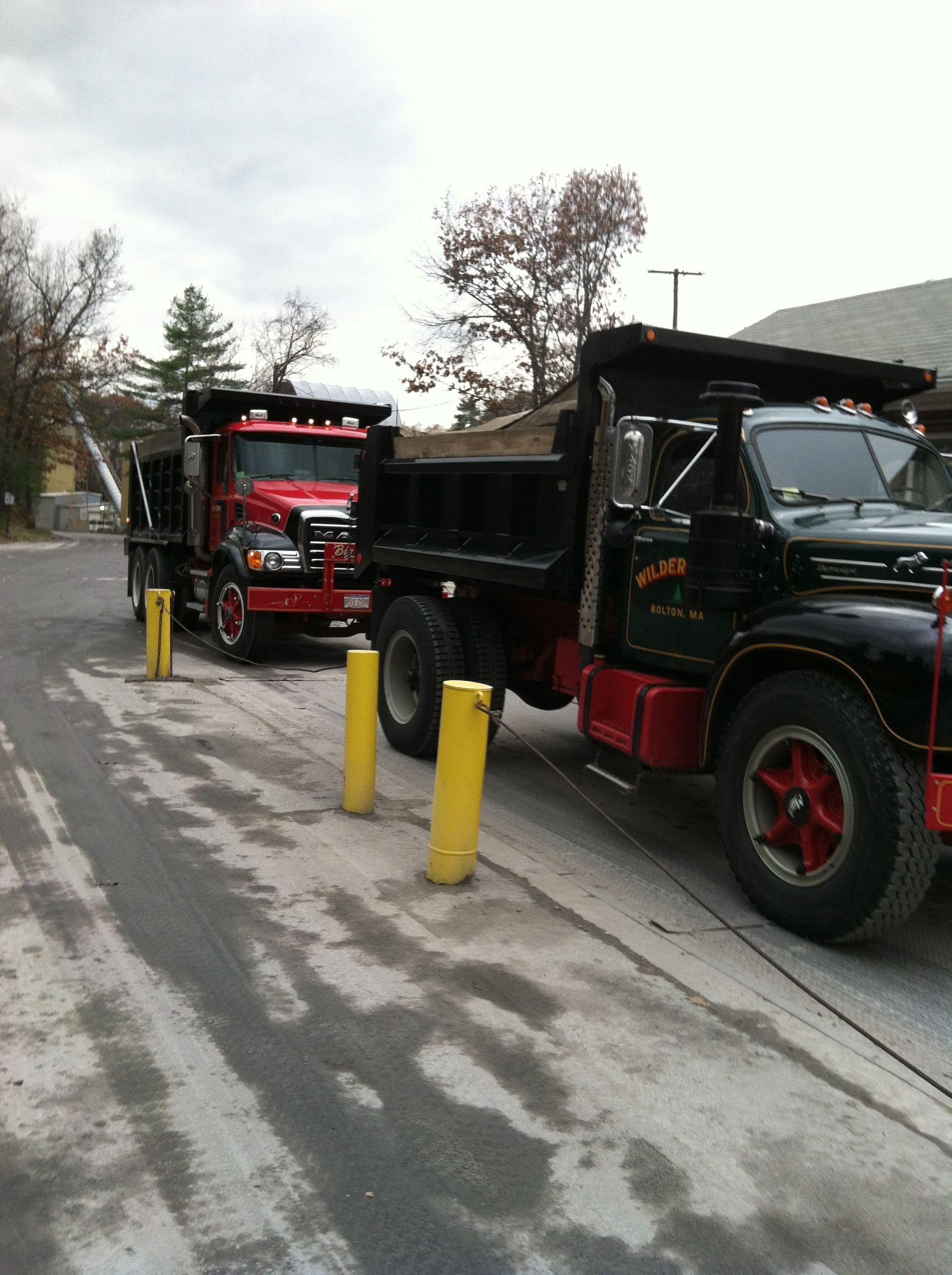

22 hours ago, Red Horse said:
 well not the best picture but  took this a year or two ago.  I call it "60 years of Spokes"  Im on the scale at the quarry and this  Granite has pulled up in back of me.   too bad I could not have had a better shot of it because it is a beautyIMG_1871.thumb.jpg.f24150d1e2f47487e707e05b7dda3eee.jpg
The Granite looks nice but your B is way nicer
