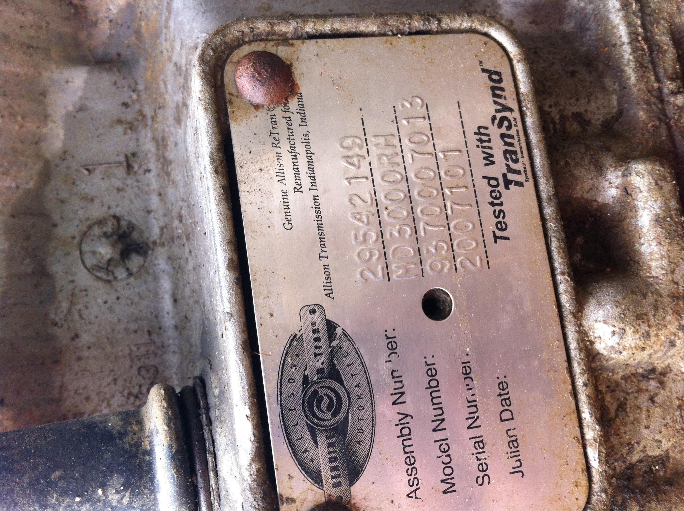

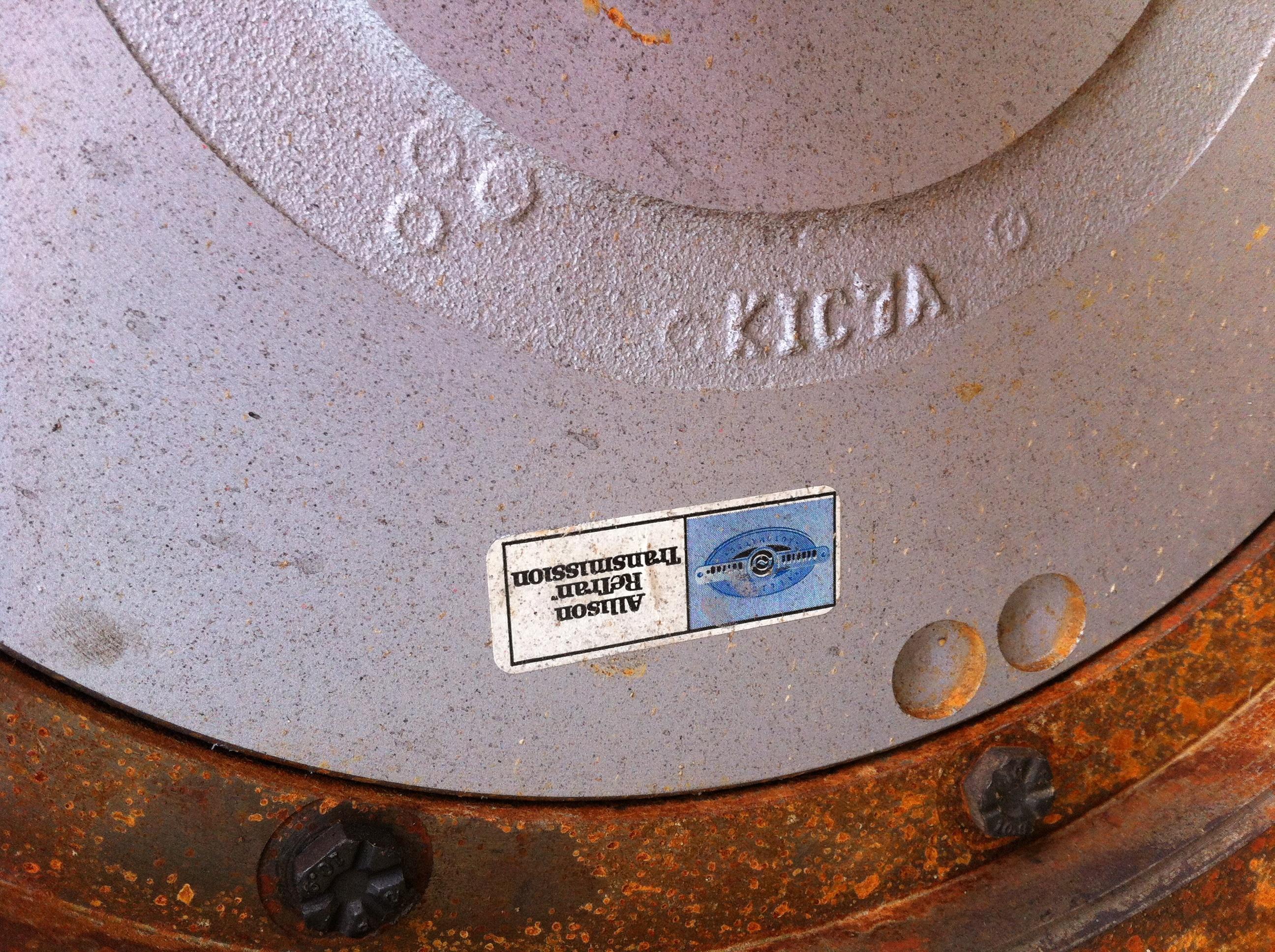

Do you have S/N# off trans and how much $ for trans ? Rich

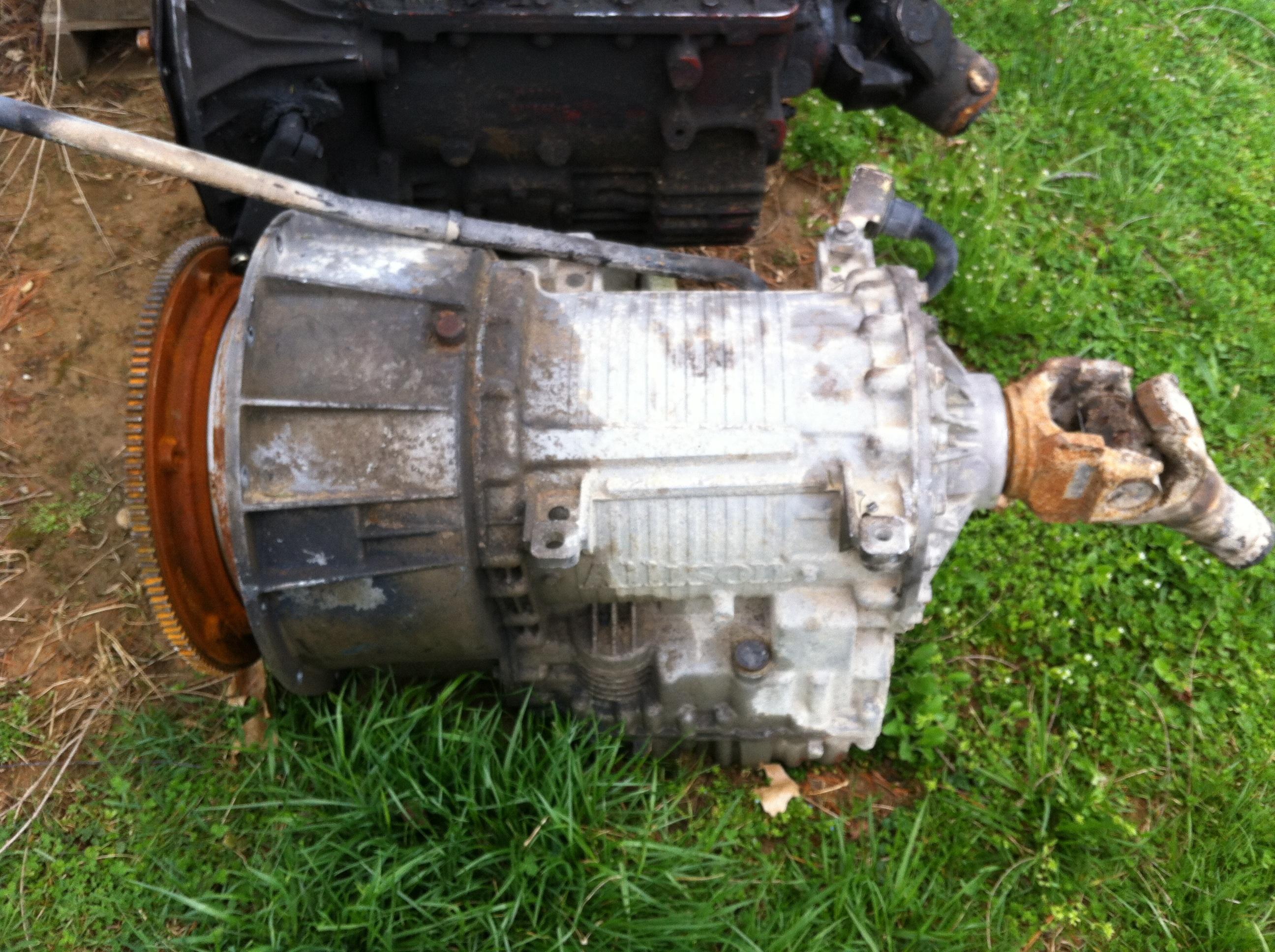

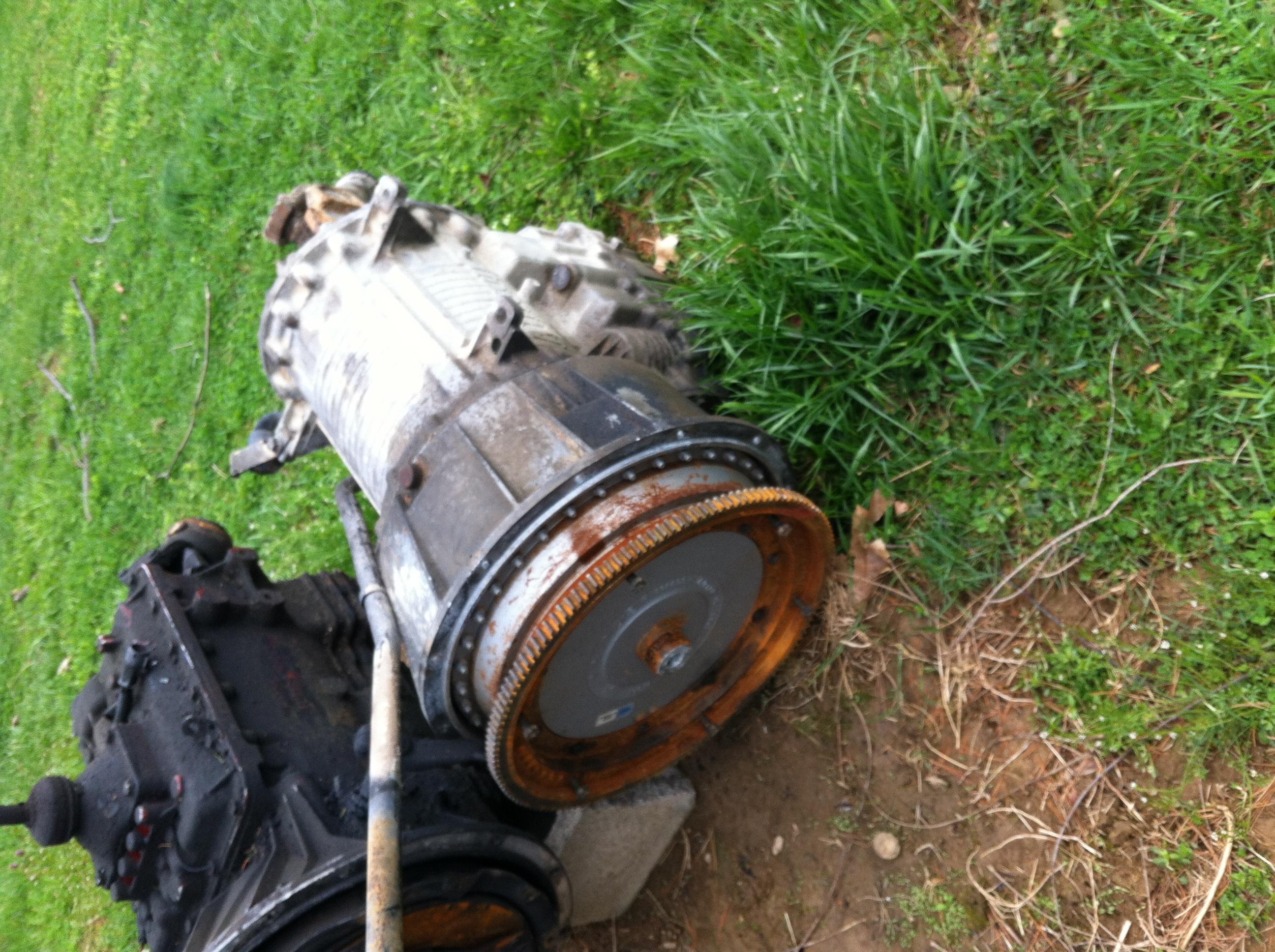

I can get you the info.  There is s tag on the convertor and tranny that say something like Allison reman.    I know absolutely nothing about it’s condition.   It was in a wrecked rear engine school bus behind a 8.3 Cummins.  I didn’t see the bus either.    I’m in central Pa. zip is 17830.    Make me an offer and come get it.

Not exactly sure what it is other then an Eaton.  the tag is missing on that one.   Has a #2 bellhousing, think it’s a 14” single disc clutch, was out of a f800 I think. Had a 5.9 in front of it.    Was going to use with my 8.3 until I found the rto6613
