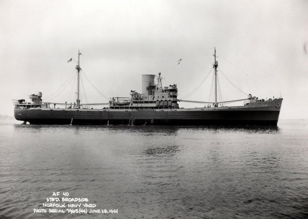

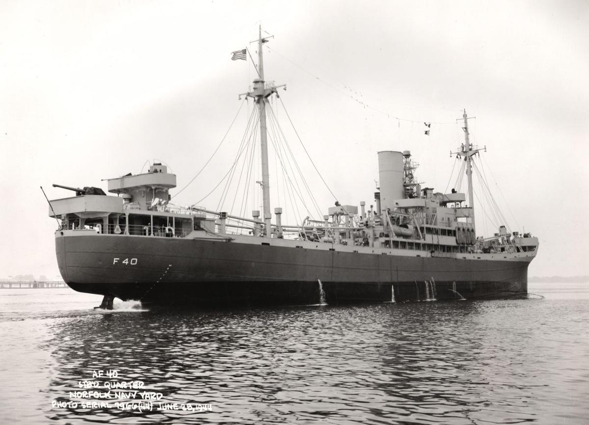

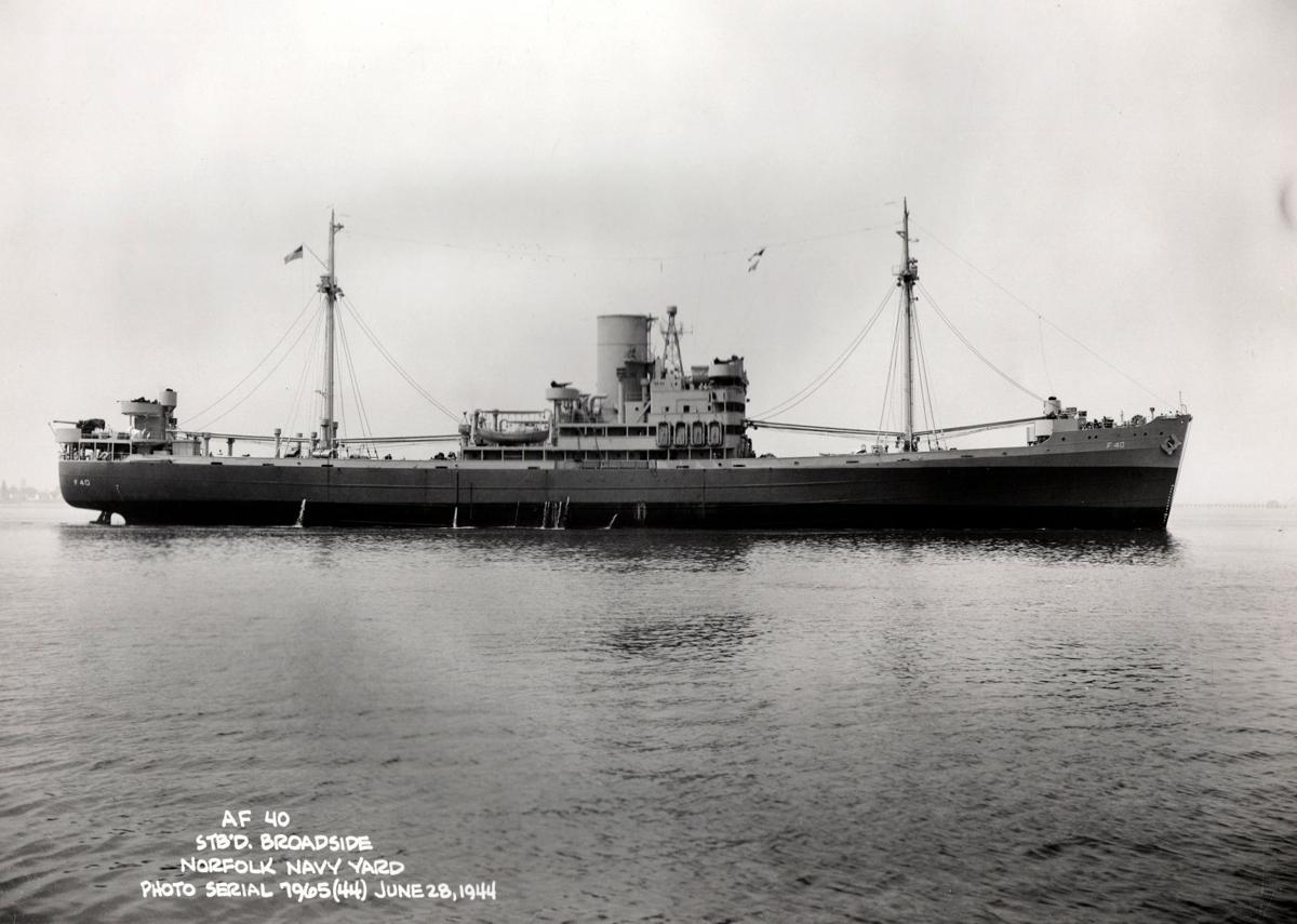

The Saturn, a 423-foot cargo vessel, was built in Germany in 1939. It had barely entered service under the name Arauca by the outbreak of war in Poland. In December of that year, the ship was forced into Port Everglades, Fla., after a British light cruiser fired a shot over its bow. When the U.S. entered the war, the ship was seized, renamed and pressed into service carrying cargo for the Navy.
When the Saturn reached the Navy Yard on April 12, 1944, workers expected to convert it into a refrigeration ship in 60 days. More such ships were needed and officials wanted to speed the work. For that to happen, welders, burners, joiners, shipfitters and laborers all were authorized to work at the same time.
