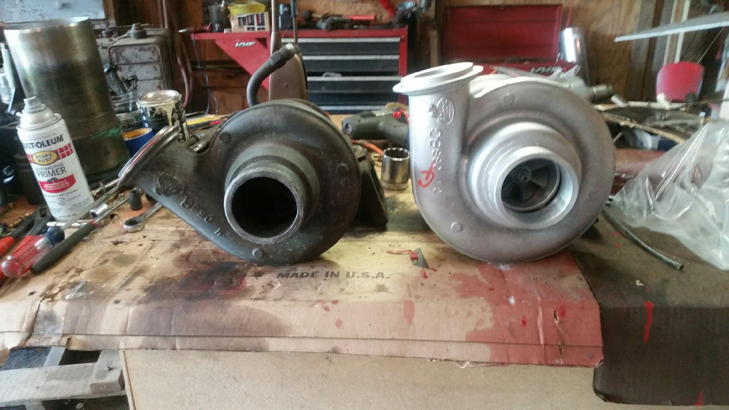

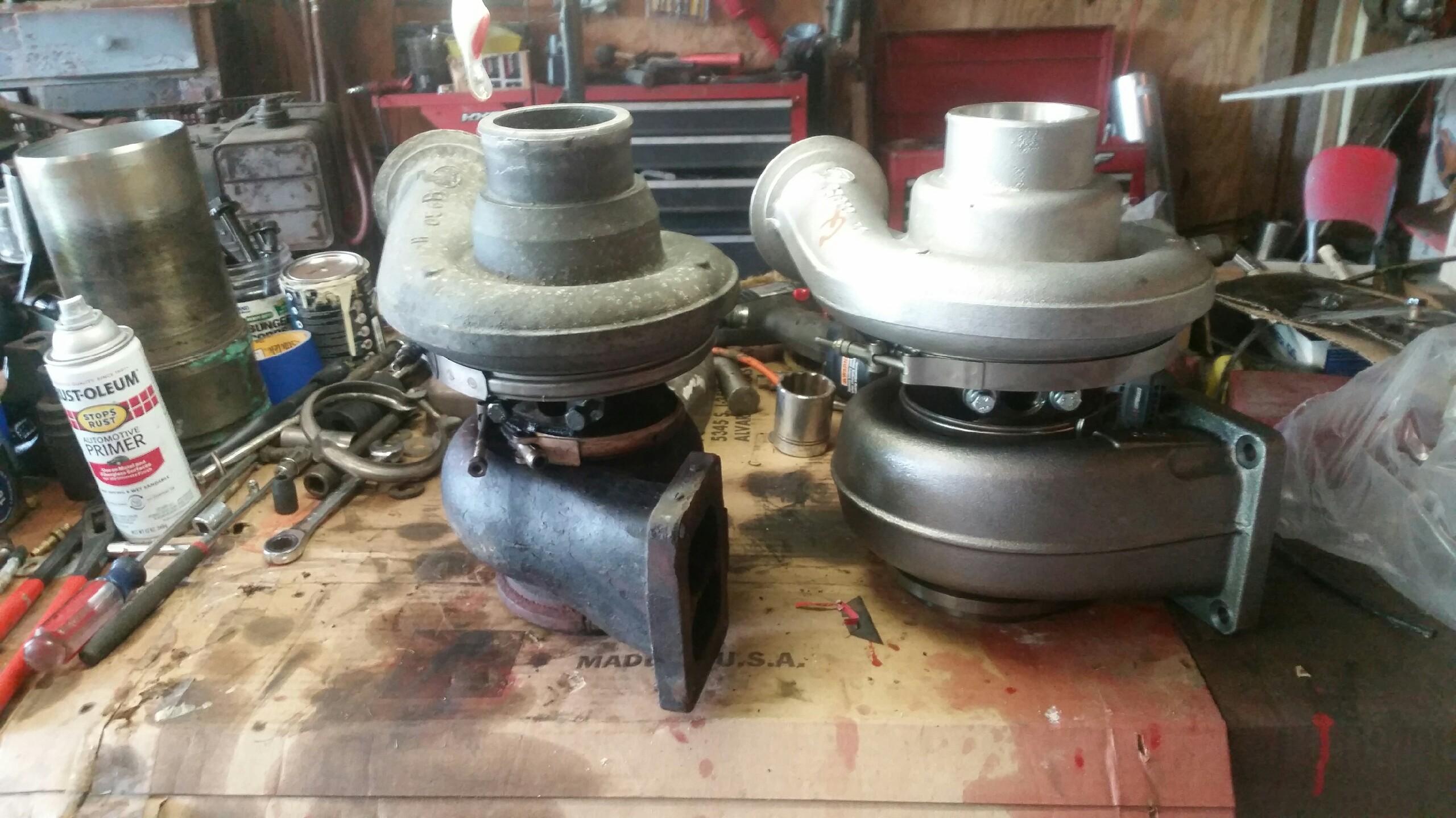

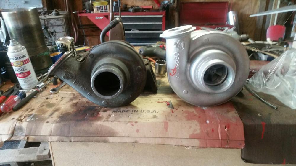

Anyone have the part #? Is it a 171701? This past summer we found a bw 171702 (s475 1.32ar) for 900$ for the 93 and can't seem to locate another one for the 99.

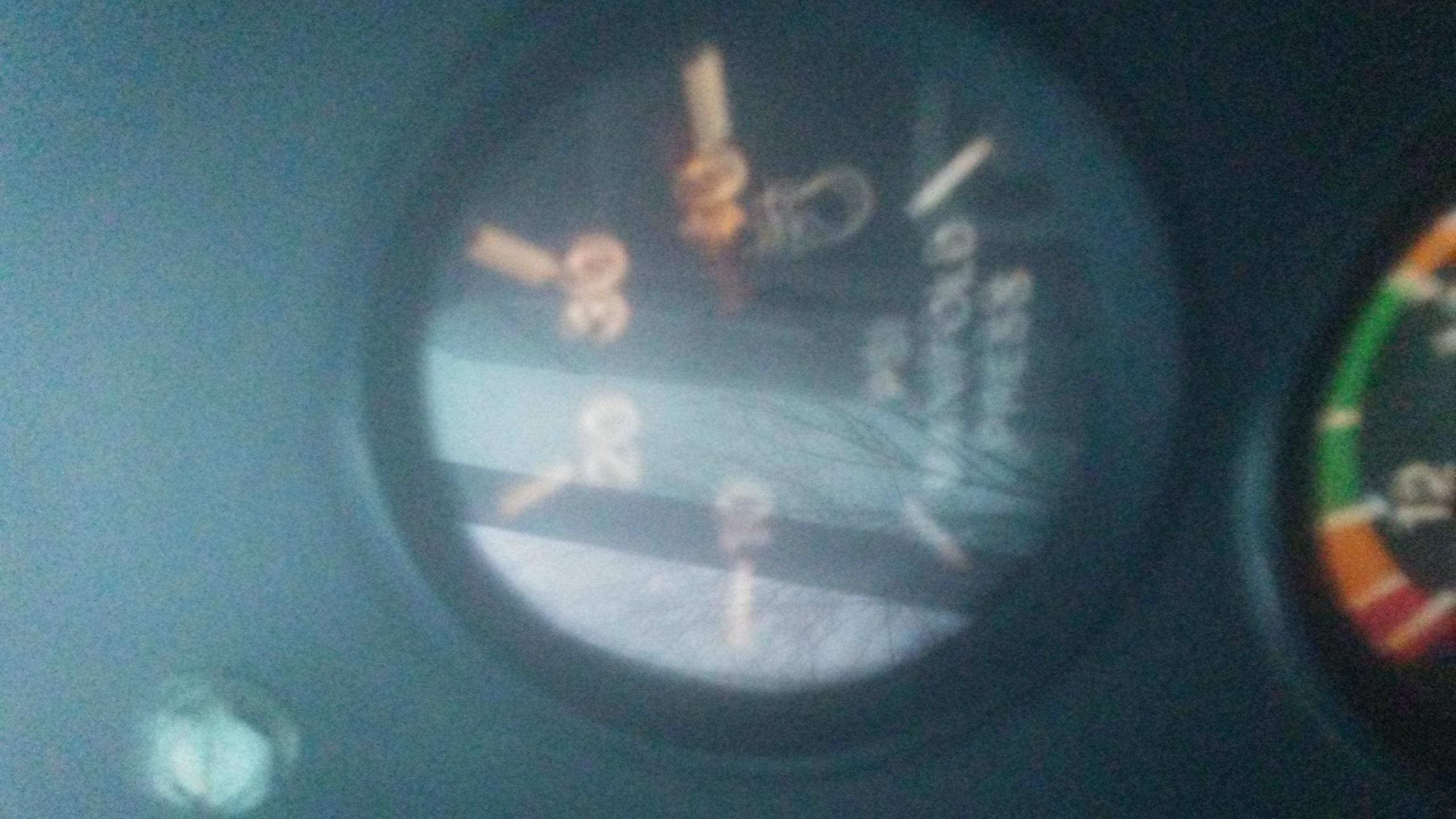

Does rochester use 1.32ar? Trying to get info is like pulling teeth sometimes. Here's the stock s300 that came on the 350 next to the s475. A bit laggy but it sees around 38 by 1400
Just did a quick check on the BW 171702. It is available new $759. Just get it from a turbo shop, it will not be Mack but you can tune it. It comes with a 1.32 A/R turbine housing just as the one you have. If yours is a bit laggy go down to the 1.15 A/R housing and it will pull better than your 93. Boost will come on at 200-300 lower RPM's and it may make more boost than your current BW475 so be carful. Total with 1.15 housing should be around $1000. Have fun!!
Ok thanks that's what I was wondering. I didn't know if it was a mack specific exhaust housing or not. For the work we do the 1.32 is good all around. Sees 32 by 1250 and 42 on a real cold day. I haven't talked to anyone running the setup we are yet. Before the summer is over we'd like to have Antrim dyno it

When the boost comes on it hits like a train. Most hills on 81 in pa it will pull it in 8th L @65+mph loaded 70k +. If only it were a cat or 60 series the info would be all over.
