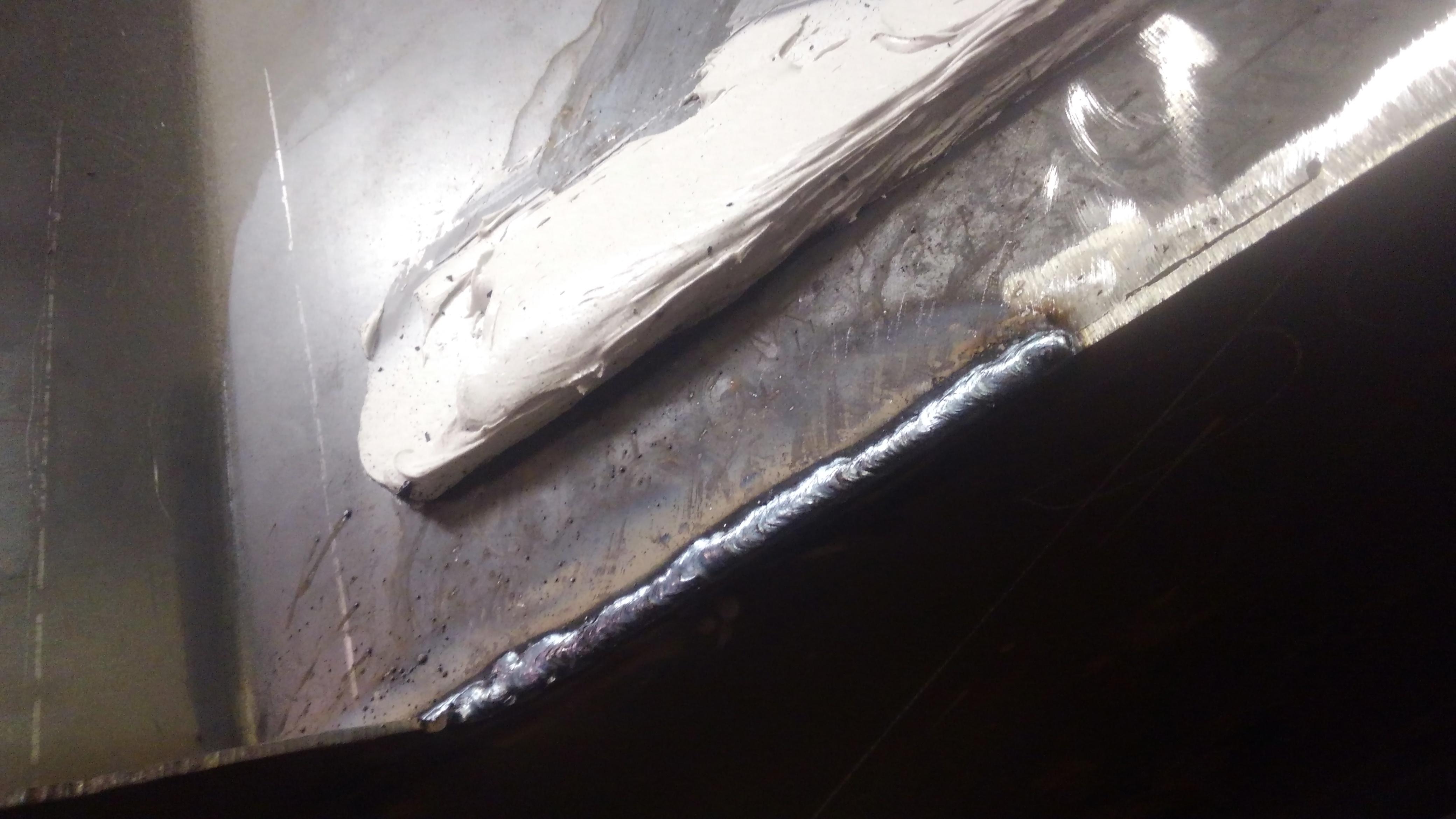

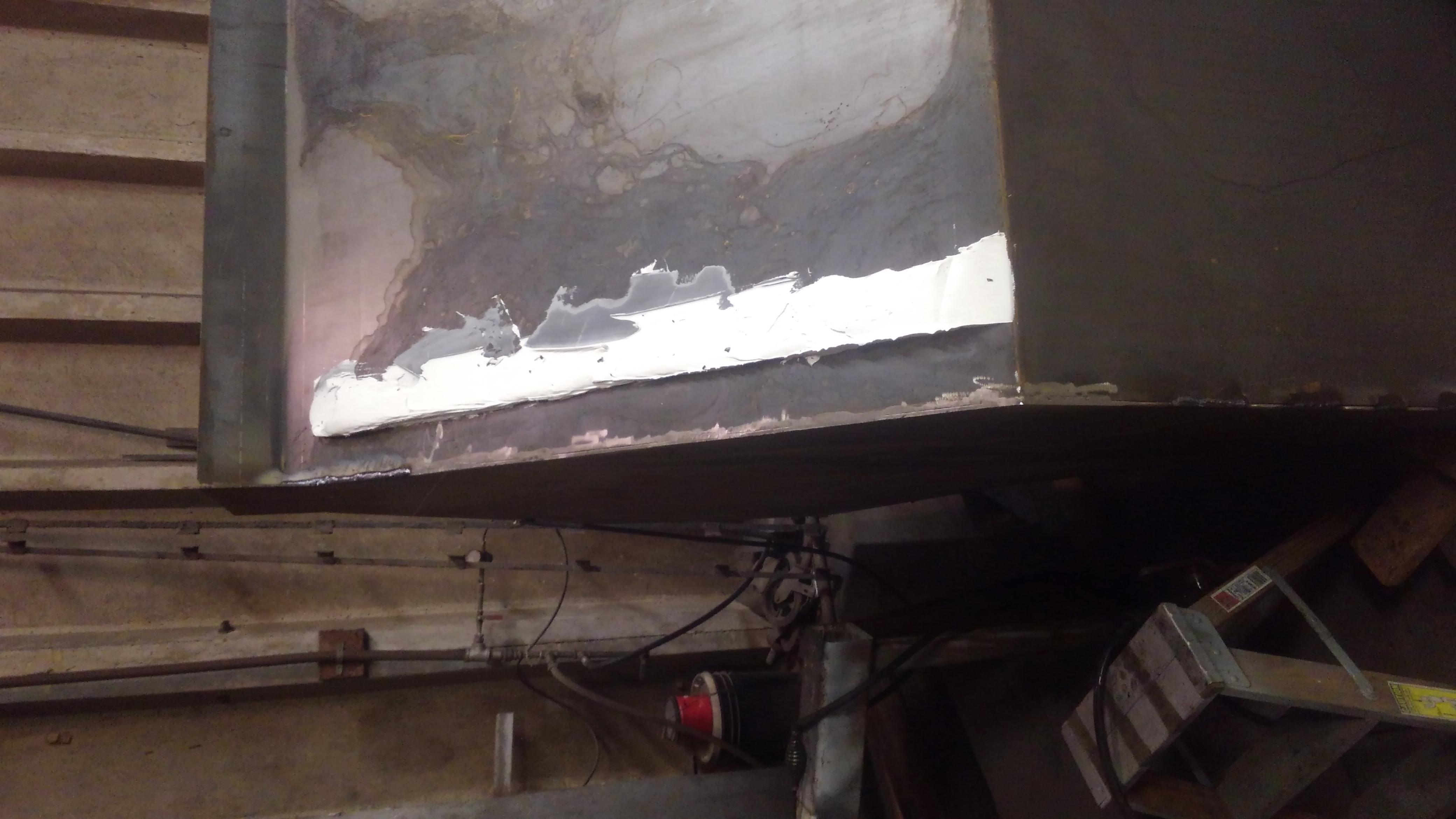

Assembling a Volumetric Concrete Mixer, and thought I'd share a welding trick I learned about and am trying to keep large pieces of sheet metal from warping!
Use drywall compound as a heat sink to keep heat from extending out into the sheet.
Share your welding tips and tricks below.
