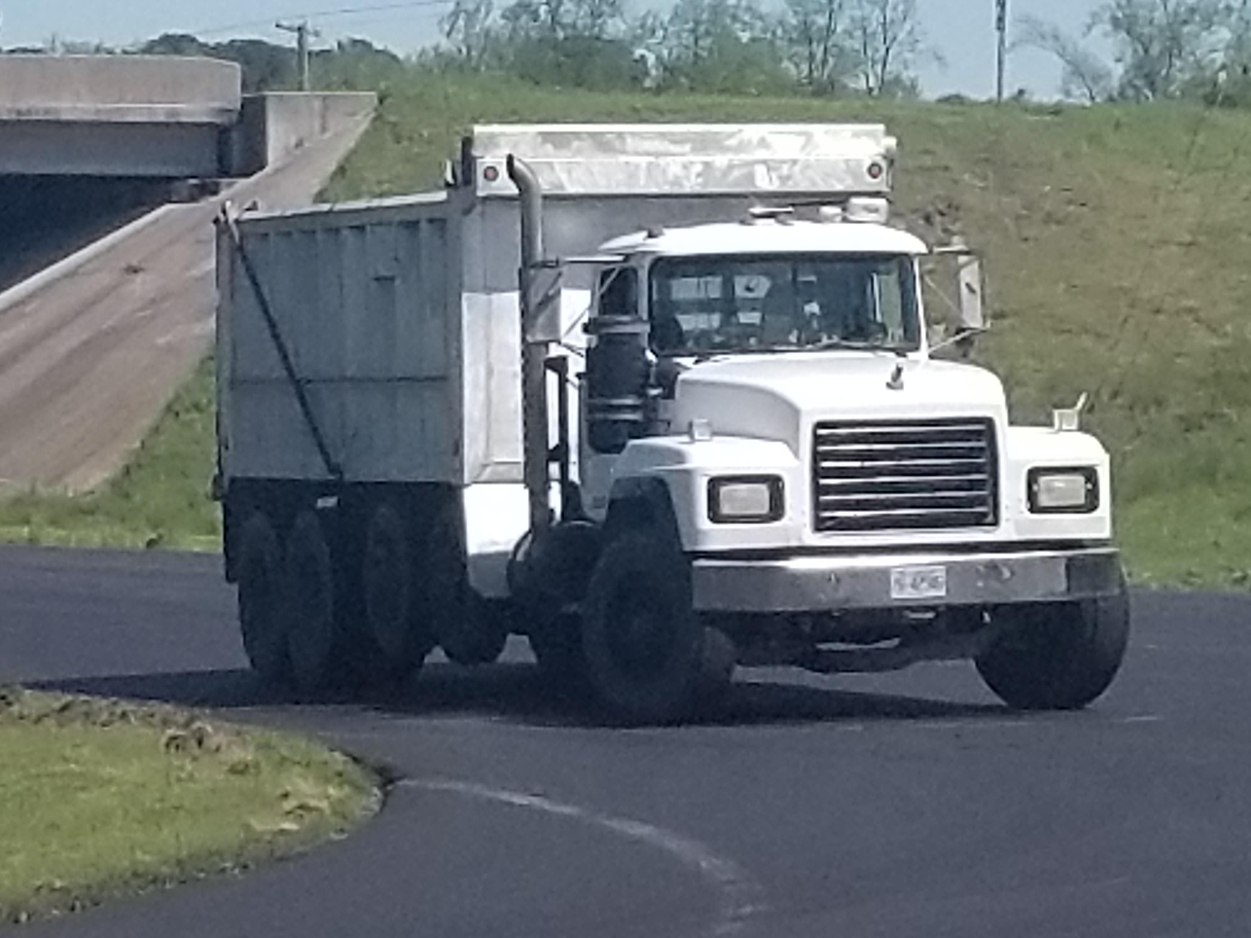

Replace the stat cause it went bad now the truck push water out the little hole in the holding tank. What would cause this truck doesn't run hot just lighting volt come on bout 3 days add water bout 3 days later light on depending on how hard the truck is worked.
Quad axle dump truck
