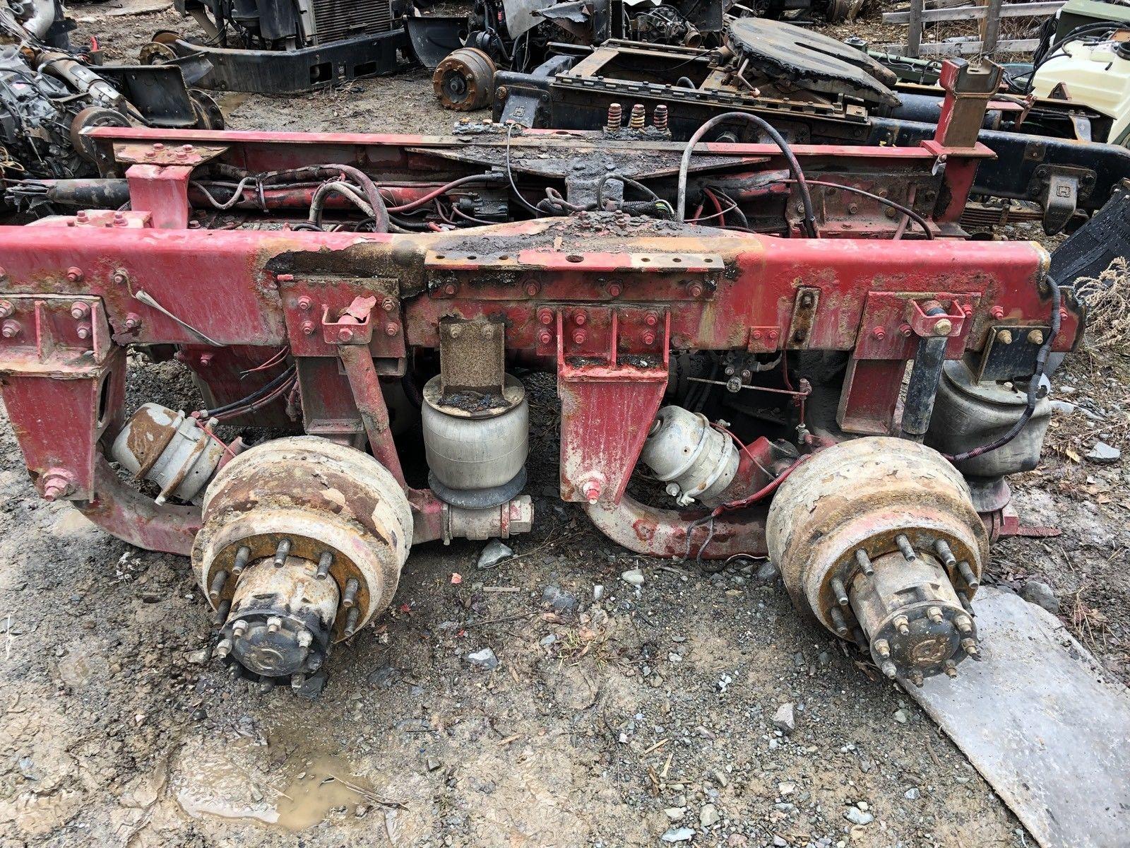

Okay thank you. I need to get down and look at it personally and see what its got but i believe its got the 12 speed mack trans in it. and its a four bag rear suspension set up if that helps at all.
Neway air ride?
Larry
https://www.bigmacktrucks.com/topic/57337-old-superliner/#findComment-423451
  • 0
Looks like a Neway AD-246 suspension which is heavy, and Rockwell Standard axles.
