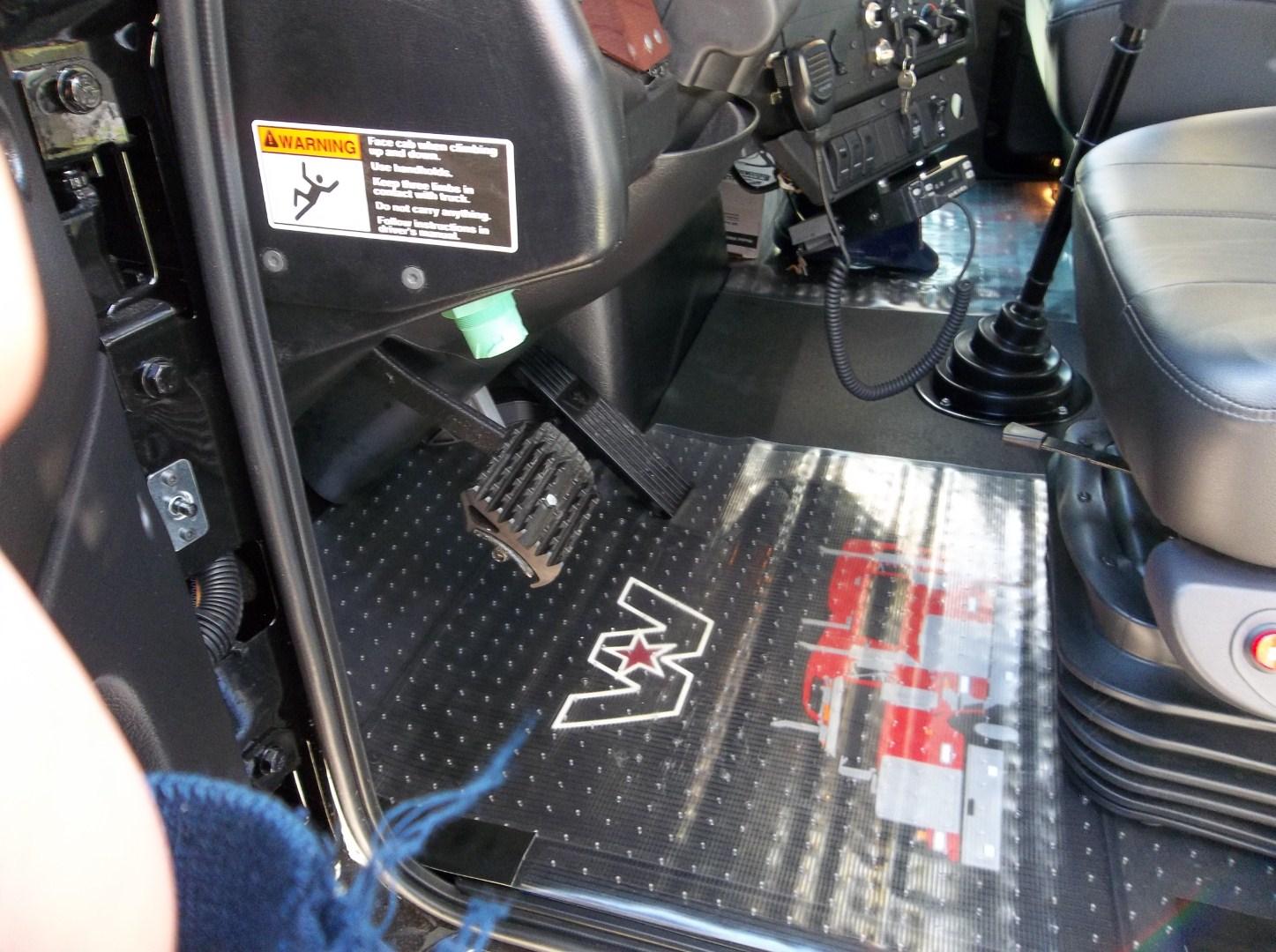

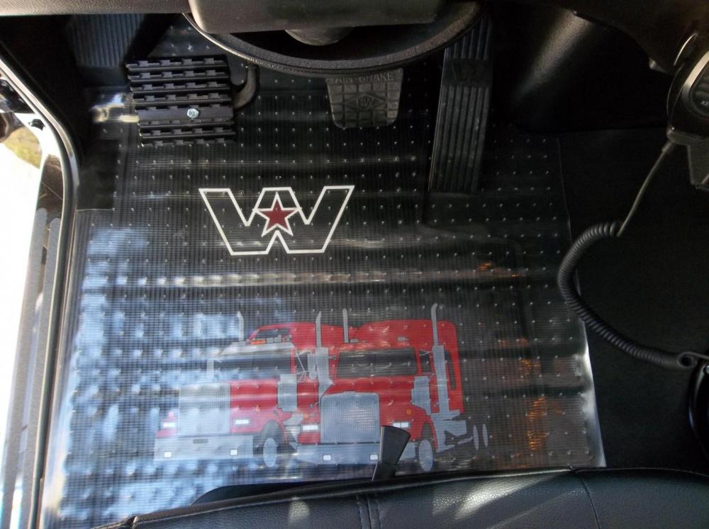

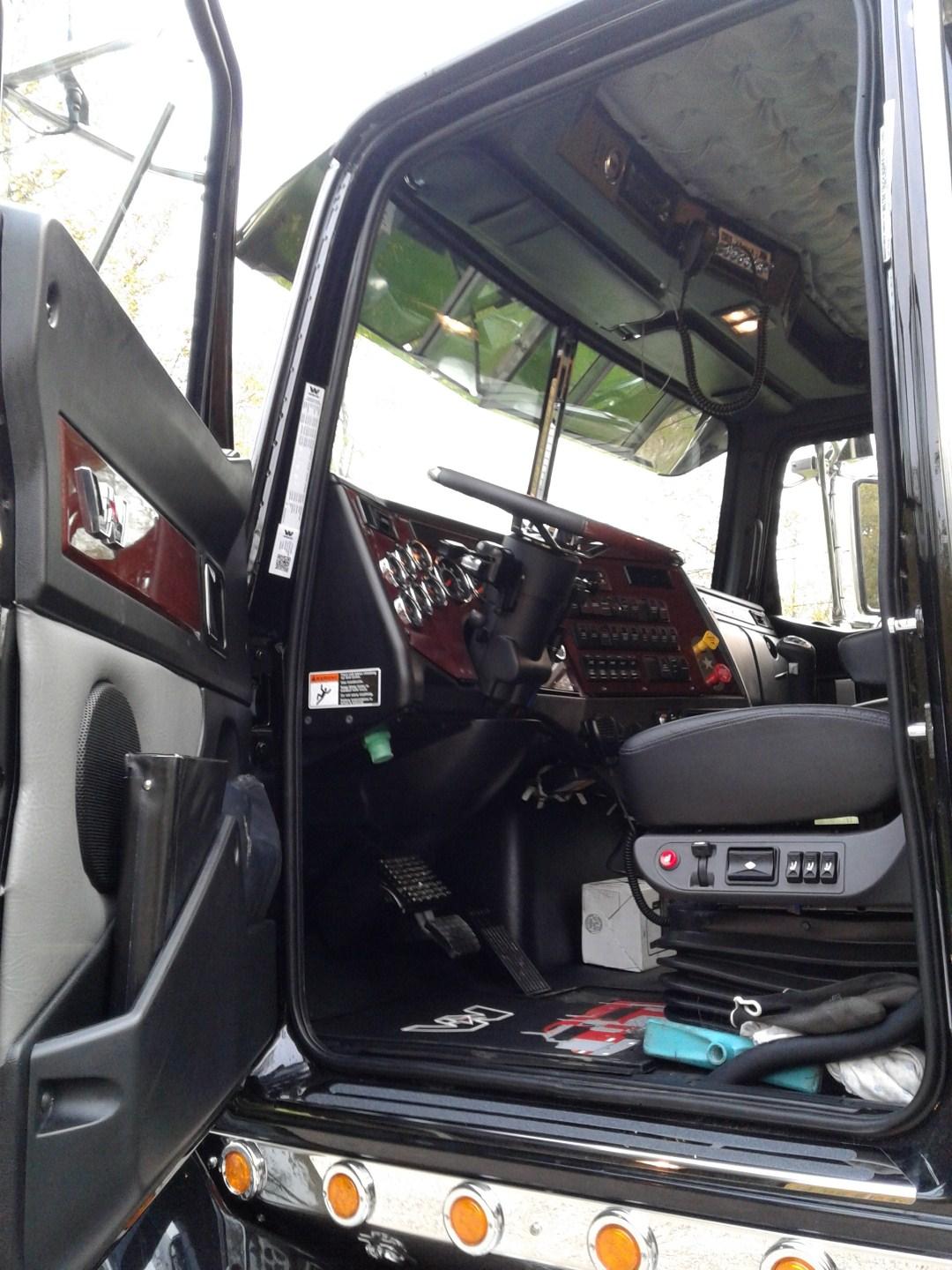

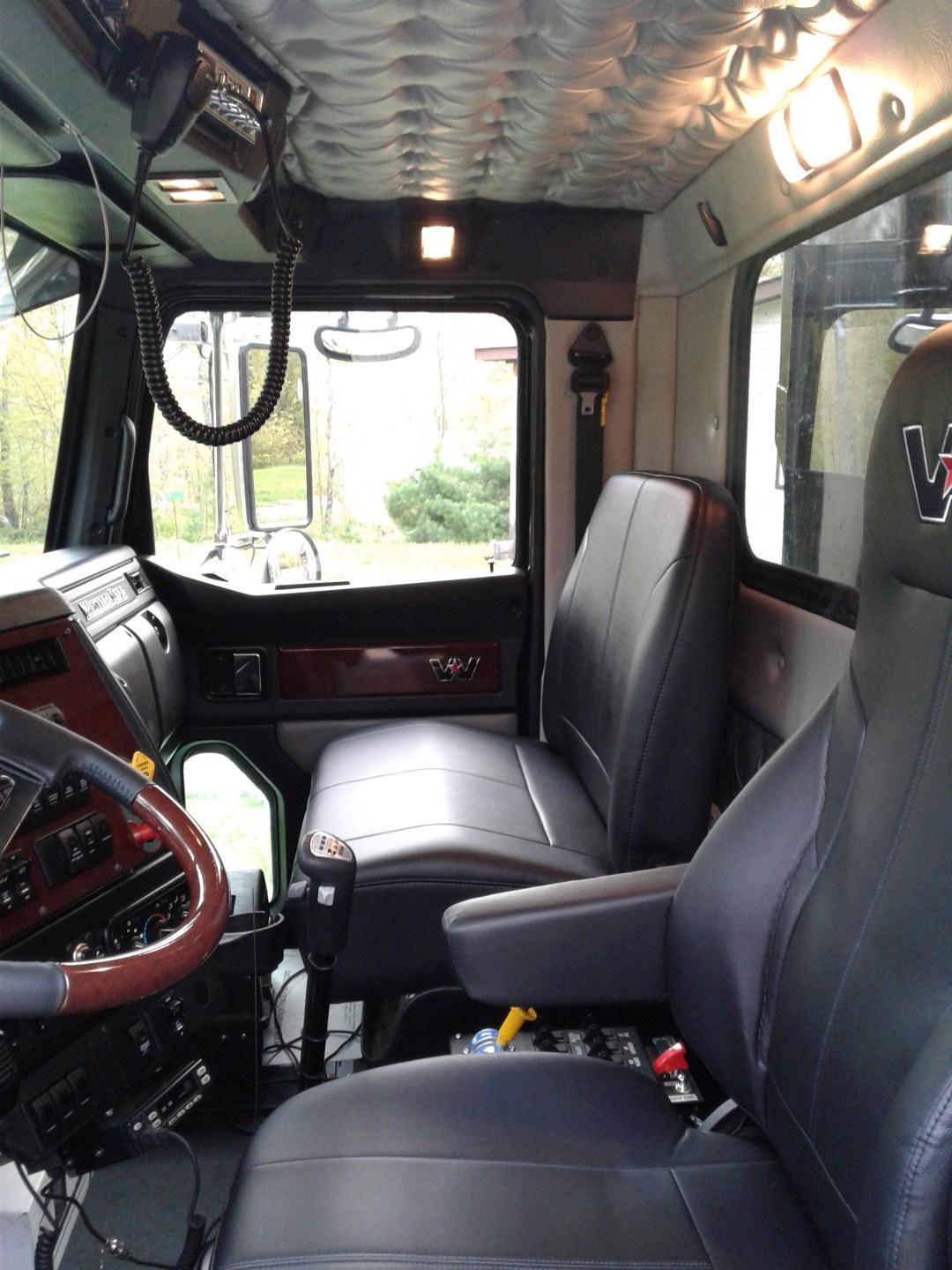

Maybe I'll lose some weight now. While I like the bench seat, I can no longer mount my 12V fridge between the seats like my 2013.
It has to go on passenger side floor, so I can't reach it now. LOL.
Made my floor easier to clean now.

That's why! Wasn't the cab I was looking at, LOL. If it's anything like the jobs I work, that sleeper would come in handy. Thus my bench seat. LOL.

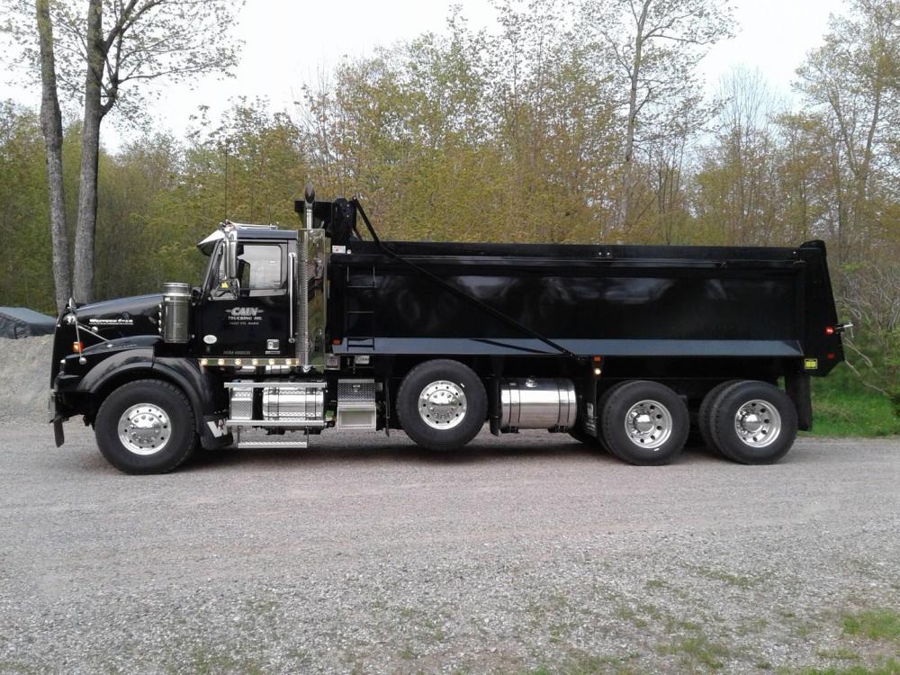

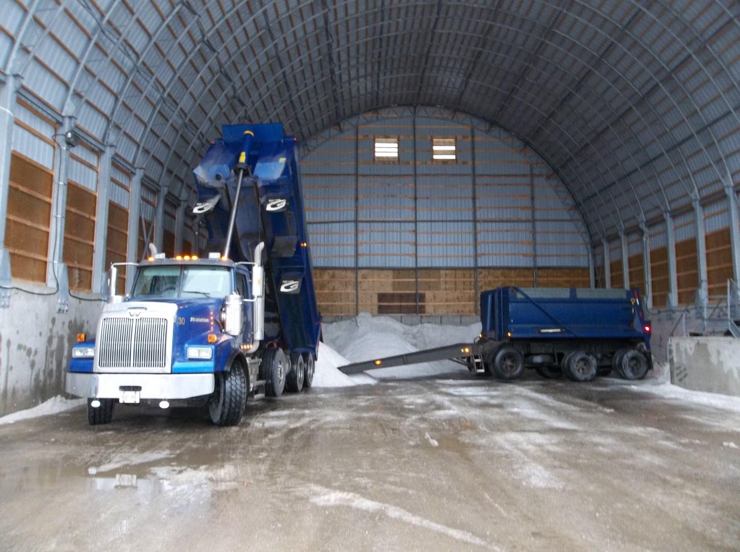

Well first day of work today. hauled gravel and pulled a load of cement lego blocks on the three axle tag float.

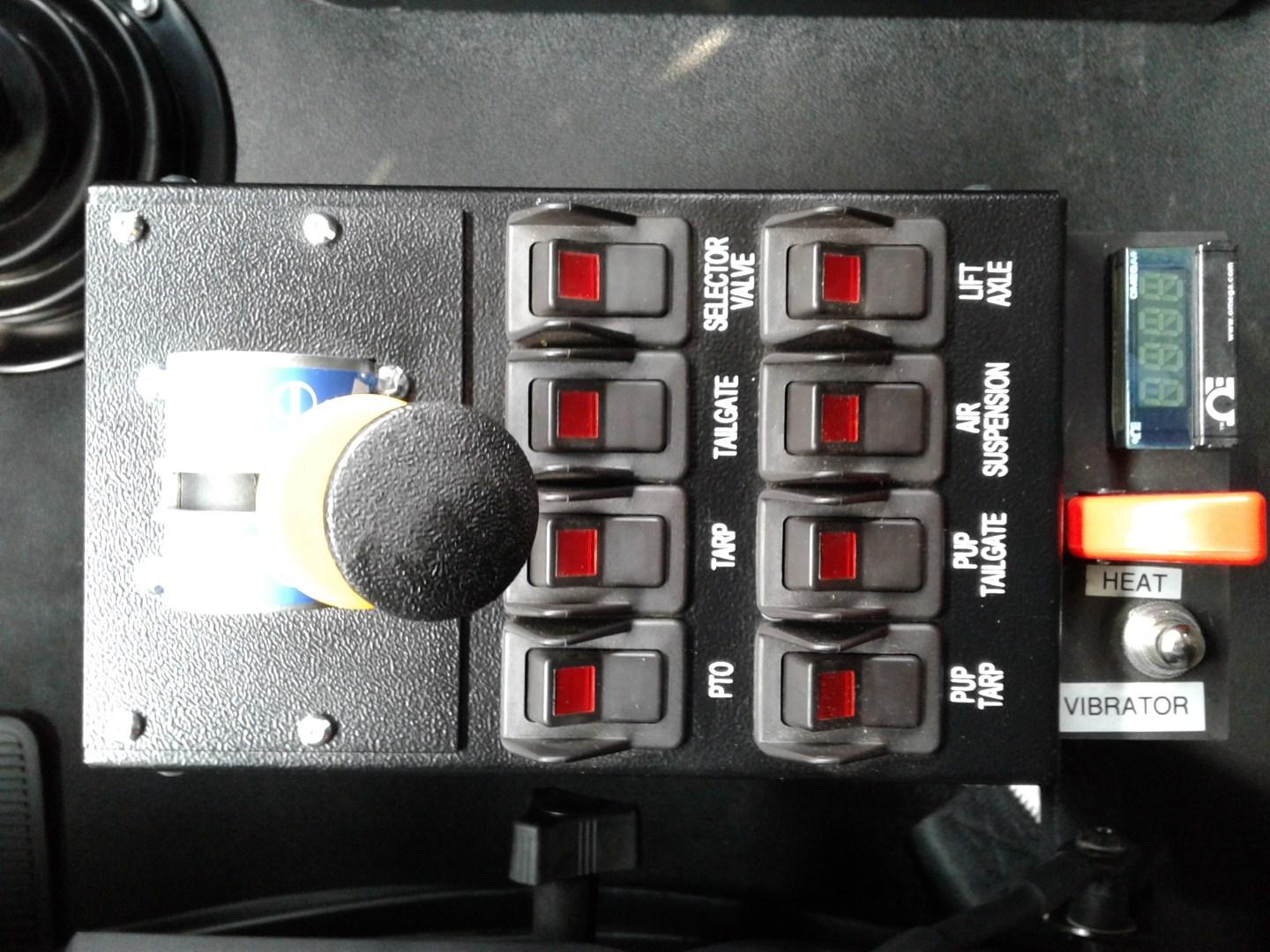

1 hour ago, Freightrain said:
HEAT/VIBRATOR?   Is that for the drivers seat or the dump bed??  :tease:
Best you don't go there. . . :whistling:

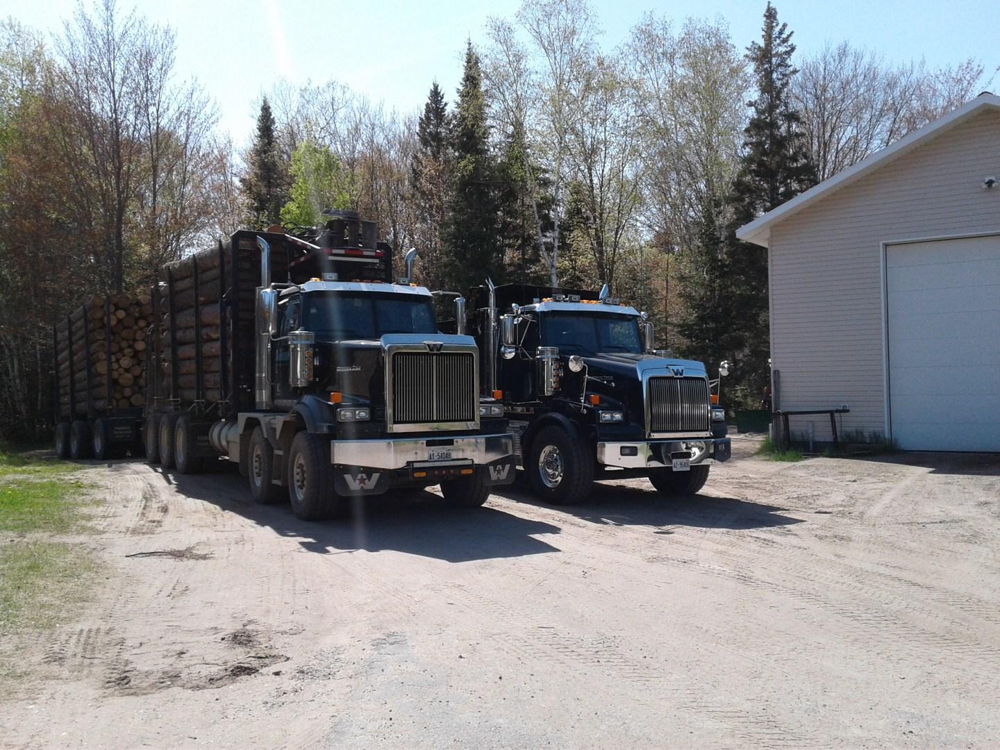

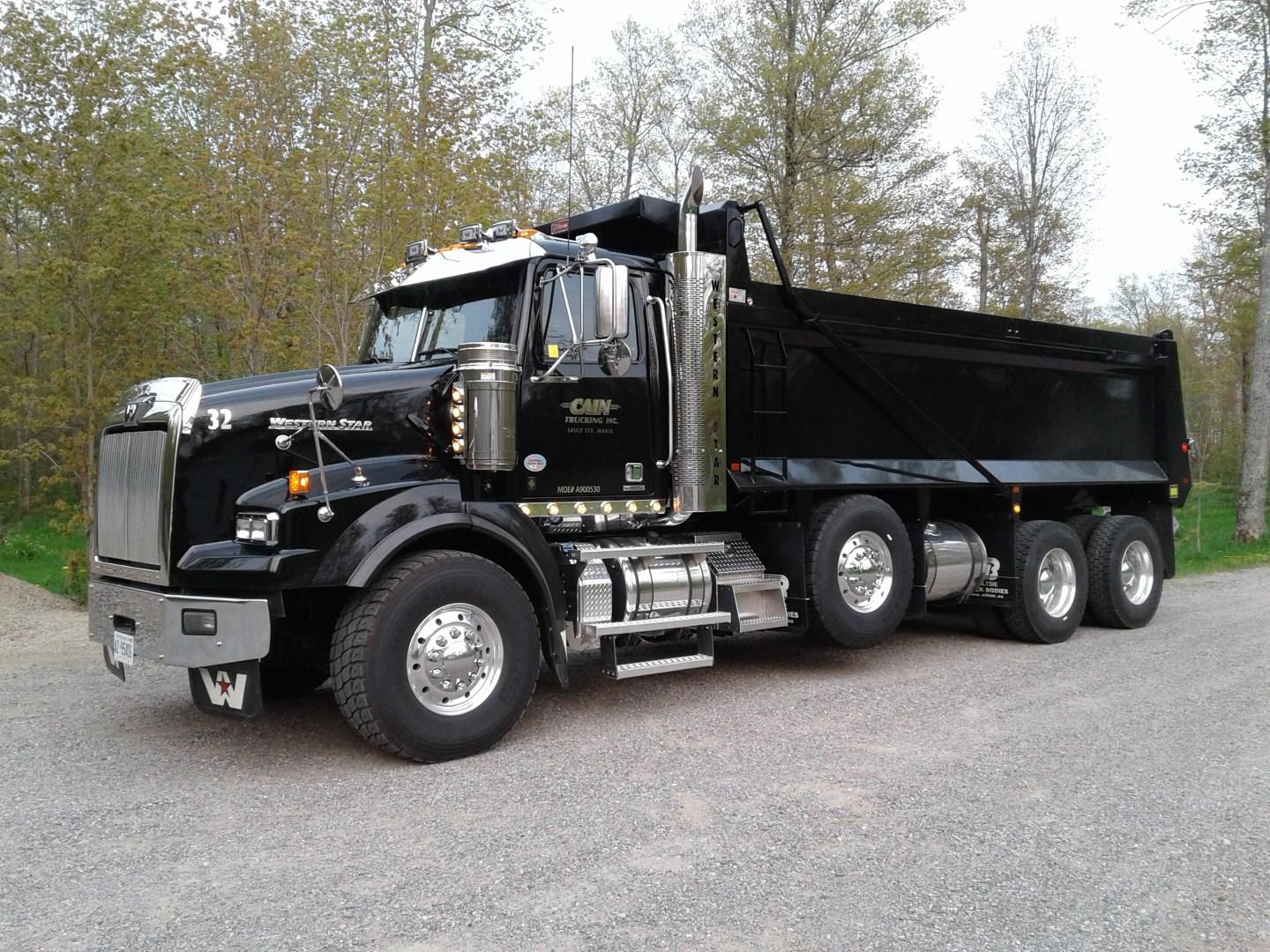

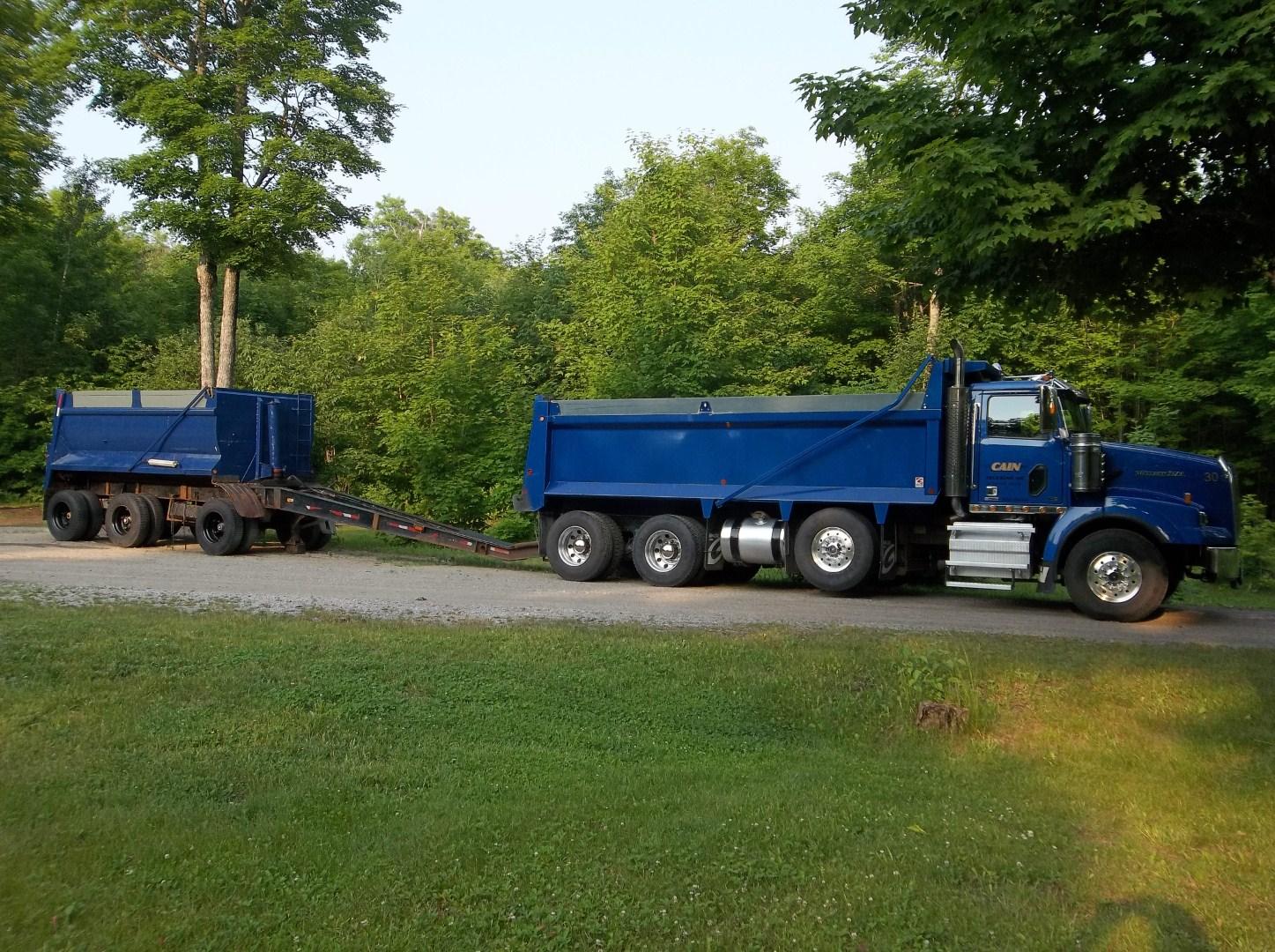

Even my friend that has that twin steer Star in the pics above. He previously had a Titan MP10 605 and he had very few issues with it.

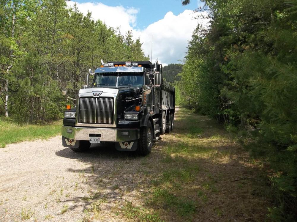

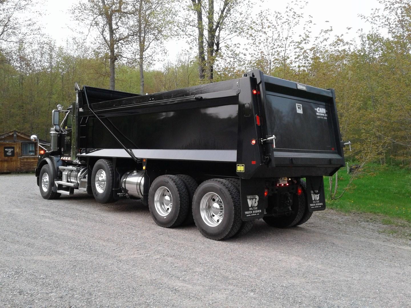

Had to get her dirty. First week of work, so far so good. The first week with the blue 2013 I could fill a whole book with the issues it had.
I do find this DD13 505 louder in the cab and harder on fuel than the DD15 505 and the ISX600 we had.
But it will easily outpull the DD15 505 because it has more torque.
And the kind of scenery that makes you kinda like trucking.
I just wish the Mack Granite 505/M-Drive would have loaded closer behind me so we could have seen how they compared on the 10% grades.
