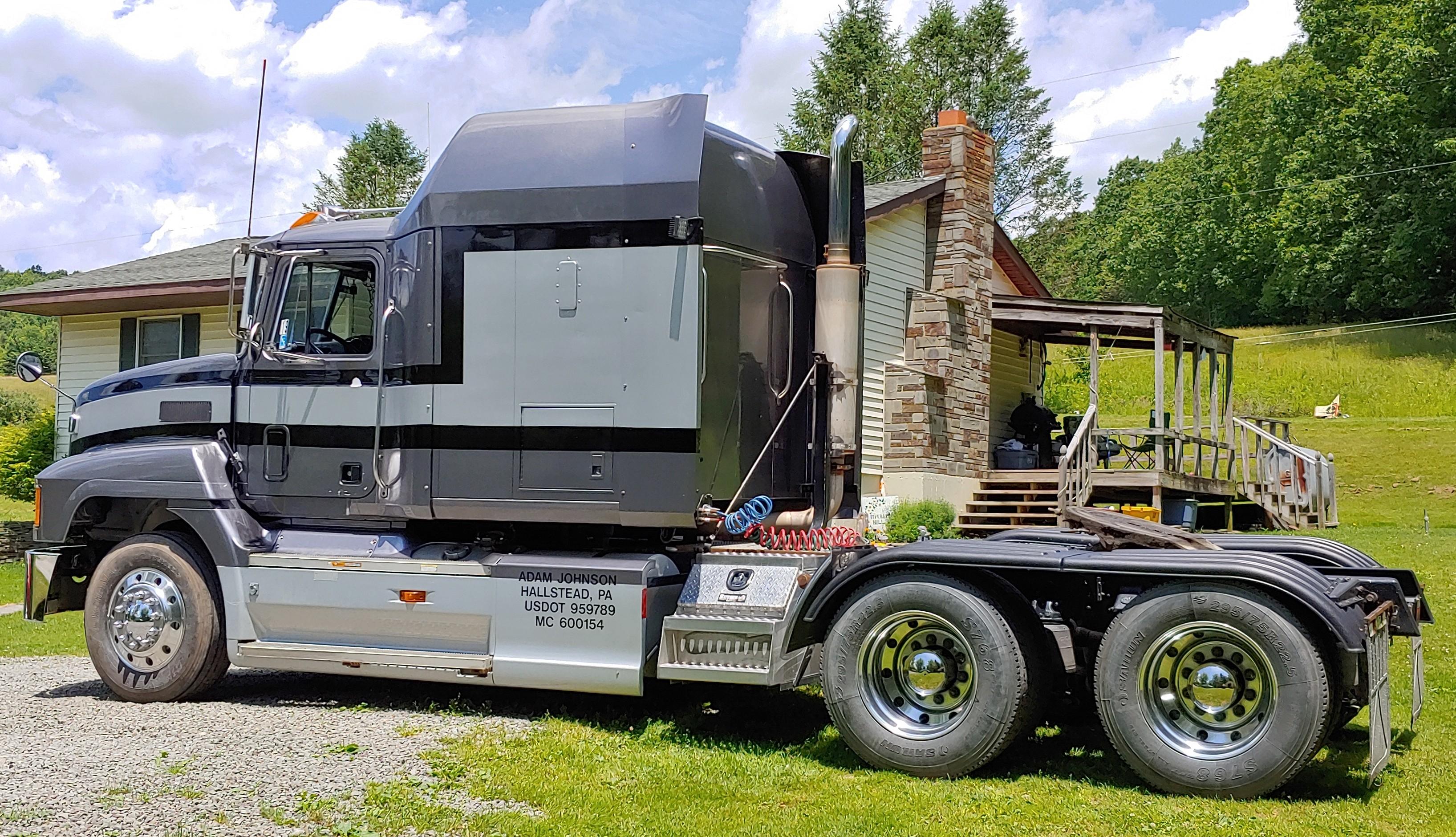

So what's everyone's preferred brand/model of low speed grinder/polishers for using with clay bars?
Up until a few years ago I used to just stay on top of it and use Autosol and buff by hand. But now that I am getting older and extremely lazy, think I'll buy a buffer, just not sure which to buy.

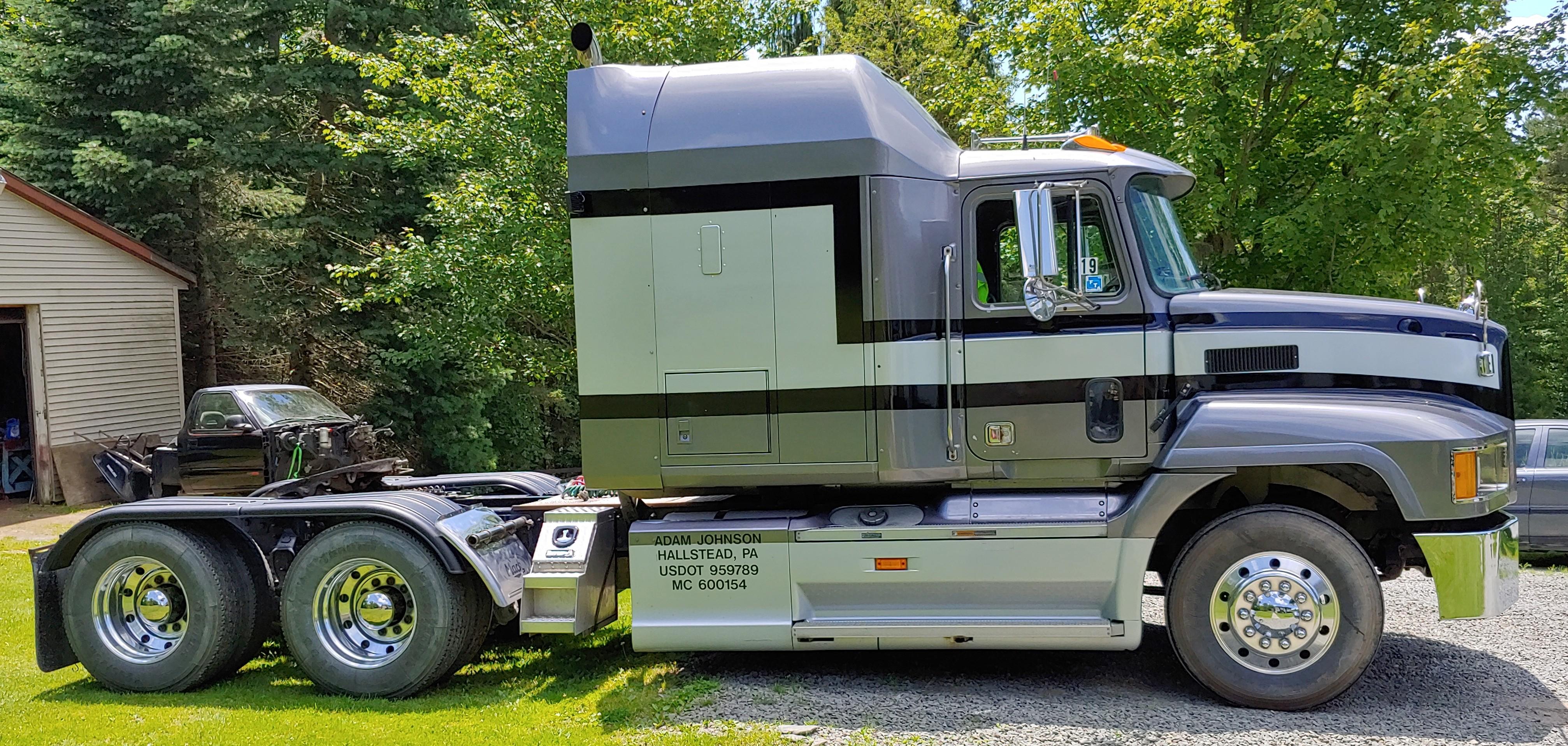

Recently I've resorted to using nothing more than SOS pads since the nature of my business is the truck gets dirty every day. But since my new truck doesn't have me hating life yet like the last one, I kinda wanna take care of it, LOL.
This is what the old one looked like with just SOS pads on the wheels and acid on the checker plate under the cab. It's good enough for what I do, but since the new one is still shiny new I don't wanna take SOS pads to it yet, LOL.

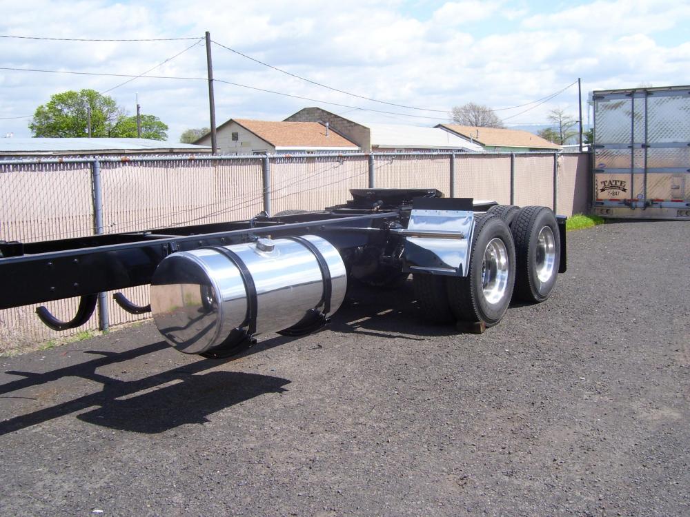

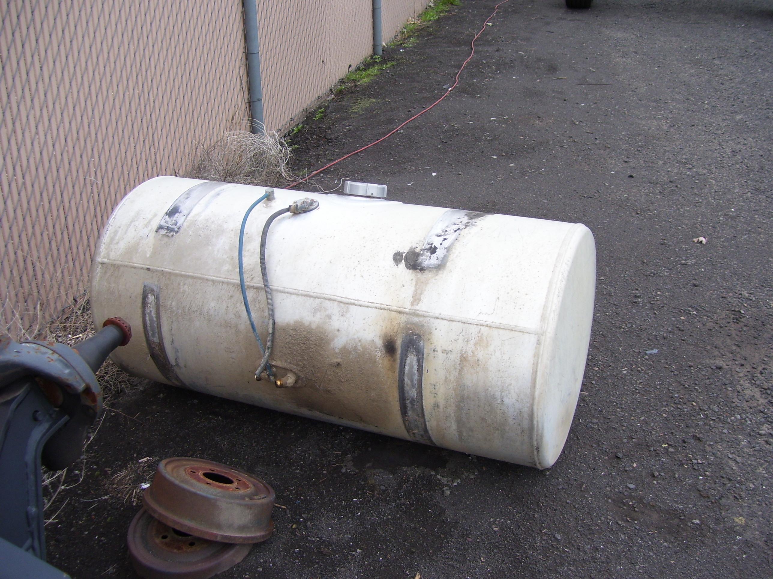

                                      For DIY use just go to harbor freight they have two models of polishers I bought the $75.00 buck one that has like four speed settings, 1000 to 3500 rpm. And I found 3500 works best.
                                     I bought a 3 pack of one 10" and  two 8" buffer wheels with three two lb bars of polish for $92.00 bucks off ebay. All of it worked real well, as you can see below.

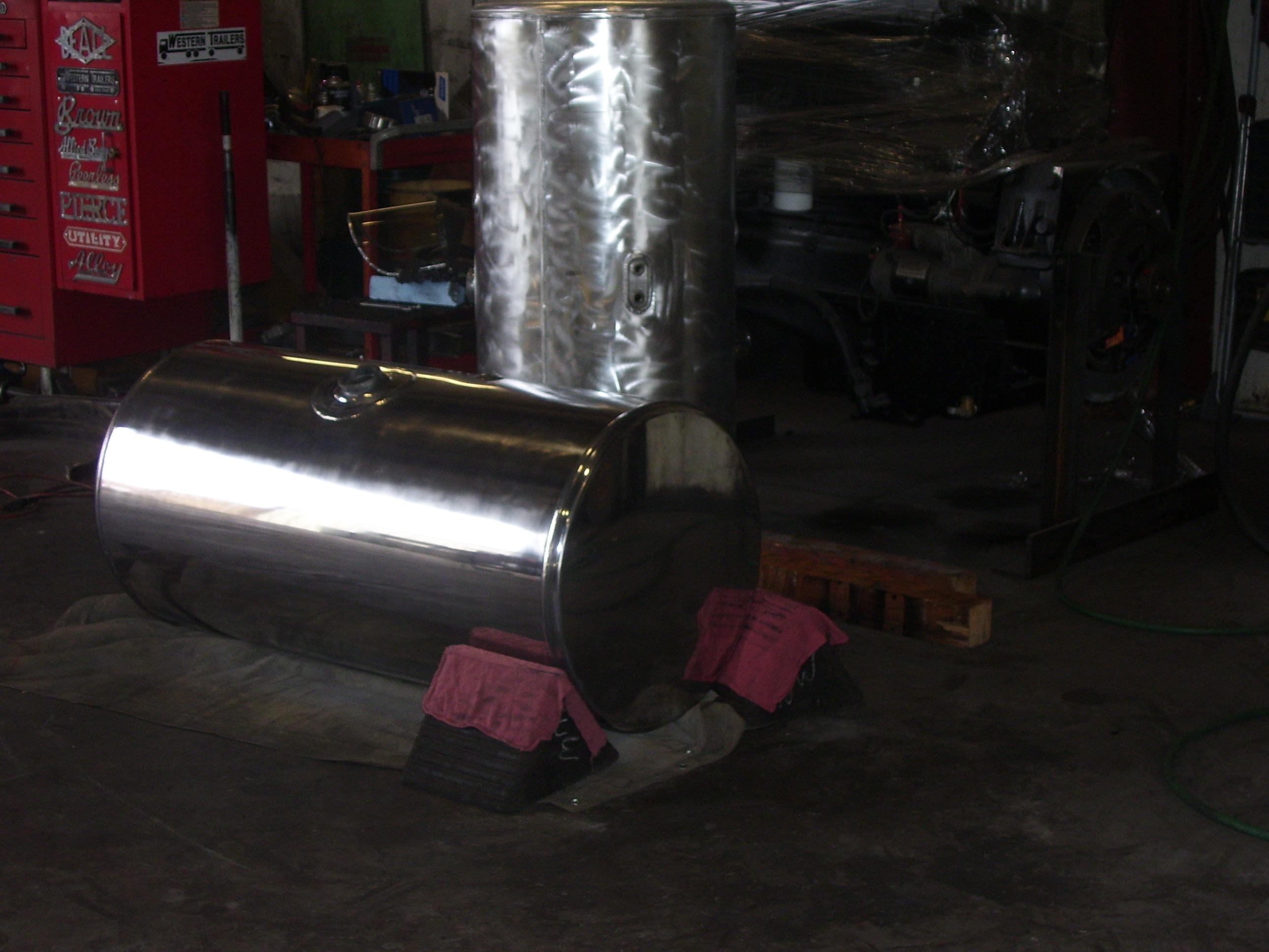

Watched a few videos and gave  it a try.  I bought a 6hp Dewalt grinder(big ol bastard).  Ya, it bites hard if you don't do it right.  Though now I'd like to get a smaller, slow speed grinder for touch ups.
Did the new tanks for my B.
