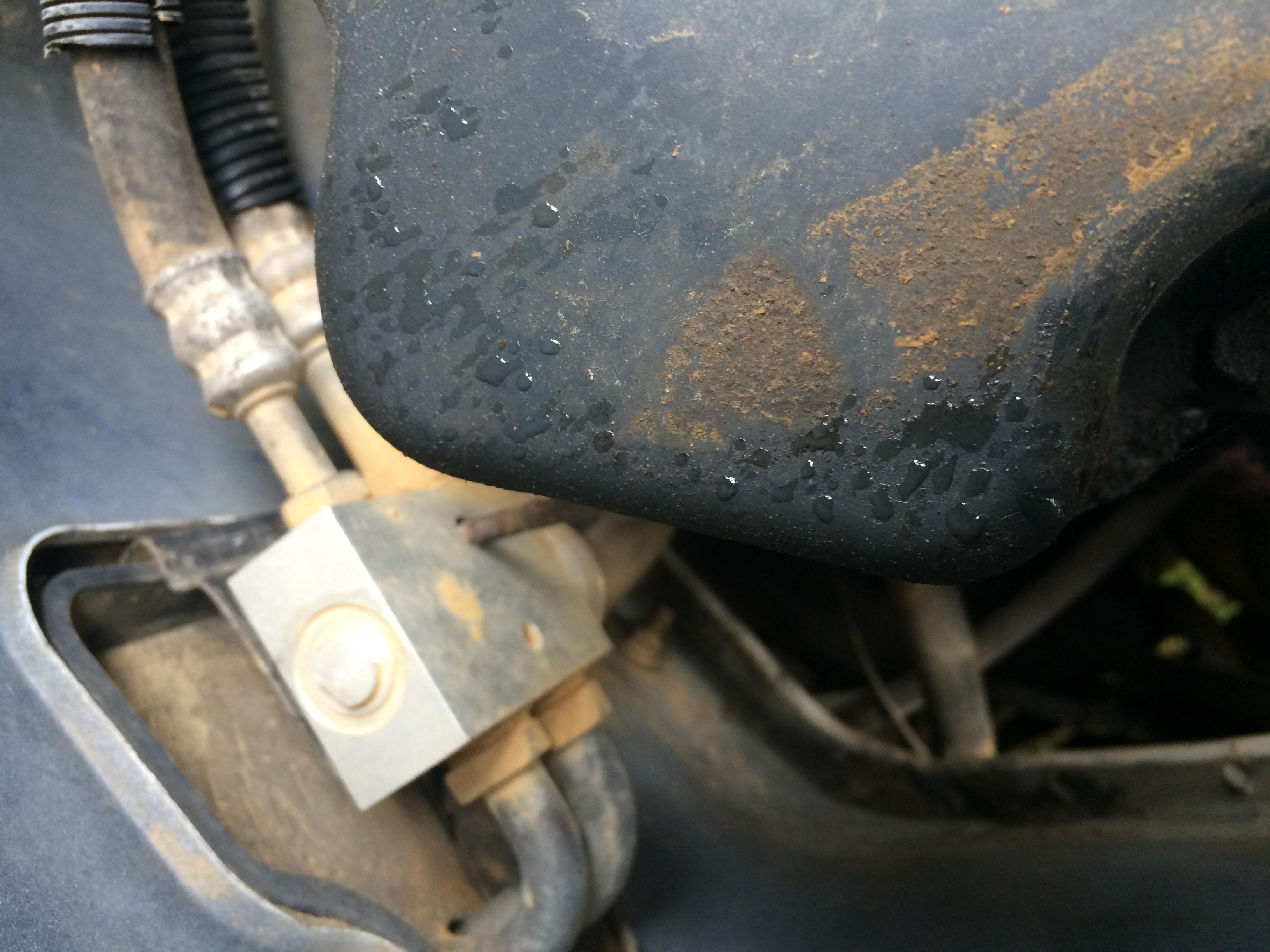

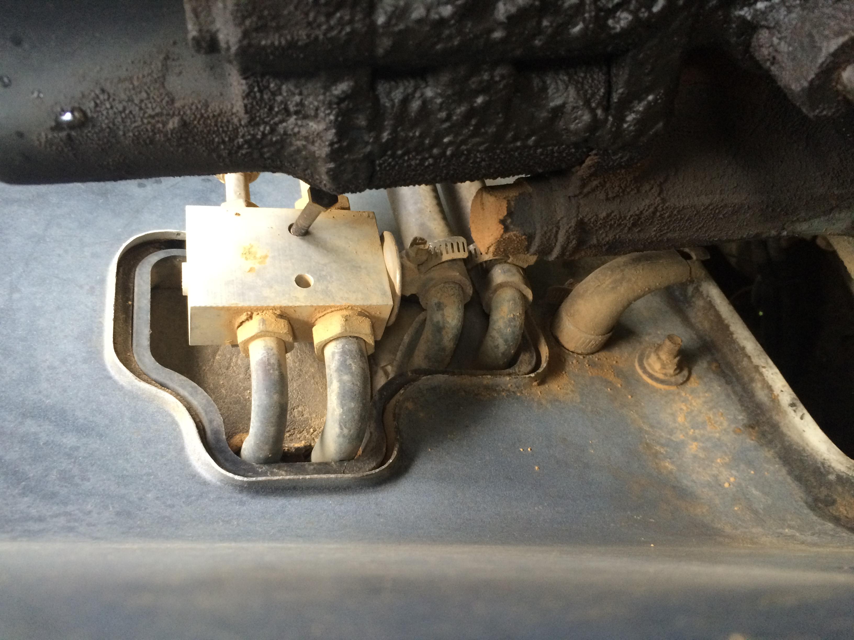

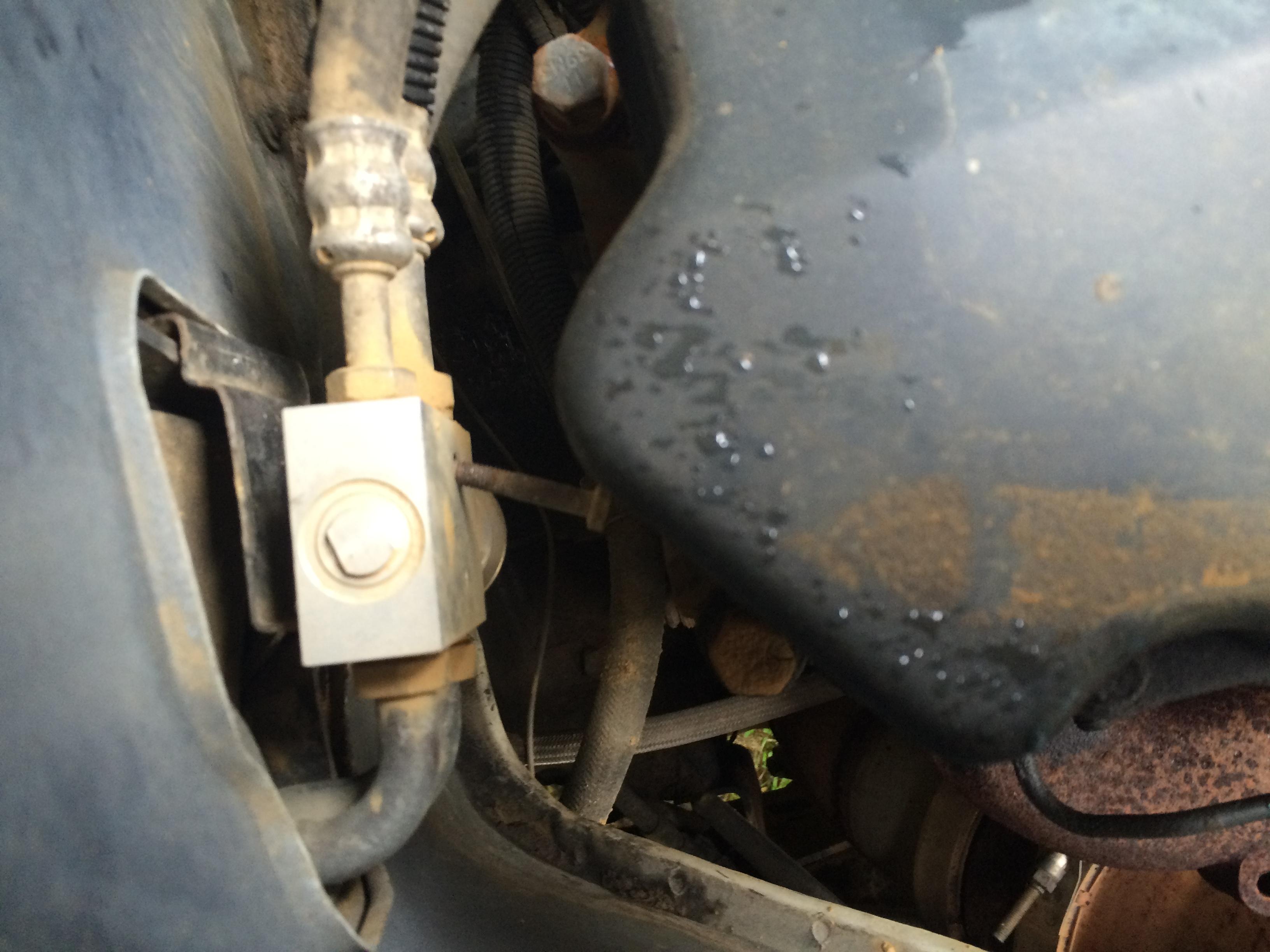

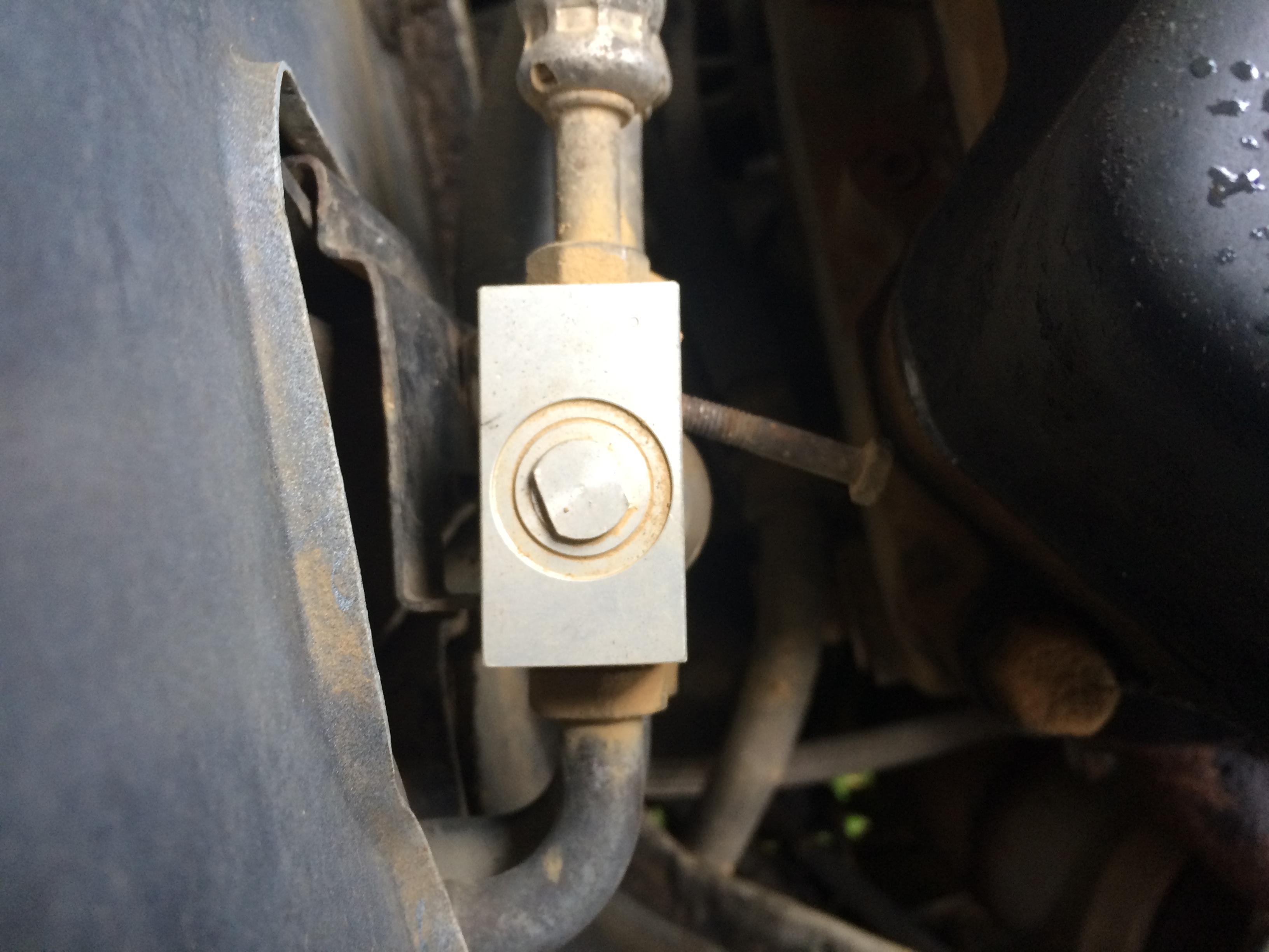

My 97 CH613 AC has had a leak at the Expansion Valve for years so I haven't used the AC in years the last time I tried to charge the system it did blow cold until all refrigerant was out of the system. In my area it’s really hot and now I think it’s time for some AC. I’m asking is it any easy fix to just replace the expansion Valve then charge the system. I have a picture of the expansion Valve that sits on the firewall. What can I use to get the expansion Valve loose I know the bolts will be trouble. Thanks for your help. FF430E8C-0925-4907-94DE-F2188B875BE6.thumb.jpeg.2767cb30bc99cf511845b1306da59fdc.jpeg8EC85C81-D910-4713-B190-F92D5284692C.thumb.jpeg.708c3391740866d51074e50fddeb7b98.jpeg0D01AEAF-D8B8-43B3-AE23-143EE413DAD2.thumb.jpeg.c521b921fda74447f89339f208deba67.jpeg6DDA00BD-29D0-43B1-ACDC-9247A228ADD6.thumb.jpeg.bf2ed0ad84049e96a6b1cf9ebf28e715.jpeg

Unfortunately going to be a can of worms once you start! If you have an impact hammer try massaging the valve at each flare but location and apply a little heat!

you can also try Any type of penetrating oil  again and air hammer on each nut location! You will need to replace the valve of coarse IF you can get it free! Had  luck with this Technic on a Peter built last month! Assembled with neverseaze on the threads !

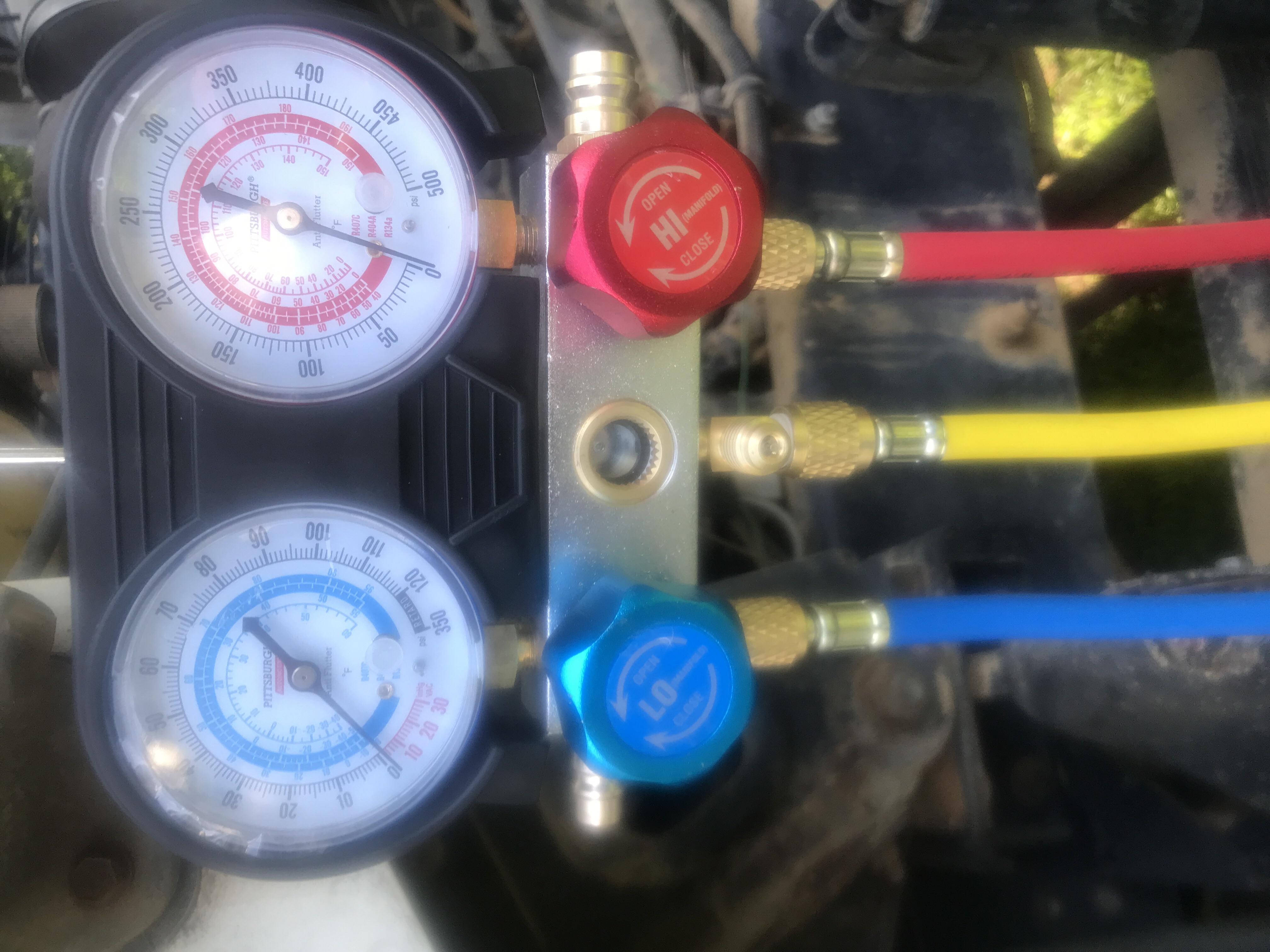

Rob I put the new expansion Valve on and replaced the receiver drier with a new one. I’m now performing vacuum but the readings I’m getting make me worried please take a look... I purchased manifold gauges and vacuum pump from harbor freight and I put the gauges on turn the pump on I see a mist coming from the pump is that normal?
https://www.bigmacktrucks.com/topic/57688-expansion-valve-leak/#findComment-428241
Yes; that’s normal, moisture; you just want to make sure you close the high side before filling. You can just pump it down on low side only. I always pump it down an close it off on gauges & check for 30 minutes & then I back off on the connector to the schraider valves. (Might have spelled wrong) because they are bad about leaking also.
