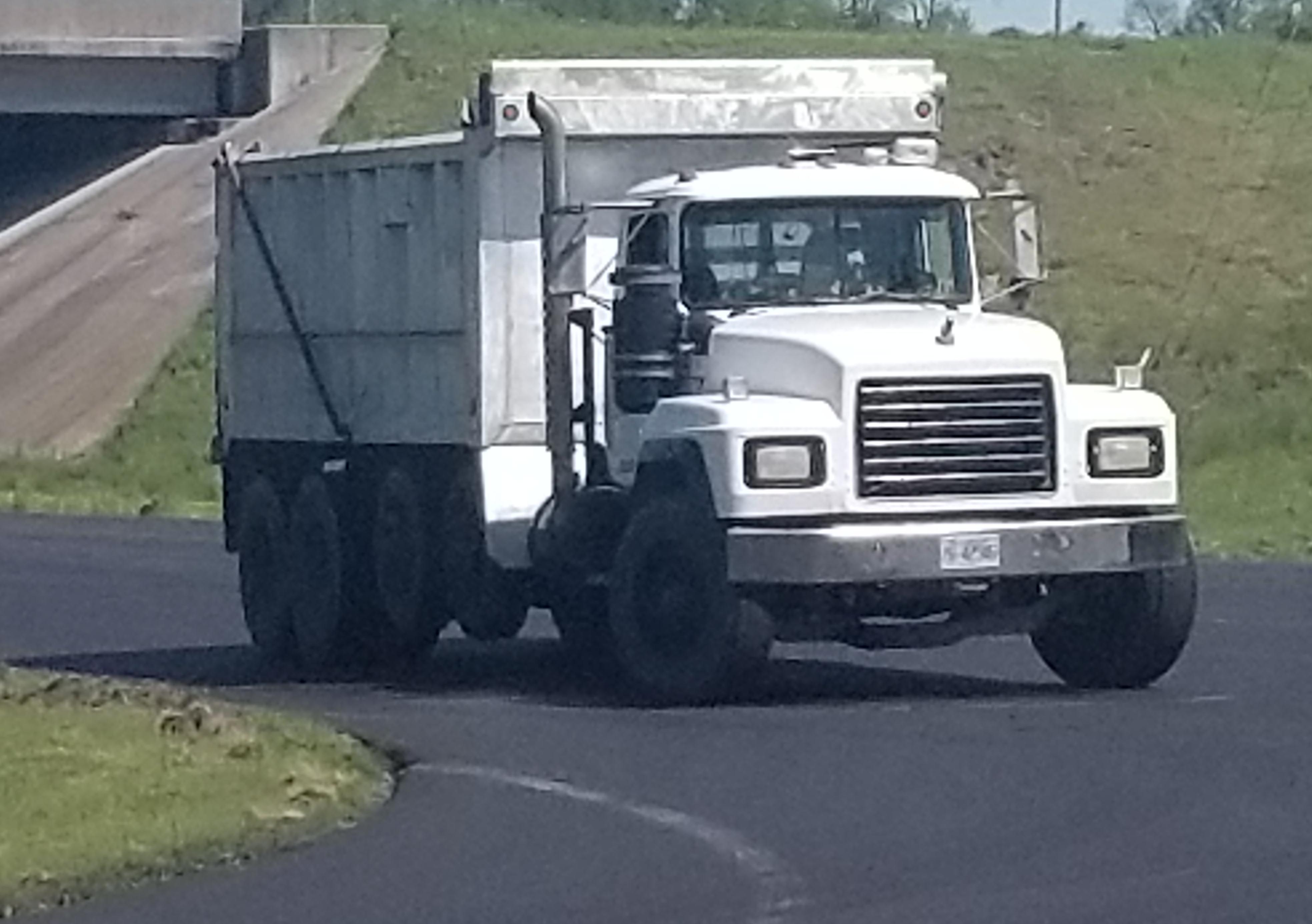

Ok guys I can't seem to get a break ..
Dump truck
300 hp e7
Allison auto
Last week the pipe that runs to the back off the turbo broke in half rusted so I replaced it 400.00 smh
2 days later truck started making a noise like something is rubbing
Truck was loaded asphalt got load off drive it home bout 40 miles took it to the shop another 15 miles had valve adjustment done to check things out everything is good replaced o ring behind oil filter set up as it was leaking thought maybe sucking or blowing air
Pick truck up they said they didn't find anything but they hear the noise
The noise co.es and go
I check turbo wheels no play there no lost of power oil pressure is good like always 30 idle about 50 driving I'm at a lost cant keep tossing money at it
I'll get a video today of the noise
Any thoughts to check where to look anything would be appreciated
Thanks
