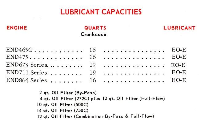

That filter number sounds about right.  Without looking at what you have, it is hard to say.  Numbers gone?  Running a bypass filter?
16 qts are in the pan.  Take a look at the chart for how many qts are in your filter setup.
20W-40 or 10W-30 were OEM specs.  I use Rotella 15W-40 or Mobil Delvac 15W-40.
