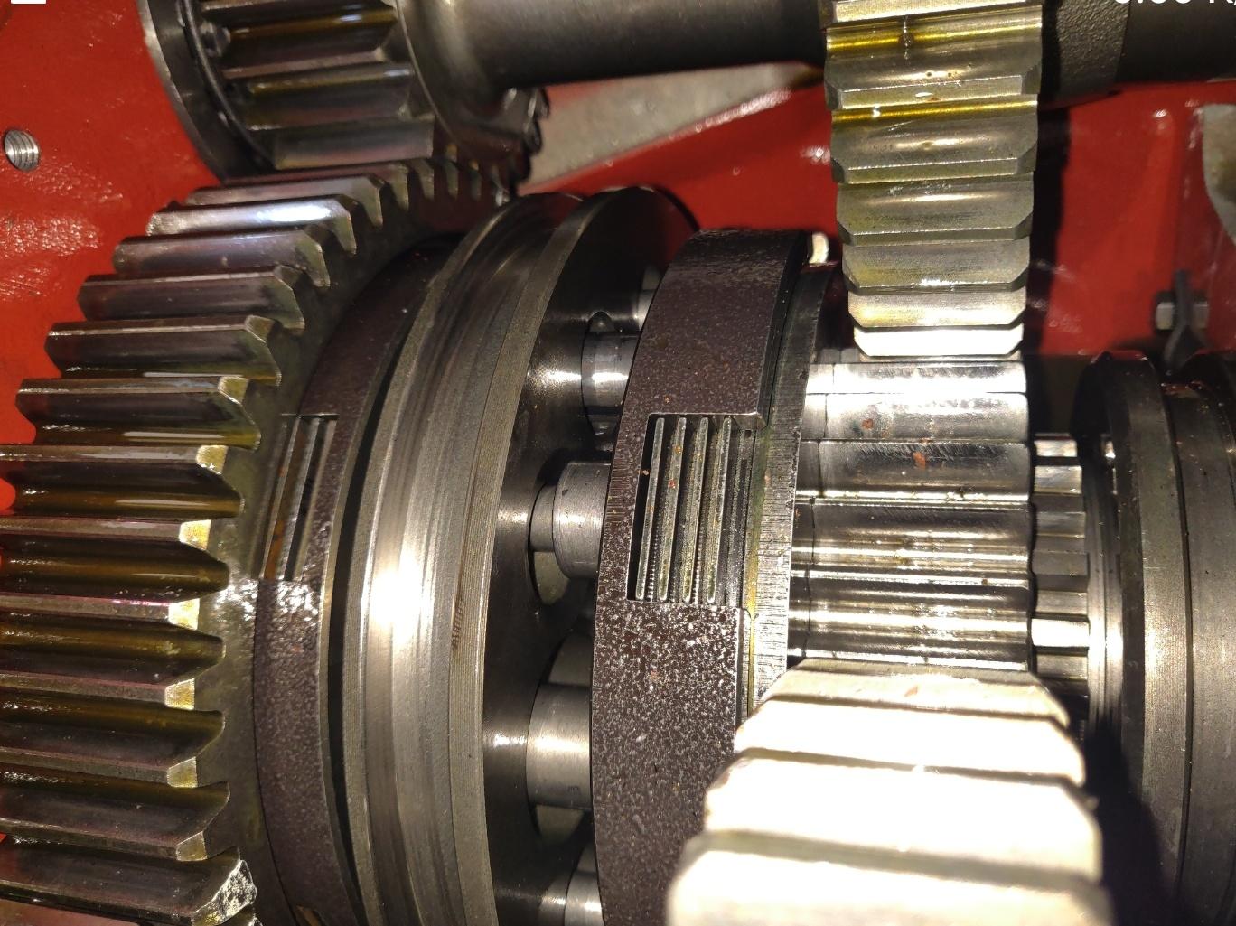

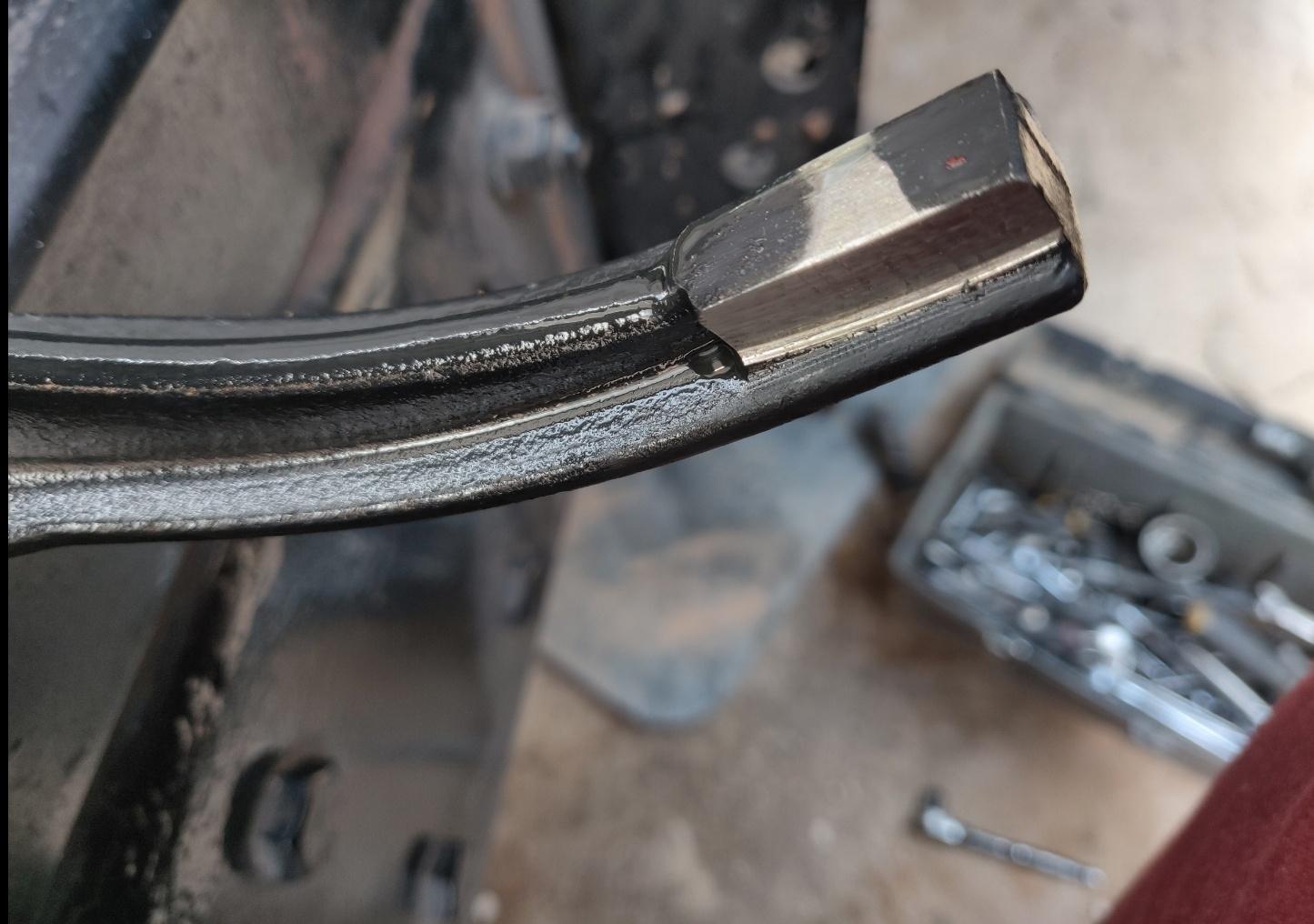

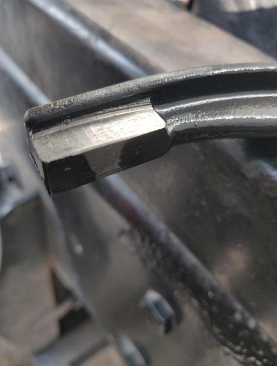

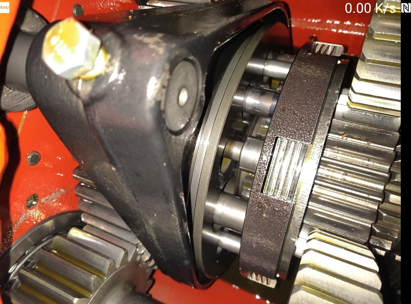

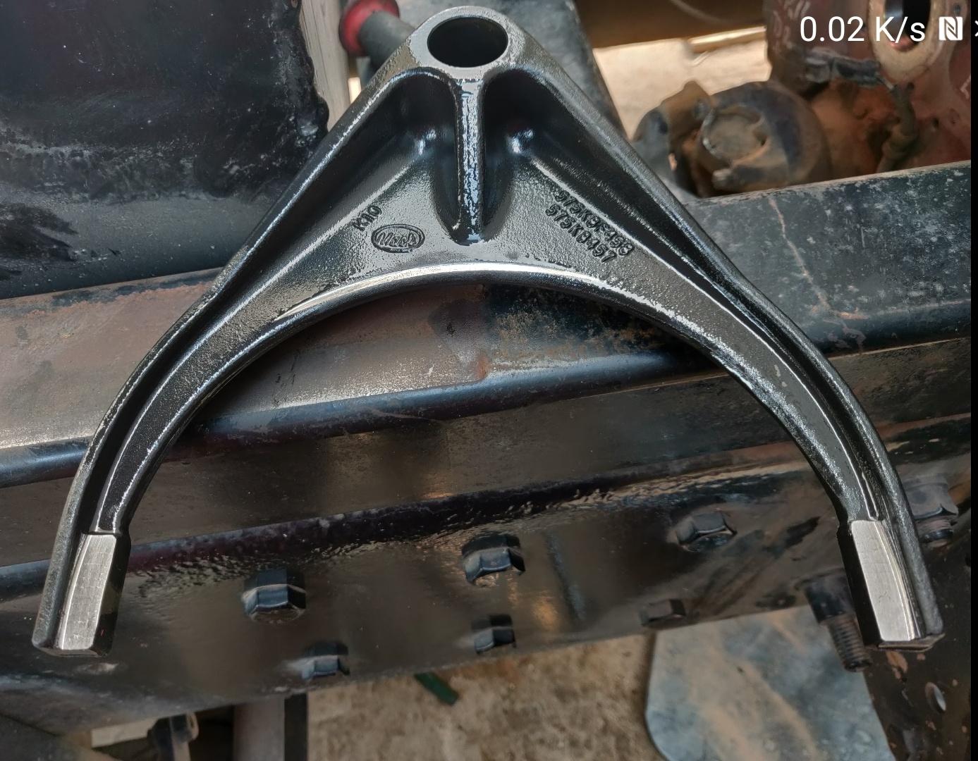

Finally got back from a much needed vacation and got to work on the transmission.took the rear cover off and below are the pictures of what seems to be the culprit.
Not sure what the specifications are for shift fork wear but this one seems to be very worn.please advice.
Thanks
Red
https://www.bigmacktrucks.com/topic/58306-t310m-on-its-way-out/#findComment-430227
Fork not horrible. Clutch plate receiver for fork worn badly, but not destroyed. Both need to be replaced. How chewy are the slider clutch teeth? Need to get a pry bar in and move the plate both directions now that fork is out while scanning the teeth.
Edited by Mack Technician
https://www.bigmacktrucks.com/topic/58306-t310m-on-its-way-out/#findComment-430234
You may need a long list of stuff. All soft parts, Clutch as a replacement unit, fork, hub bearing, rear seal, snap rings, etc. Need to condemn what you can readily see before you can decide best practice. You see eroded teeth you are moving toward more expensive and invasive.
https://www.bigmacktrucks.com/topic/58306-t310m-on-its-way-out/#findComment-430242

I’ve pulled reman trans forks out and they hard wire welded the fork pads and cut them back down. Reman company’s find ways to make reman profitable.

The ring that receives the fork is definitely worn. I realize it’s back in, but for anyone else, don’t be afraid to add metal to fork, past original thickness dimension, to compensate for both (fork and slider) worn surfaces. You have nothing to lose.
