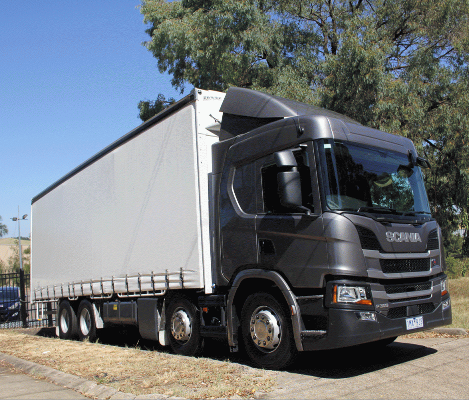

With a continual drive to lower the fuel consumption of its trucks, Scania has introduced a P 360 8×2 rigid version of the New Truck Generation range, targeted squarely at urban distribution roles. Paul Matthei took a loaded unit for a jaunt over the Blue Mountains west of Sydney and returned with an extraordinary fuel figure.

The P 360 8×2 rigid is a great example of this philosophy. Acutely aware of the need to negate the aforementioned vagaries of early ‘lazies’, Scania has designed the rear air suspension with a driver-controlled load transfer system that during low speed manoeuvring simultaneously increases the air pressure in the drive bags while decreasing that of the tag bags.
This combined with the standard diff lock is designed to provide sufficient traction in any tricky situation likely to be encountered during regular urban distribution driving.
