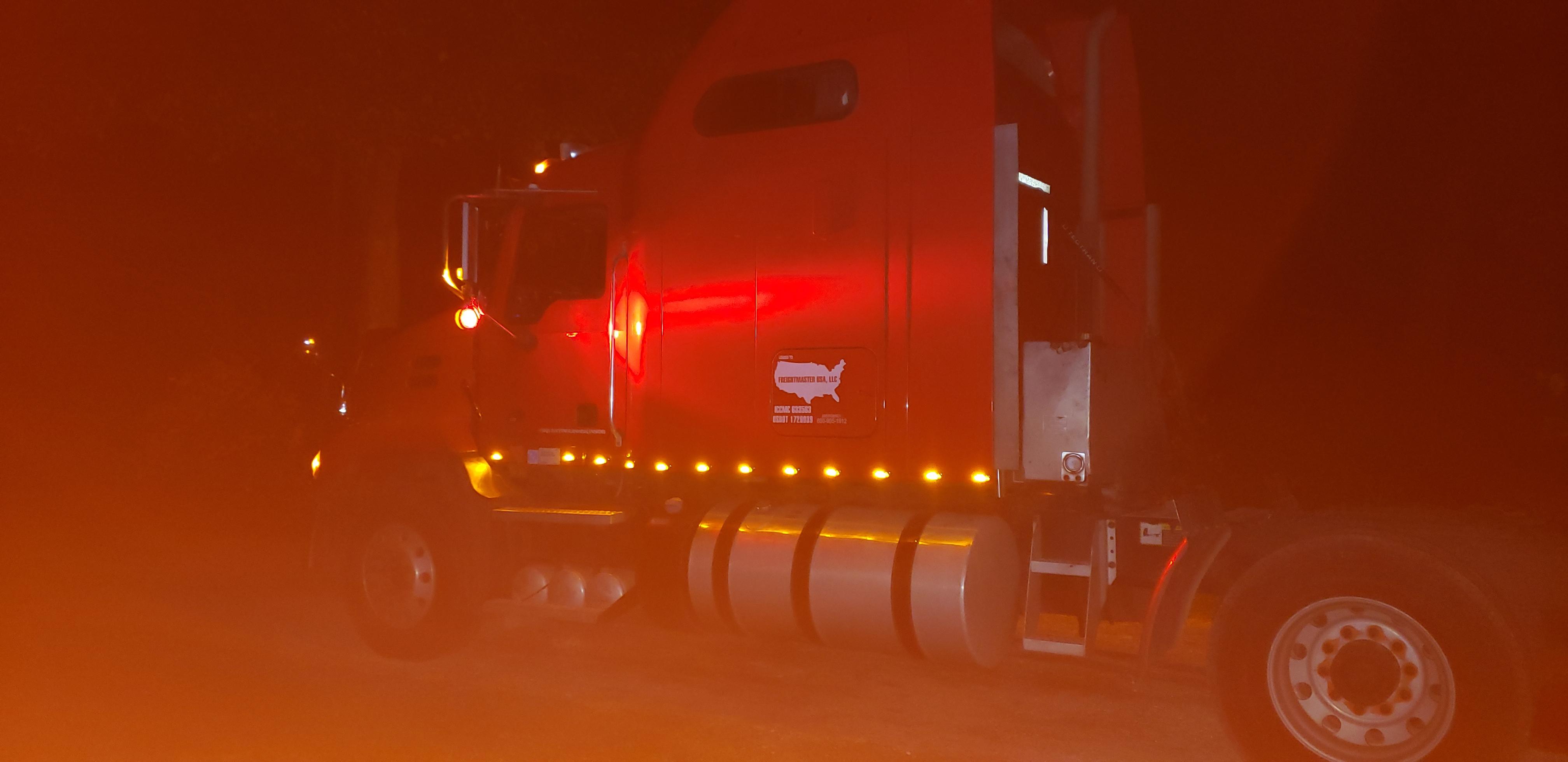

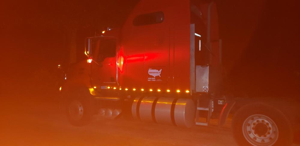

Do you ever miss the older truck you had before this one?
Damn sure do. It was cosmically nasty (interior) from the last owner, but pretty reliable. Rears needed to be reman so I parted ways with it. Should have just bought a cut off for it.
