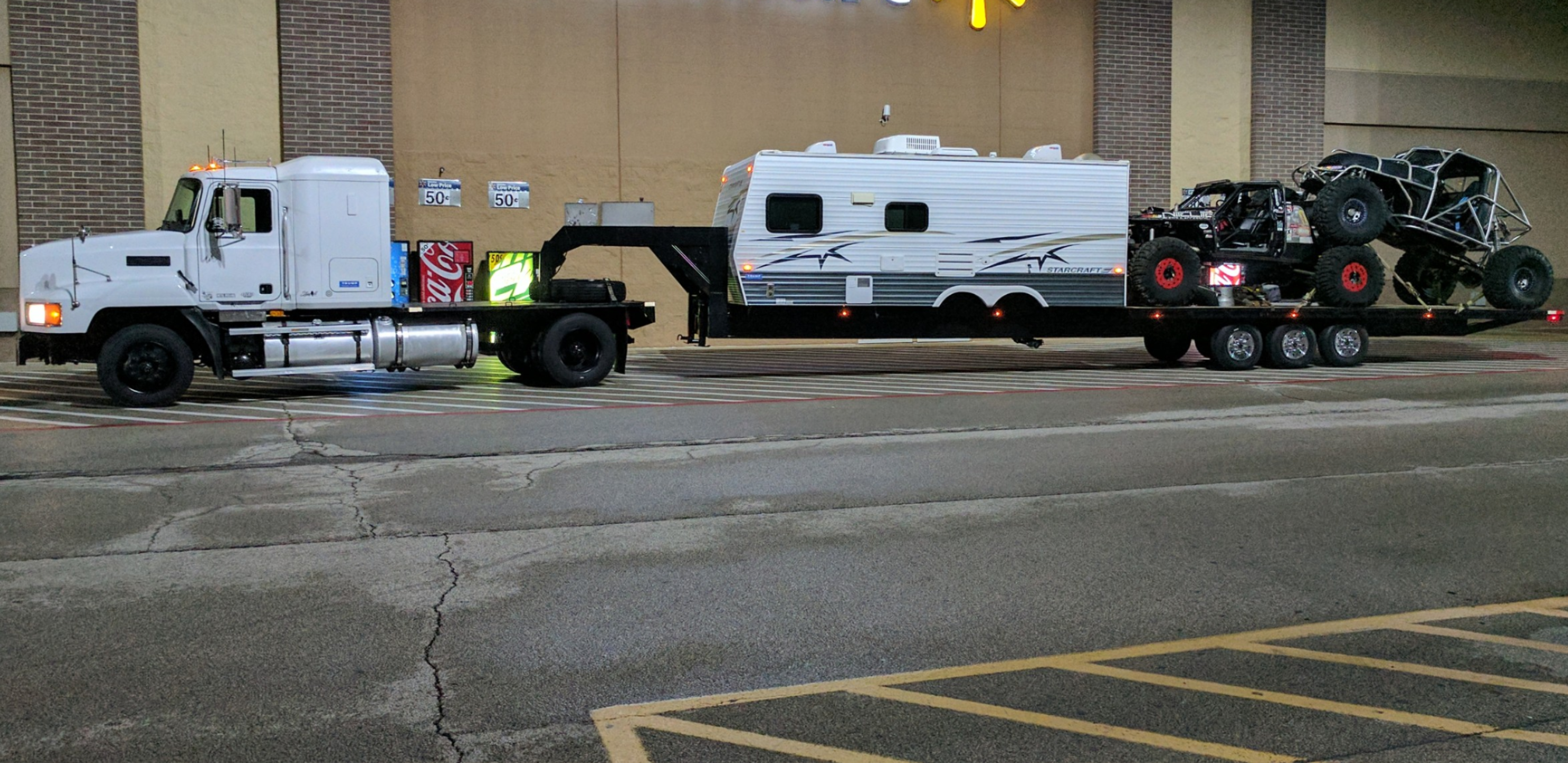

New here. Have a 98 CH single screw set back axle tractor. Super solid and very mechanically sound. Registered as an RV and I pull my custom made 52' "crawler hauler" gooseneck with it. I'm looking into information to convert the truck to a set forward axle. I have a few yards close to me with a ton of Mack trucks in them thanx to all the dumps and mixer trucks in the Midwest. Would love a list of things I could modify it move myself vs a list of things that need to be sourced from another truck. ANY help would be greatly appreciated!
