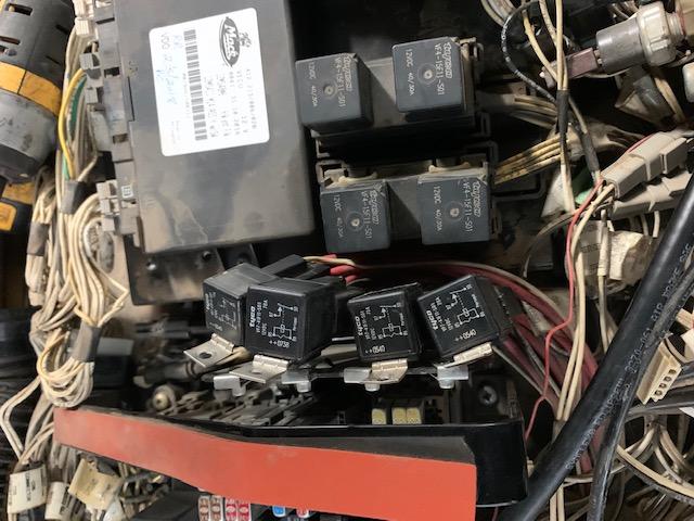

ok found high/low beam relay bad changed been running with no problems for a month now did same thing 2x today also this morning truck would not start. When i turned key only heard buzzing coming from these 4 relays. Does anybody know what these control? im guessing one has to be starter i cycle the key a few times then it cranks i checked to the wire had 11.50 but when i turned key switch dropped to 5.5 volts now truck will not start going to just start tracing wires unless someone could help a brother out

If they’re buzzing you have a short to ground on the power output of the relay(post 30’s output side).  If you have a 30 AMP relay they buzz if you try to draw more than 30 AMP through them. Protection feature. Those are more than 30 amp. Hard to read.
