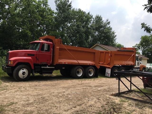

4 minutes ago, Mack Technician said:
Throw out a pic of your custom build.
I haven't made any bodies yet, I plan to start in October. I've had my bodies made by a local shop, although I think they get a kit from someone else and just do the welding work. I've made some designs in Fusion 360 that I think would be overall improvements. They are semi round. Here is a photo of my first two I had made locally. Aside from design improvements I plan to add some inclinometers for added safety when dumping. Its not my priority though, I need to finalize my design first.
