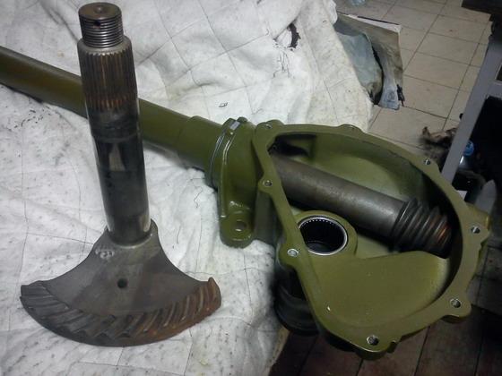

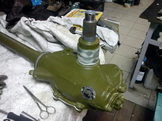

I don't know what you have of the steering gear on your LS85 but my L-model - like Mack truck (NR) has one named as Mack Archemoid gear. I had two of them when revised, used perfect low mile screw and sector but found play of the sector cross shaft (the Pitman arm was pressed onto). The shaft turns in two needle bearings and I could trace a pair of NOS ones through fleabay. Those were Torrington brand and almost identical to the original content. The final issue was new bearings supplied almost the same play of the shaft and some overall play in the assembled gear as it was with the old ones. So looked like a factory design to me. I was thinking on plasma-welding excessive metal to the shaft journals and than grind them down to the desired size but passed on that being afraid ruining the shaft.

Look at the box there should be a lash adjustment on it. Generally a jamb nut and a slotted machine thread screw to adjust the sector shaft play. If it is there you need to get the specs on end play. May be a Sheppard box in it but not 100% sure.
