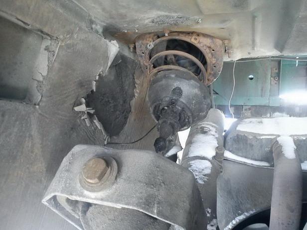

Got a little update on my MH613. Turns out that the shifter was stuck in the aluminum housing.  It took a little persuasion with a pry bar, but u got it separated.  Thanks @Vladislav and the rest of you guys for pitching in and giving advice.
One thing I noticed,  the clamp that holds the bid rubber boot the shifter and big spring assembly is incased in on the underside of the cab was gone and when I did get the cab up and the shifter assembly separated,  the shifter and spring wanted to fall out. Not a big deal, shes starting the early stages of a rebuild.

I apologize guys, I'm still trying to figure out how to post pics on this site.
I was able to get the shifter pushed back up into the boot and where its supposed to be. Everything went back together just fine when I let the cab back down.

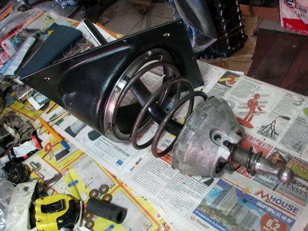

Personally for me no need in the picture since my shifter fell down either:) You could even take it off just sitting in a driver's chear. I found that spring's design very strange. It was (probably) originally welded to a steel cup which bolts on to the cab plate and the floor. It was difficult to me to recognize the originality completely because of multiple repairs i.e. welds of that poor spring. Being where I'm being I couldn't find a solid shifter assembly so I ended up ordering custom fabrication of such spring and two still rings I drilled holes in to attach the ends of the spring to both upper plate and lover cap. A hell of a job and I still have not solved issue of having no boot. Right at the time I don't have inside the cab boot either so when you start the engine the fan blows very intensive into the cab and your face. I'm going to order the lower boot at upholstery shop made of leather (don't see other options) and the cab boot is already new on a shelf (avalible from PAI). But currently I don't work on the MH since had to concentrate attention to other projects.

I appreciate you sharing that picture! It gives me an idea what to expect when I pull that shifter assembly out.
Looks like whoever did that spring for you did a fantastic job. That whole assembly looks like new in your picture Vladislav.

Yes, it was. Made by hands :)
A friend of mine had a contact at some factory. There was a guy who could make custom springs. I gave the samle and got the result in a week. But there was a talk of the spring guy looked at the sample and said he couldn't do that because of lot of labour. My friend said he will look for another place. The guy than said "Ok, I will try". He made a cone in a lathe with a spiral track on its side, took a piece of correct steel wire, turned over the cone, put into a stoove and than cooled off. In theory I could order two of them but didn't see a reason.
Another (and too probably the original) issue is welding. Spring is a heat treated part made of high carbone steel which 1st doesn't weld and 2nd would loose its strength if you try welding it. So what happened to my shifter was expectional but what Mack had of the desing is a mystery. My way of solving the problem could be seen at the pics. I ordered two steel rings with a notch to accomodate the end of the spring wire but had to make a cut out (by saw and file) to allow the wire to get out where elevating. I drilled some holes and also did that in the attachment parts of the shifter and assembled everything with small screws and nuts.
Currently all that is installed in the truck and it shifter well. It just happened that the truck showed out other serious troubles so I had to put its restoration on a back burner.
