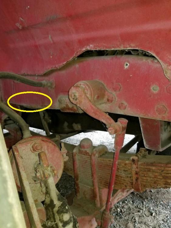

Took a ride out of curiosity, I knew the truck didn’t have a title. Not the worst thing in the world, there’s ways to get one. Took a look at the right front frame rail, couldn’t find any tracings of a vin number. Are there any other spots on the frame that could have numbers??

Looks like a B-model chassis. The # could be stamped at the rear of a frame rail.
Yes, look back by the rear spring hanger(front axle), behind that brake air line.
Agree looks like B chassis.  Early turbo motor.
Look down by front of accy drive( lower pass side), below that fuel filter.  Should have stampings across the top that says END673T or the like.

2 hours ago, 1977vega said:
L cab B75. all the trim, lights, ID tags have been removed.
Interesting.  I have never found the frame numbers on my B75 with L cab either.  It did come with the title and VIN plate.
Jim
Ok, so that may prove I’m not totally insane, bc I looked like crazy. Any other L cab owners that can chime in??
I’ll have to look to be sure but I seem to remember not finding numbers stamped in my B75 frame either....I think.
Owner found the numbers in front of the rear spring hanger but super faint. Stamped B73Txxxx, so it’s a mutt truck. Wants 5k for it. I might be interested at 2500, but they export, so the chances of making a deal are slim. No title and I don’t want to take a gamble with the truck possibly being stolen after the deal is done
