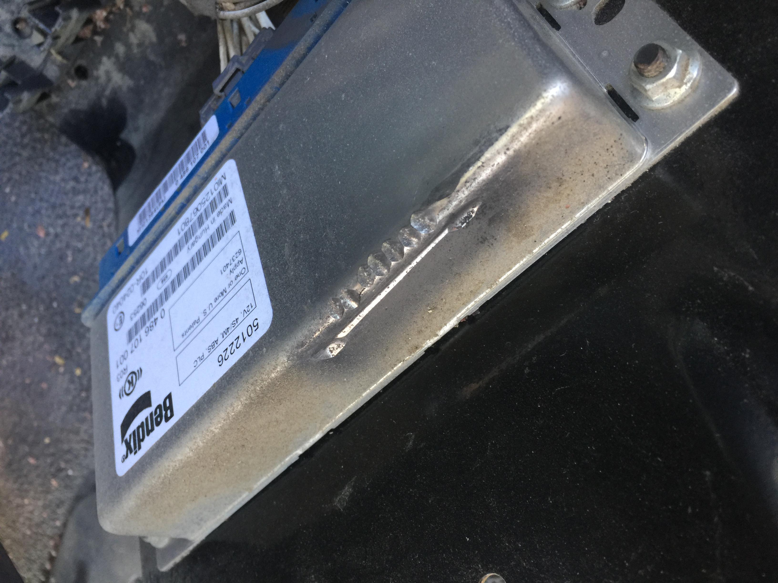

We still have a few ETECH trucks running at my work. Last week we had a random low power complaint with no codes or malfunction light coming on . Pulled the kick panel down in front on the passenger seat where the VECU and ABS ECM are located. Found wire rubbed on the ABS  ecm and kick panel and the cab it’s self. I took lots of pics of this issue but out of data to post them here. Repaired the wires and problems went away. If you had access to the older VMAC 3 diag program ( not Tech Tool) you could test drive while watching the “Active Code” screen as sometimes a code will pop up on the screen and go out before it logs the code or turns the malfunction light on . Also there’s shims on the timing sensor on the camshaft. Too deep or to shallow and you will have issues.

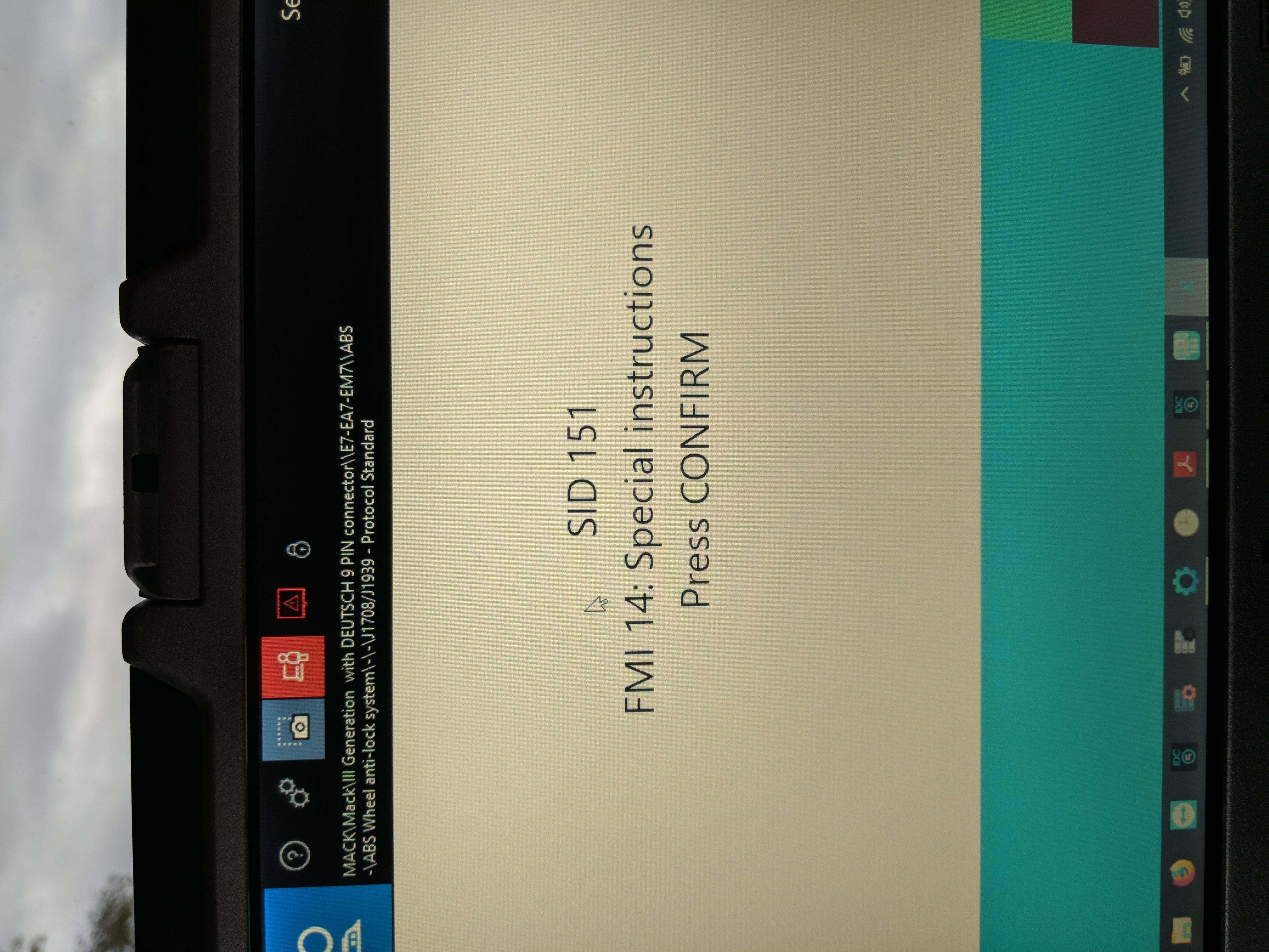

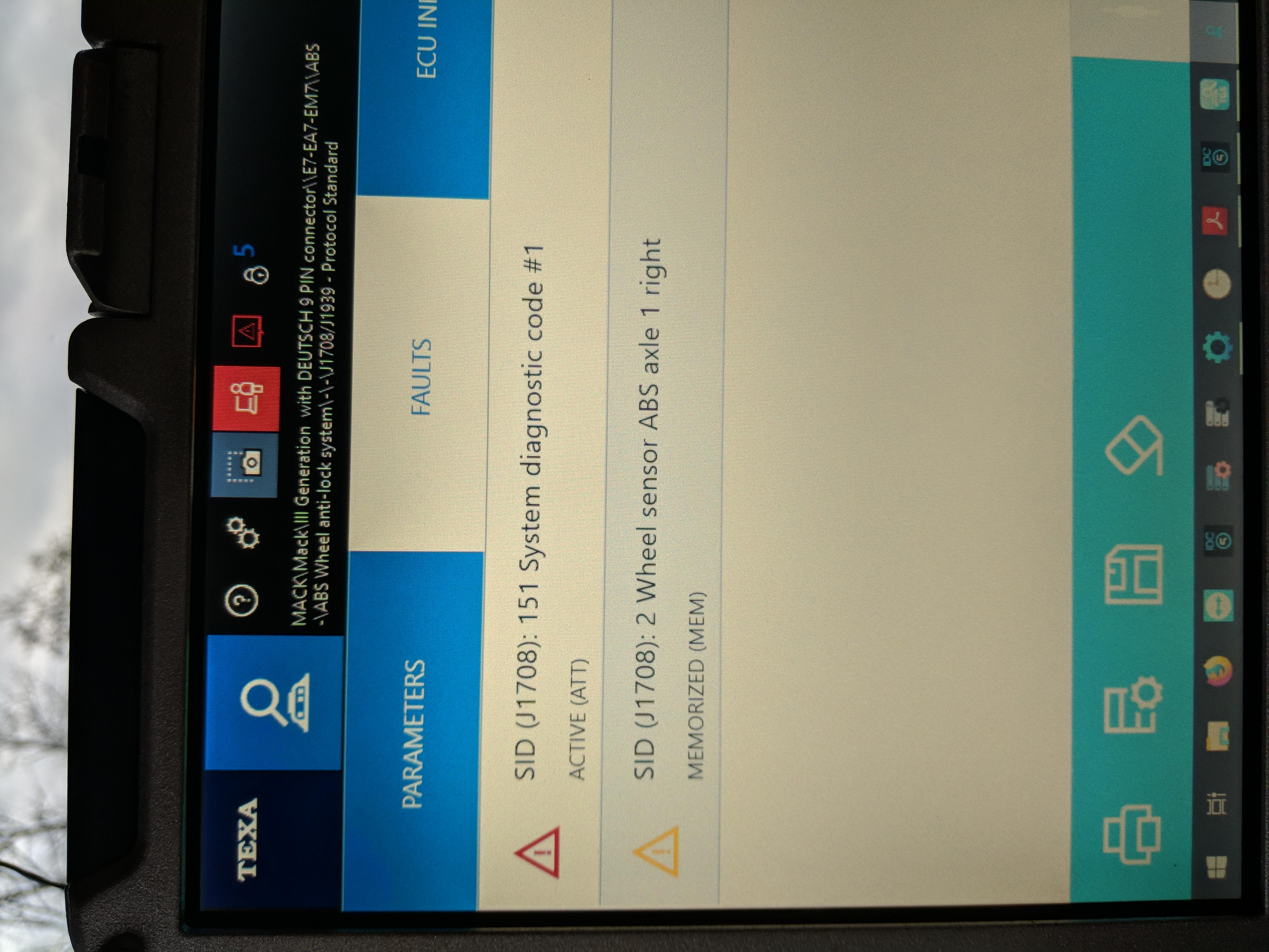

I do have abs codes. Didn't realize they could effect the engine.
SID 151 FMI 14
SID 2 FMI 14

 Good Find Pro !  How ever Curtis  not necessarily  ABS wires that rubbed on the box there  Curtis ! The wheel code would not likely dial back power However the other code you have may ?? Best thing to do is go where people are sending you here ! All of these fixes Are Real life Experiences ! Not written down in a book  anywhere Just shit people have come across over time Pro and Tech  and All the guys here  Are  awesome  At passing on experiences!  All ya got to do is give each experiance a try till ya find the one that works!

The wires that rubbed the ABS ecm were wires coming out of the VECU. No telling what wires were shorting out . Seen this issue on more ETECH trucks than I can count.
