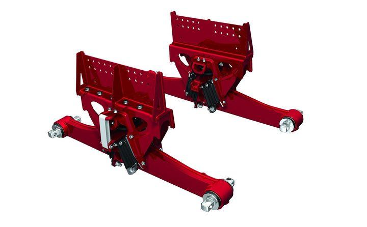

Headlining several new products introduced at Hendrickson’s Oct. 29 press conference at the North American Commercial Vehicle Show was the Haulmaax EX, which the manufacturer calls the next generation in heavy-duty rubber suspensions.
Available in capacities of 40,000, 46,000, and 52,000 pounds, Haulmaax EX is approved for a variety of vocational applications.
Due to advancements in the progressive load spring technology, the company said Haulmaax EX was designed with more vertically angled bolster springs carrying the majority of the payload in compression during the empty or lightly loaded condition, resulting in excellent ride quality.
As the load increases, ride and stability characteristics of the suspension change to meet the application’s needs without an abrupt change in suspension feel, said Hendrickson. “The superior ride translates to reduced road shock and vibration to the vehicle which contributes to longer service life of the cab, chassis and body equipment and less driver fatigue.”
In addition, to address the growing demand for rubber suspensions across all vocational applications, the Haulmaax EX suspension geometry is optimized to provide increased site rating, increased capacity ranges and improved durability.
“Customers today expect more out of their vocational suspensions and Haulmaax EX exceeds those expectations by expanding on the capabilities of the current Haulmaax design with up to a 70,000 pounds site rating for the 46,000-pound capacity suspension,” said Ashley Dudding, director of engineering for Hendrickson Truck Commercial Vehicle System. The suspension is “extremely rugged, supporting the most demanding vocational applications and offering capacities up to 52,000 pounds.”
