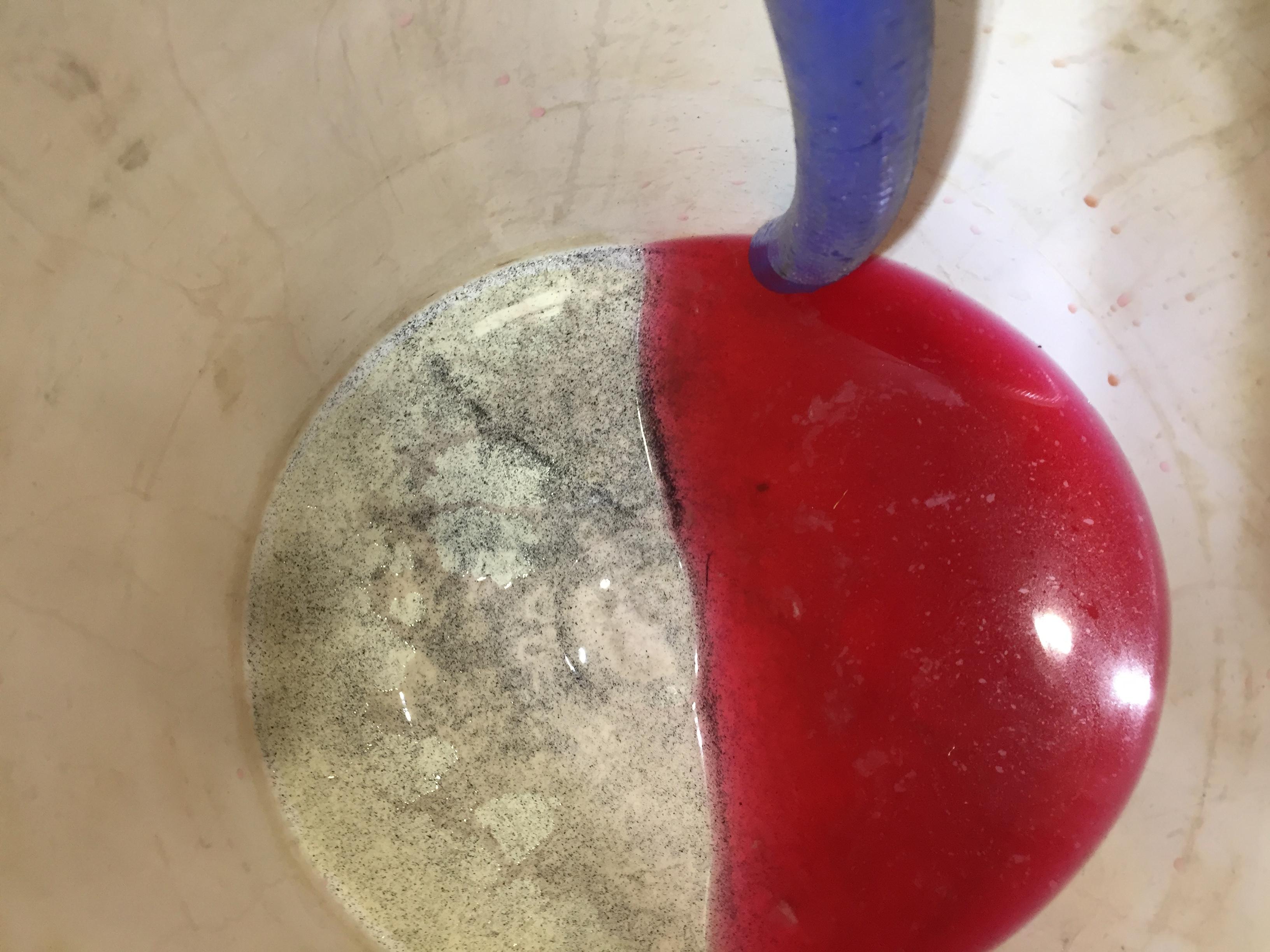

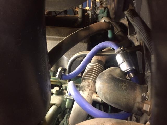

Here's the cure boys. It's not the prettiest set-up for remediation of casting sand, but you have my guarantee it works. I have a unit that plugged the heater core with casting sand twice in a month. Like some big nasty pocket of it let go inside? When your heating goes south...…….change the filter. I plan on replumbing and attaching things a bit, but this is essentially where I'm at. The filter is a non-paper, steel mesh inline strainer, NAPA #3248. The heater works fine in all settings and it was -15F down in the river valley this morning. I'm going to run it for a while, see what I capture and when it seems clean put the elbow back in or permanently move the filter closer to the cab in some straight run of factory hose.

17 hours ago, Mack Technician said:
Found out today...…………… This isn't casting sand. Its a type of welding flux that's going free-agent into the cooling system. I'm requesting more info from Volvo, if they will send the service bulletin I'll copy it over.
So is the engine assembly plant right next to the FAB SHOP COME ON! Give me a break!
