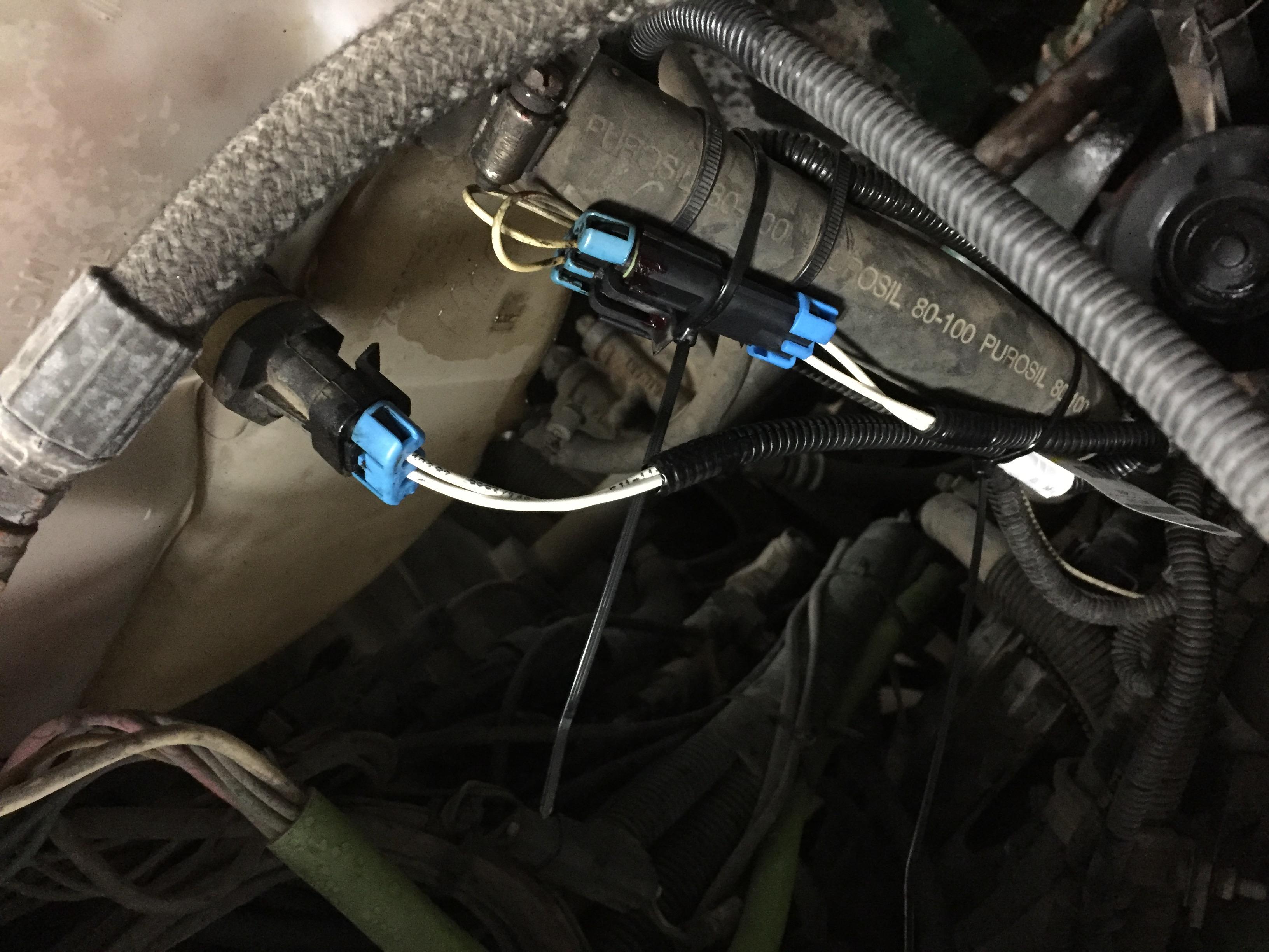

Nasty, if you don’t have your anti-capillary jumper in the coolant sensor circuit you certainly need to get that updated once you have this fixed. Just last week I found another truck without the harness. I popped the plug and it was full of coolant. In that case we caught it before it made the ECM trip.
Do you have a part number for this jumper? Or how it prevents capillary action? I need to make sure mine have it too.
Edit: Nevermind just did a quick search for anti capillary jumper and found it :) Pai 854049 Mack 20838672
Edited by ivanuke
No air space in wire strands. Bonded with epoxy. It’s stiff to bend.
I do not have an anti-capillary jumper but you can bet I will soon!  Thanks for that tip, I've never heard of such.
