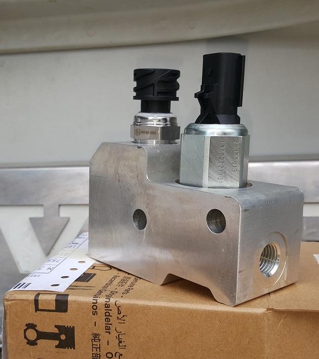

  I have also problems with regen in cold,  on my 2010 D13,  the reason i came here in my desperation looking for help.  Did you check the aftertretment shutt off valve, you should have same on 09 MP7,   only EPA 2010  has AHI . left side behind the fuel filter assembly,, it has 3 fuel lines and 2 sensors.  Not familiar with Macks, but are very similar with Volvo D13 ; this photo i found looks identical with mine, here a photo i have on my phone.
Edited by Ioan

Shouldn’t be the fuel shutoff valve. I have fuel all the way to the atom module. Is there another module, that tells the atom module to open up and let fuel into the filter? And I’m using a computer and doing a forced Regen. And i haven’t tried it for 15 minutes. I figured if it was sparking inside the filter i should have fuel too. But didn’t. I’ll do another. Forced Regen and let it do it for 15 minutes and see if it starts dosing fuel.
