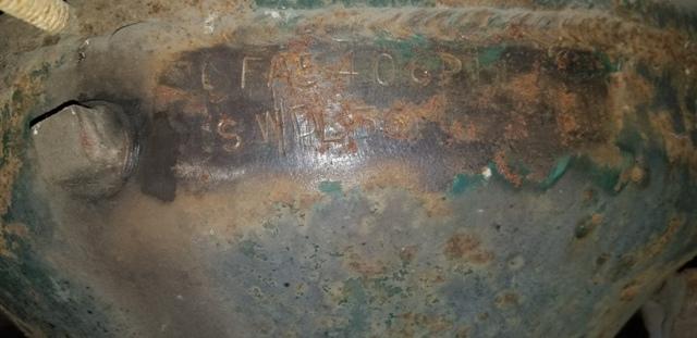

Post up your numbers which are stamped into the rear rear axle housing on the right side looking from the back. With these the suspension can be identified and drilled down to corresponding parts you are inquiring about.

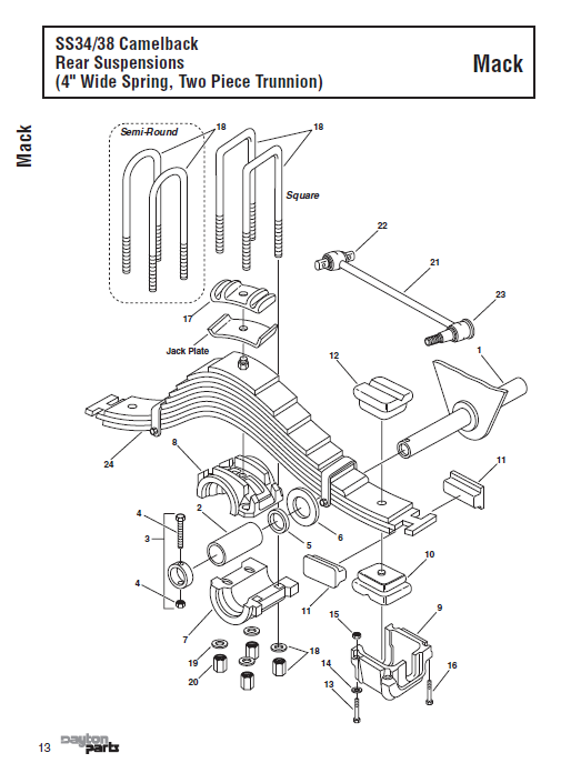

Given you've mentioned aluminum caps and I've only seen those on 34K rated rear suspensions, look at this photo and see if what you are looking for is there. If you are looking for #9 in the diagram, there are three available; 5-7/8", 6-3/8", and 6-3/4" deep. These are called "insulator boxes" and I don't know if you'll find aluminum ones new.
