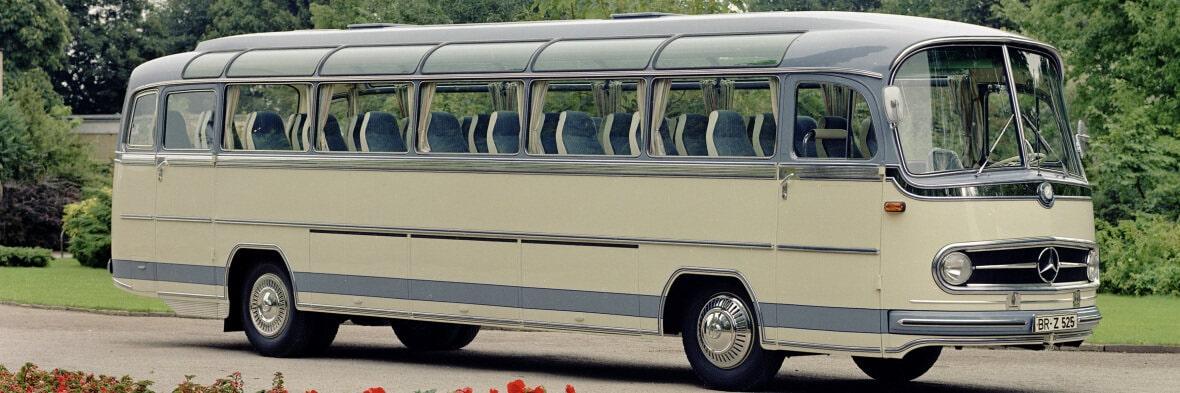

Daimler-Benz therefore adopted an innovative approach for the O 321 H. Designers devoted their attention to the design of the “Ponton” passenger cars to develop the new bus with an integrated floor assembly, a load-bearing body structure, a subframe front axle suspension with coil springs and recirculating-ball steering with dampers. So equipped, the new commercial vehicle easily met the requirements of high ride comfort and outstanding driving safety. Efficient production in the form of semi-integral construction and good product value rounded off the product offering.
The floor assembly replaced the conventional ladder-type frame construction typically used in truck building. It comprised a welded floor frame group with a robust, torsionally stiff centre carrier as the main design feature. The sidewalls were designed as tall longitudinal members. In conjunction with the steel profile framework construction and panelling, the floor assembly formed a self-supporting unit designed to integrate with the factory bodies. The closed centre carrier also doubled as a ventilation and heating duct as well as accommodated linkages, electrical cables and compressed-air lines. Moreover, this design made it possible for external body manufacturers to offer chassis assemblies together with the matching bodies.
The subframe supported the front axle construction and could be easily dismantled. Four wide rubber cushions served as connecting points to the body ─ a design feature that contributed significantly to a smooth ride and low vibration levels. The suspension fitted to the rigid front axle comprised coil springs pushed to the far corners of the vehicle, which were coupled with auxiliary springs and large telescoping shocks. Two transverse control arms aligned in parallel to the front axle beam absorbed cornering forces. A triangular strut channelled longitudinal and braking forces away from the front axle. The rear axle, which was fitted with leaf springs, integrated a robust torsion stabiliser bar.

The ball-and-nut steering system with damper assembly was “very smooth and almost entirely free of vibrations for such a large vehicle”, as commented by German trade magazine “Lastauto und Omnibus” in its 4/1955 issue. This, in conjunction with the large steering angle, gave the O 321 H an astounding level of agility. Its turning circle was a mere 16 metres! This was very beneficial during daily driving as the bus could easily navigate through tight city streets. And on long-distance runs, the bus was capable of traversing alpine roads with numerous hairpin bends ─ such as the Stelvio Pass ─ without having to back up.
An outward indicator of its modern design was the appearance of the O 321 H. By leveraging the look of the front end, Hermann Ahrens lent the bus an air of the 190 SL and 300 SL, thereby making it the trendsetter for the design language of commercial vehicles to come. Also, as the export delivery ratio of the bus was unusually high at around 50 percent, this design became a familiar “face” for many different people spread out over multiple continents. The bus was shipped to no fewer than 63 countries, with leading customers in Iran, the United Arab Republic, Turkey, Austria, Saudi Arabia and Argentina.

The design concept of the O 321 H impressed professional fleet operators around the world. It was available not only as a city bus with folding doors at the front and back (DM 45,000), but also as an intercity bus with hinged doors (DM 43,700) and a long-distance bus (DM 44,800). On the long-distance bus variant, roof edge glazing really opened up the interior in terms of space and light, and a sunroof option was also available! The OM 321 diesel engine rated to 81 kW (110 hp), which had a displacement of 5.1 litres from a six-cylinder block, was good for a top speed of 95 km/h. By way of comparison, at the time, the Mercedes-Benz 180 passenger car model reached no more than 126 km/h and the 180 D just 112 km/h.
