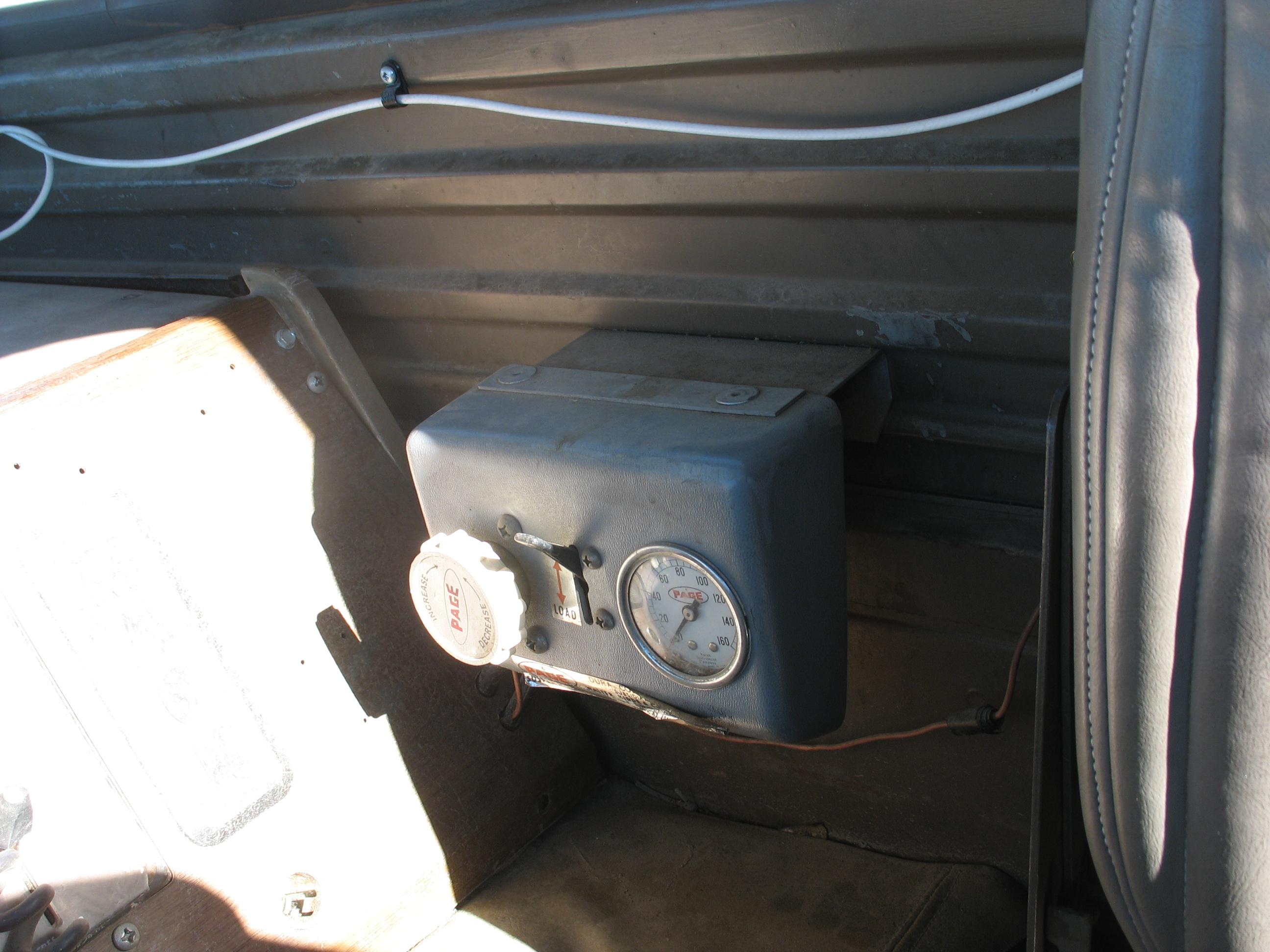

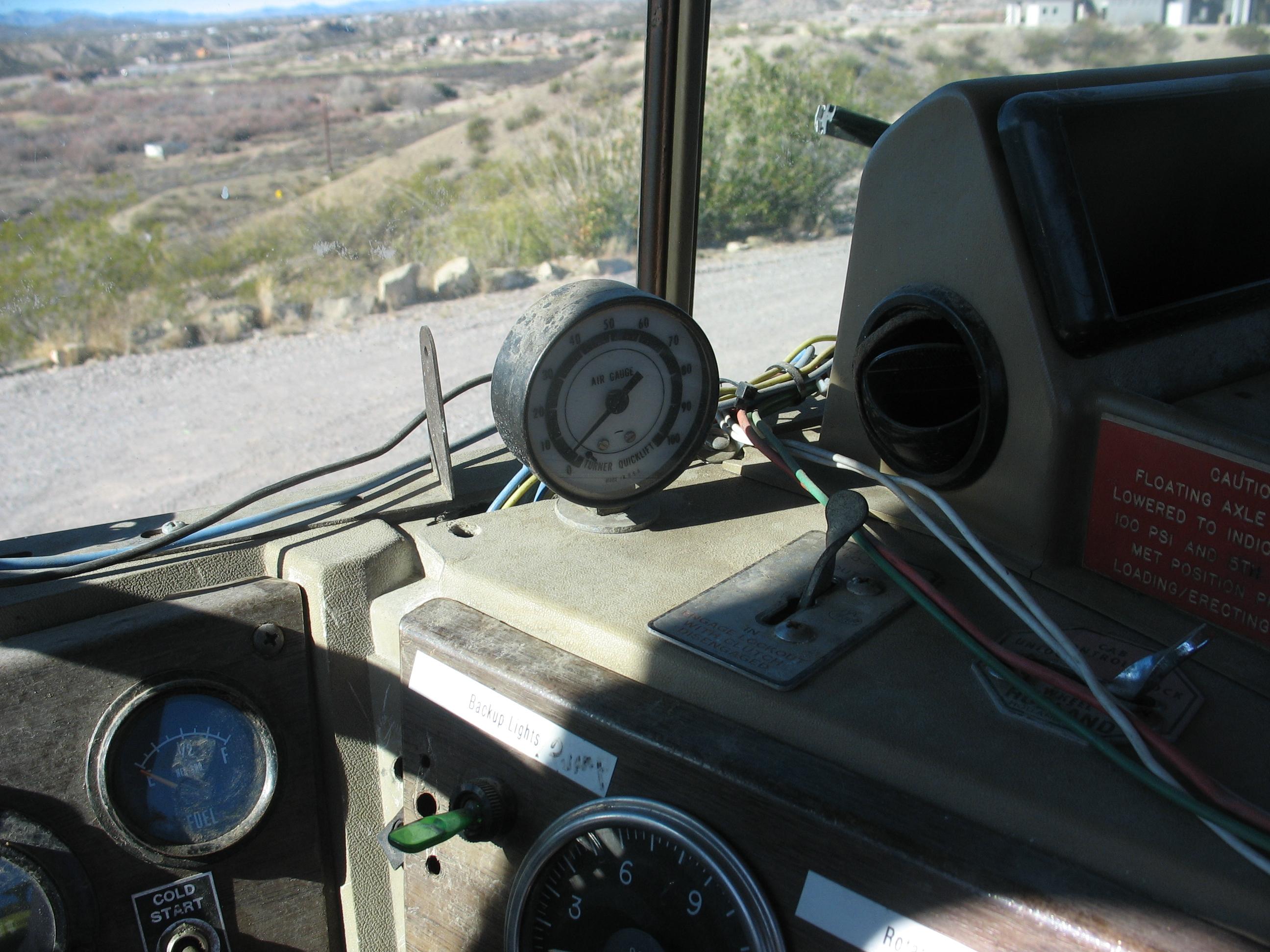

The Page box looks like that's your lift axle control. Knob is the regulator to adjust pressure to the lift axle bags. Gauge on top of the dash could be for brake application pressure.  See if it rises when you hit the brakes. Kind of a useless gauge, I've seen Pete's with brake gauges. Either you have enough pressure to stop or you don't and you need to push the pedal harder. Don't need a gauge to tell you that!
https://www.bigmacktrucks.com/topic/60180-f-797-st/#findComment-438008

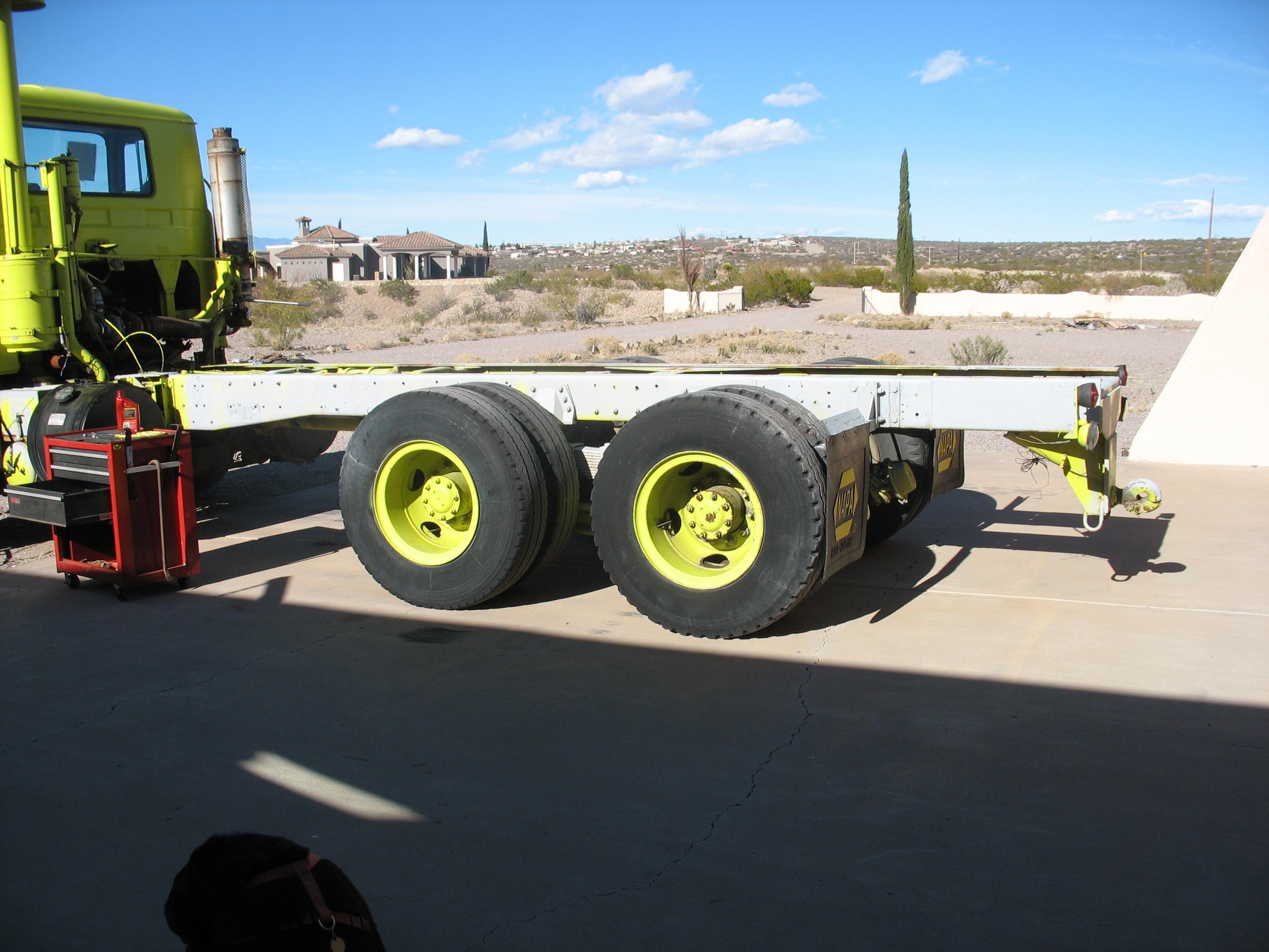

Thanks all. I got almost 80 pages of build sheets from the Mack Museum. Hendrickson  RT 440 suspension  Eaton 44 RTC two speed tandem axles with no mention of a lift axle. Someone must have added a lift axle. Maybe the military. I thought it would have been ordered that way. There is a switch in the cab for a Holland fifth wheel. I think JoheH is correct on the air gauge for the brakes. The wires going to thru the backing plates is still a question.

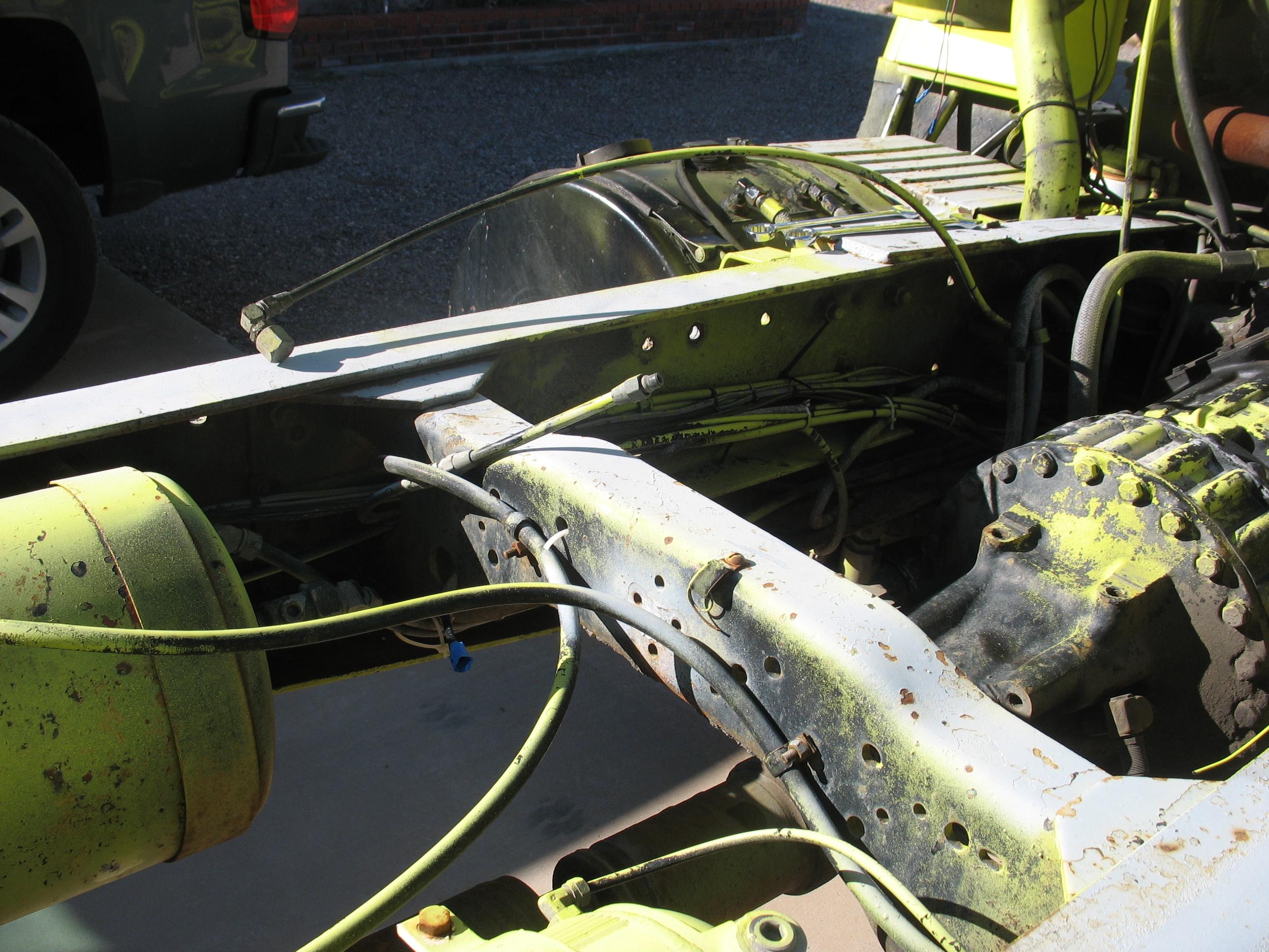

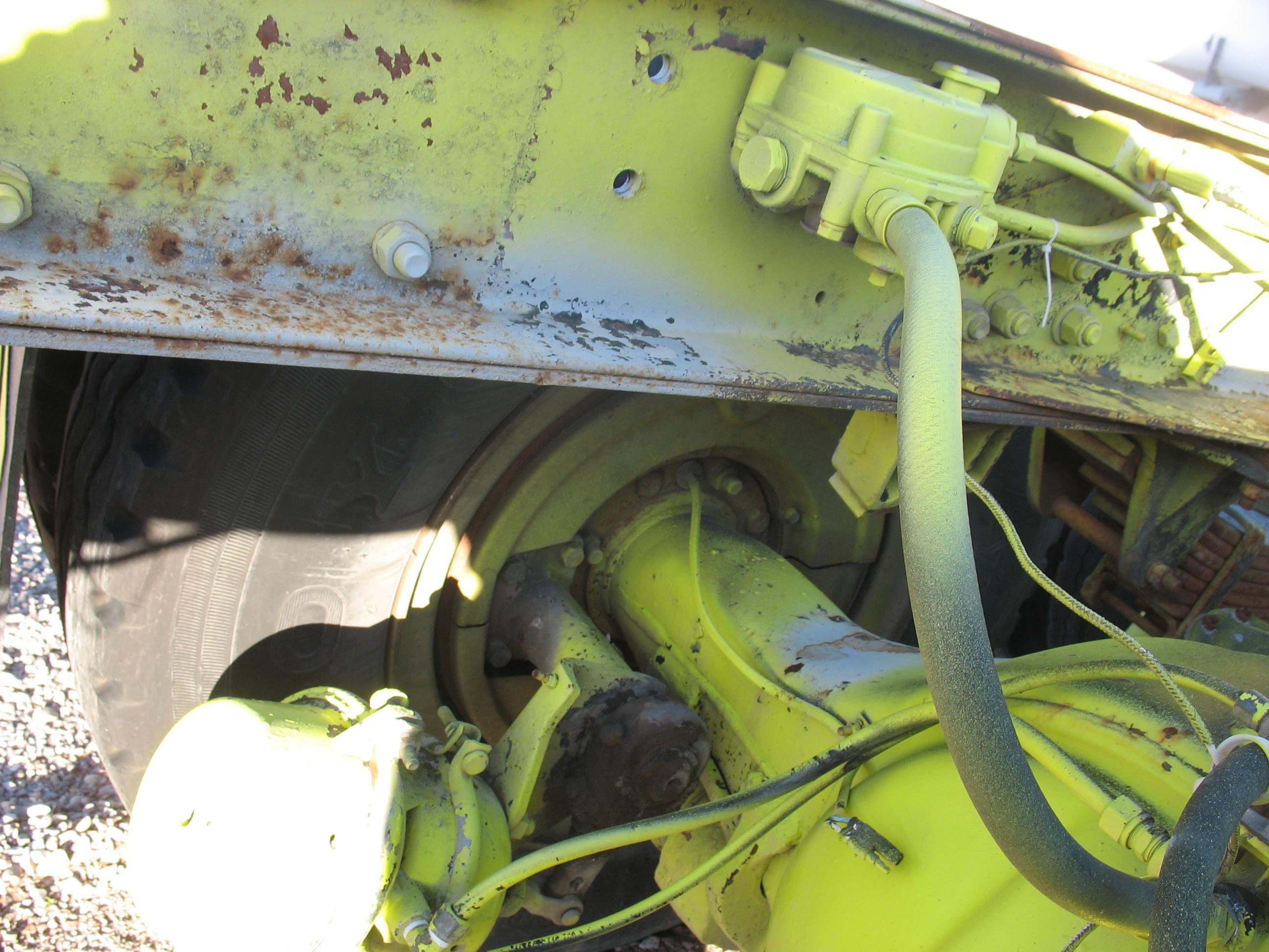

FMVSS 121 ordered the installation of ABS in the mid 1970's. It was allowed to be disconnected as it was SO troublesome. That is what your wires are for to connect to a hall effect pickup reading a "tone ring" which spins with wheel rotation. The tone ring could be called a "reluctor", (same thing different name).
https://www.bigmacktrucks.com/topic/60180-f-797-st/#findComment-438019

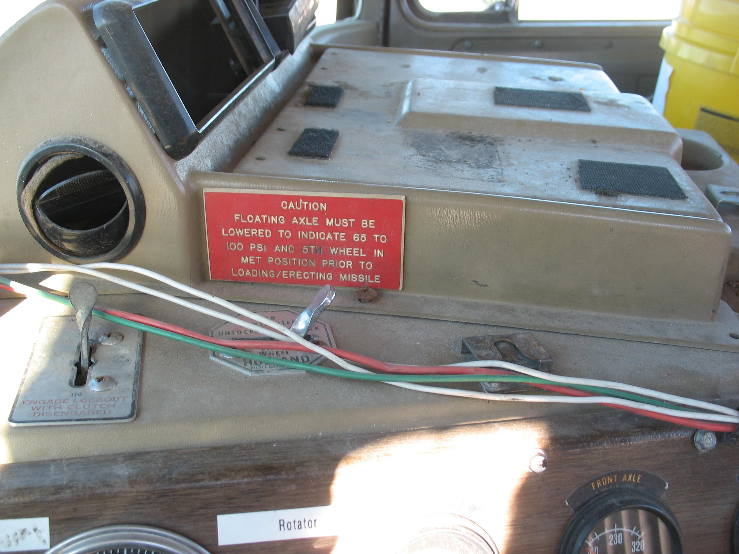

The face of the air gauge says turner quick lift.
Turner and page merged at some point so that gauge may be related to the lift axle.
I do agree that the wires going to the brakes are probably for an early abs system. It seem to remember that the early abs was a POS and commonly disabled or removed.
I think there is the remains of an ABS system on the military dolly in my storage yard
The wire goes into the flange the holds the brake spider to the axle housing
The sheet metal covers, held on by the small bolts, are really just dust covers.
We remove the dust covers and leave them off so that junk does not get trapped in there and you can easily tell if an axle seal is leaking

I'm wondering if the lift axle switch is for a trailer lift axle. But that's unusual to have the switch in the cab. It's an extra hose requiring hookup.

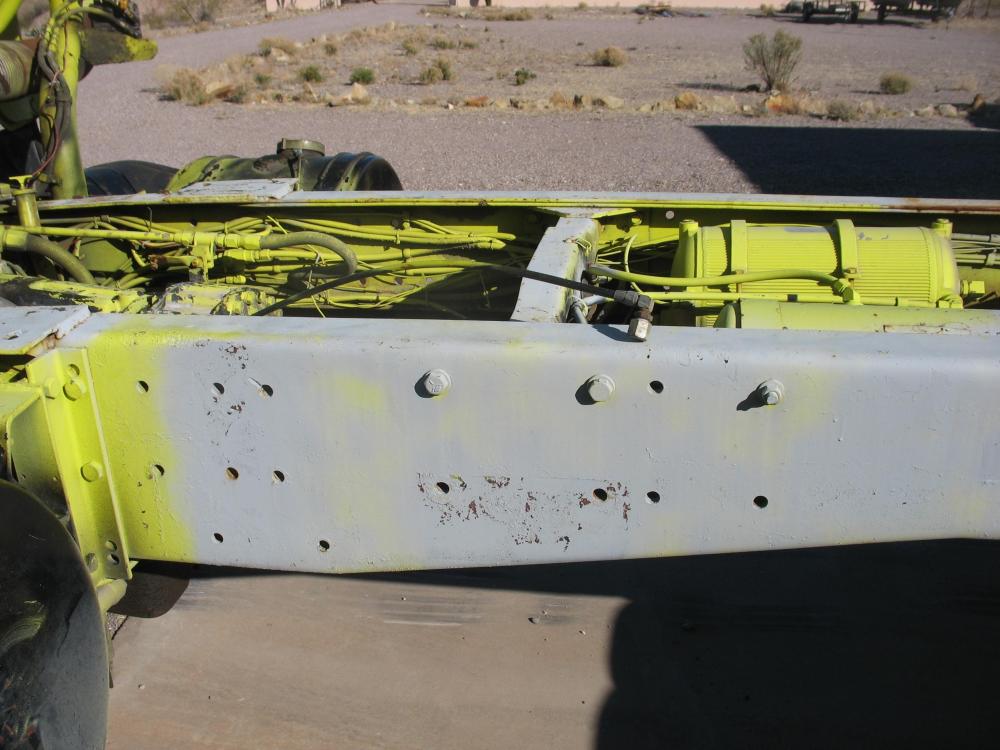

You could look to see if there are any extra air lines in the frame ahead of or behind the tandems
https://www.bigmacktrucks.com/topic/60180-f-797-st/#findComment-438059
My water wagon has much the same setup for the Neway "tag" axle. It is air down, spring up, with a regulator and gauge to set applied pressure on this axle:
I don't have a photo of the dash indicator readily available but have found about 65psi, (indicated) when the truck is loaded is about even weight on all three axles when it is down.
https://www.bigmacktrucks.com/topic/60180-f-797-st/#findComment-438078
Two lines in front of the tandems. The one with the cap has no air with cap removed. The other has air with the switch in the cab. Both gauges read the same. The holes in the frame must have been for mounting the lift axle . Now I know more than I did. Have been working to get the cab to lift . The latches open but the cab only goes about an inch. Thanks for the help.
