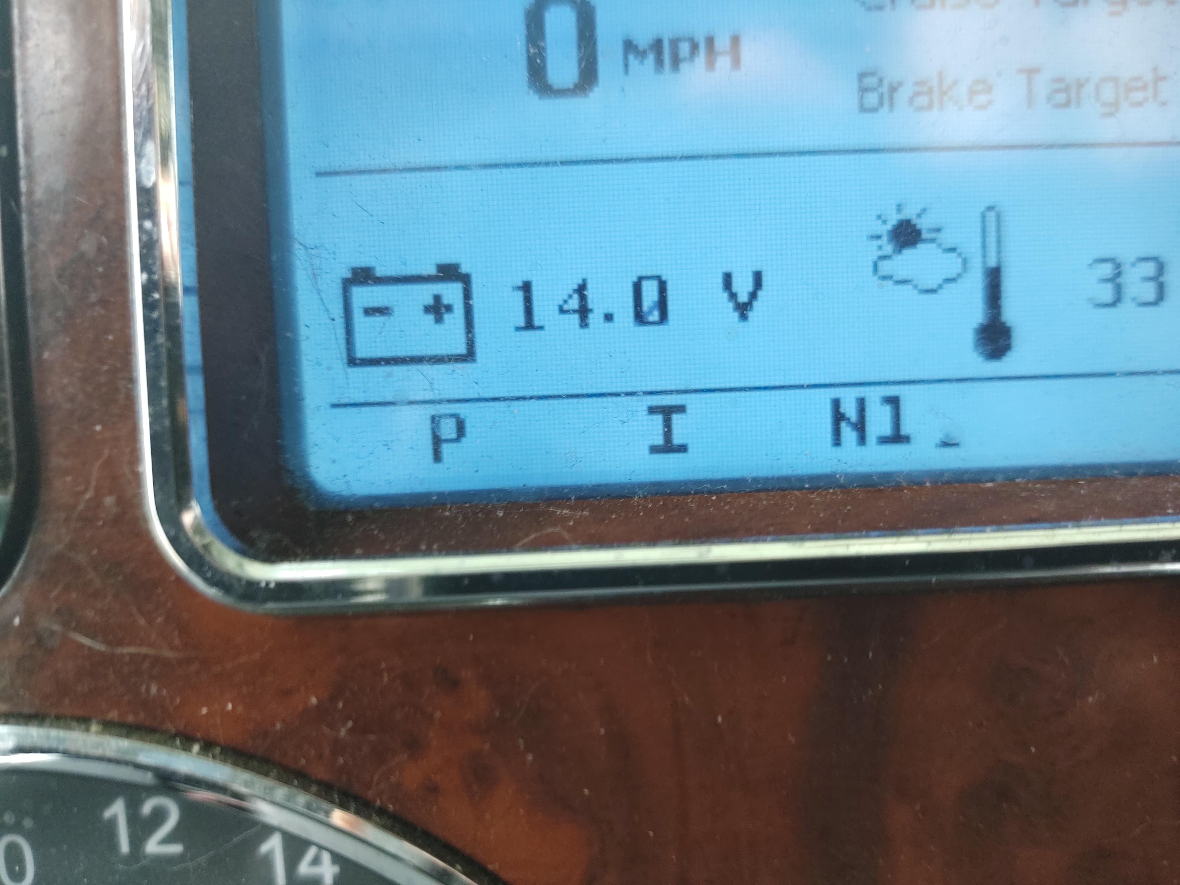

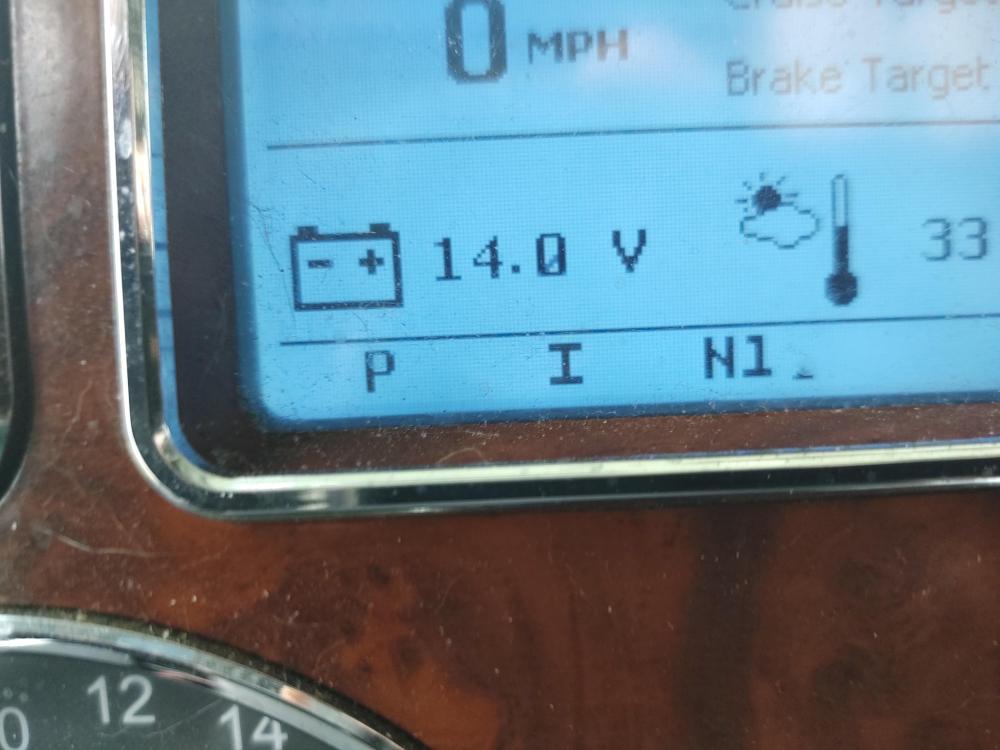

I got a 17 Mack pinnacle cxu 613, mp8 engine, automatic. It's got the guard dog system and I've scoured the manual. I got the letter P on my dashboard (in the bonus/penalty area) and I cannot figure out what it means, what caused it, how to get rid of it, or why it decreased my speed. Help is much appreciated

I believe that is the Power Leash Indicator.  Look up Power Leash in the operators manual.

Looks like the Fuel MPG performance bonus/penalty has been set up to lower the road speed if a certain MPG is not achieved.  These are parameters that can be turned off or adjusted by Tech Tool. Our company ordered all our CXU’s with this turned on , we later turned this off due to the amount out idle time and PTO time and stop and go driving , we could rarely get 4 mpg.
