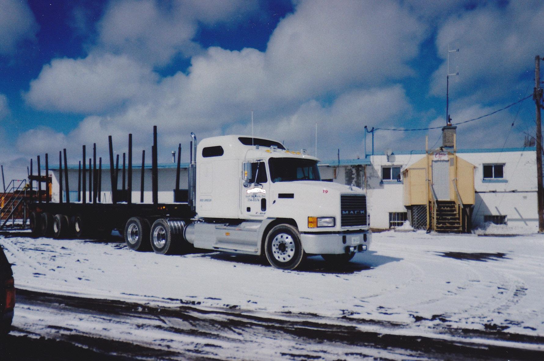

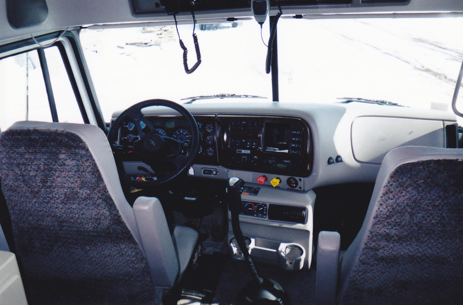

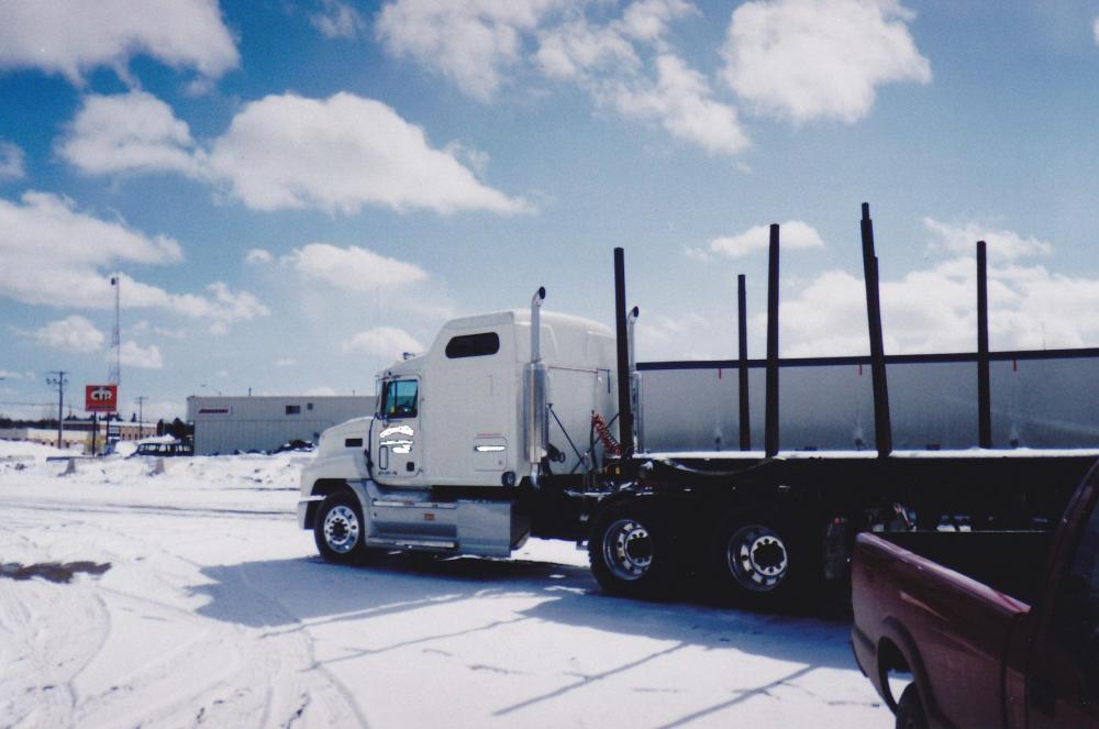

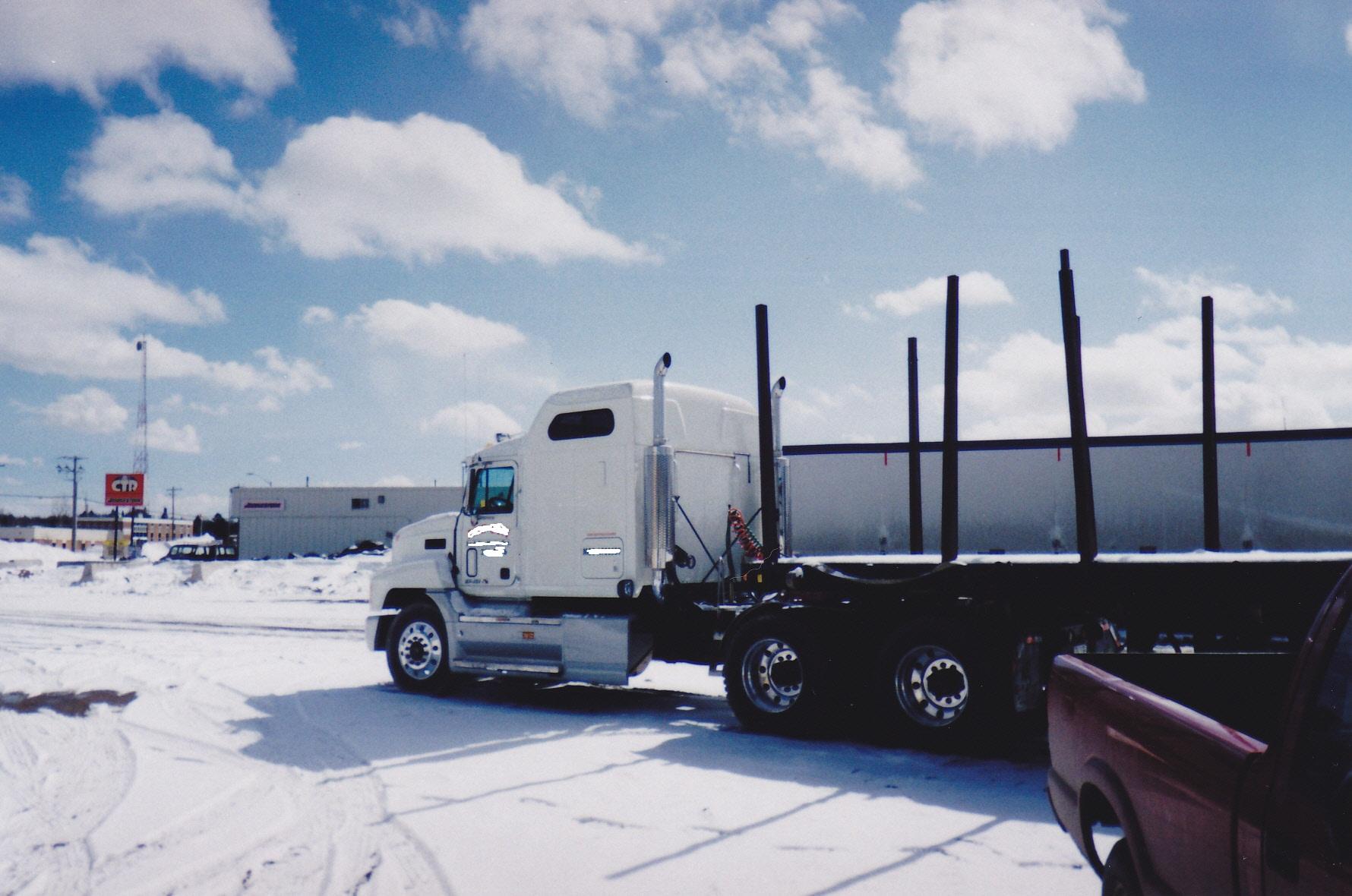

I have driven a lot of heavy spec CL's but here is my old 2000 CH. It was double frame, 14,000 front, 46,000 Eaton rears on Mack air leaf. E7 460 with an Eaton 18 speed.
One of the smoothest riding and best handling trucks I have ever driven. Also the best factory headlights I ever had. Never even had a need to use the extra 100W auxiliary lights.
It just inspired confidence driving it. No matter if it was white outs or freezing rain, it never did anything that made you feel uneasy.

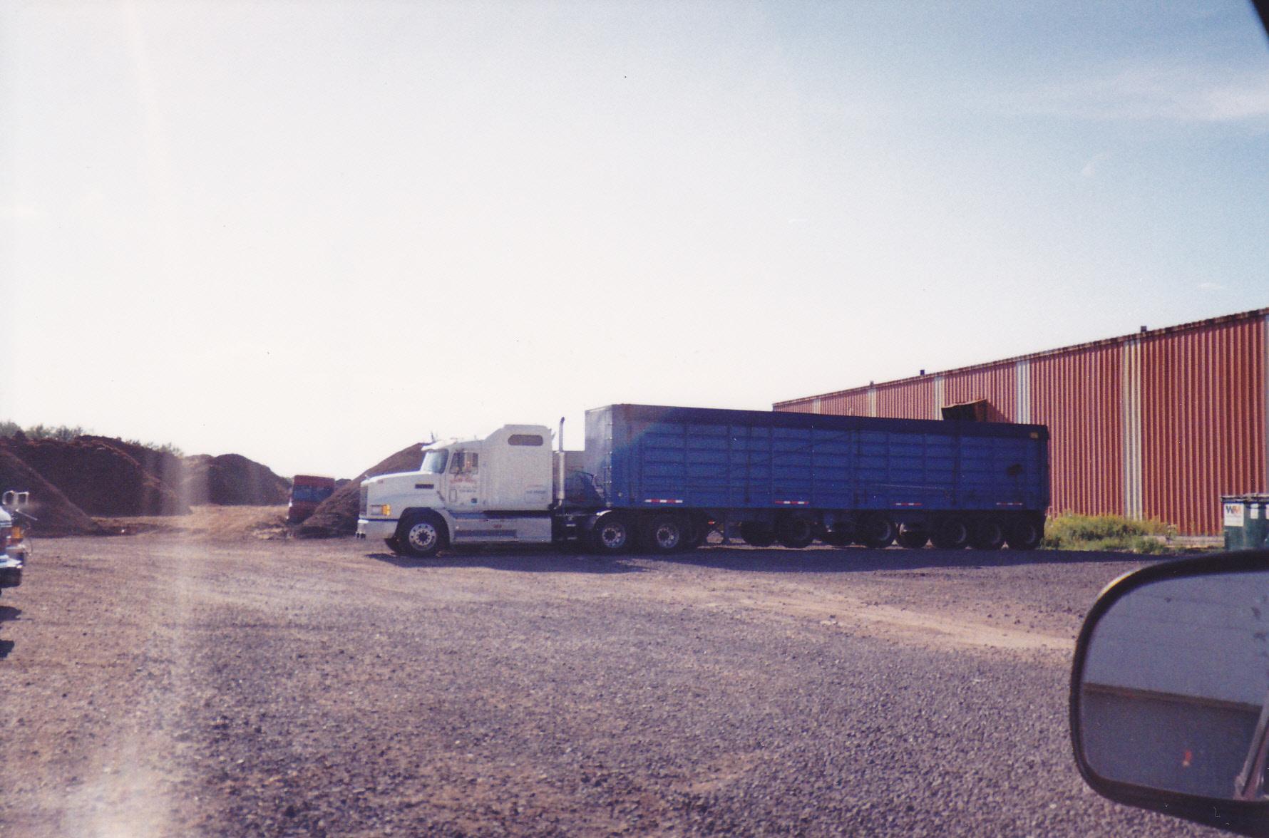

That truck sure worked good. Used to haul bark and logs with it. It was like a bulldozer. I had the temp sensors ripped right off the diff pots and it never got stuck. I can't explain it, but that truck just worked better than most I have had.
The downfall.....the E7 full of casting sand and electronics gremlins. When it decided to run though it pulled good. I ran with guys that had same loads and trailers and they had Series 60 500's and 475 Cat's. Yes they could pass me on the hills, but I could keep them in sight.
