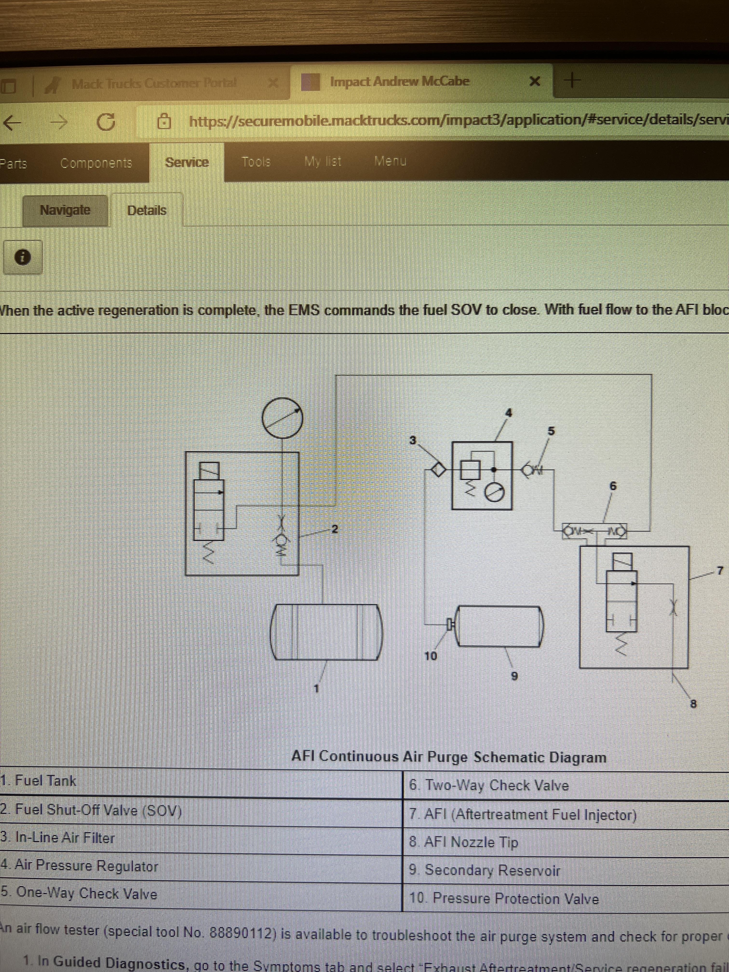

They called back and asked me to disable the 7th module’s air PSI supply. I think there are reading this thread?
Its  Possible I guess ? THE Experience Based Reasoning Site ! 😂 Wish more people would share there experiences with this shit  Here!  You talk to some of them E  service guys they treat you like dirt Sometimes!
We're Just trying to get stuff fixed for people! And sometimes Just got to work off Rumors and other peoples experiences how ever far out there they may seem !
When I joined this site I had hoped that we could talk discreetly  on the  Dealer  Tech forum ! But no one seemed interested In sharing info ! So Its all out in the open  on the regular forums which is fine also, People deserve to know what they bought into I guess!
