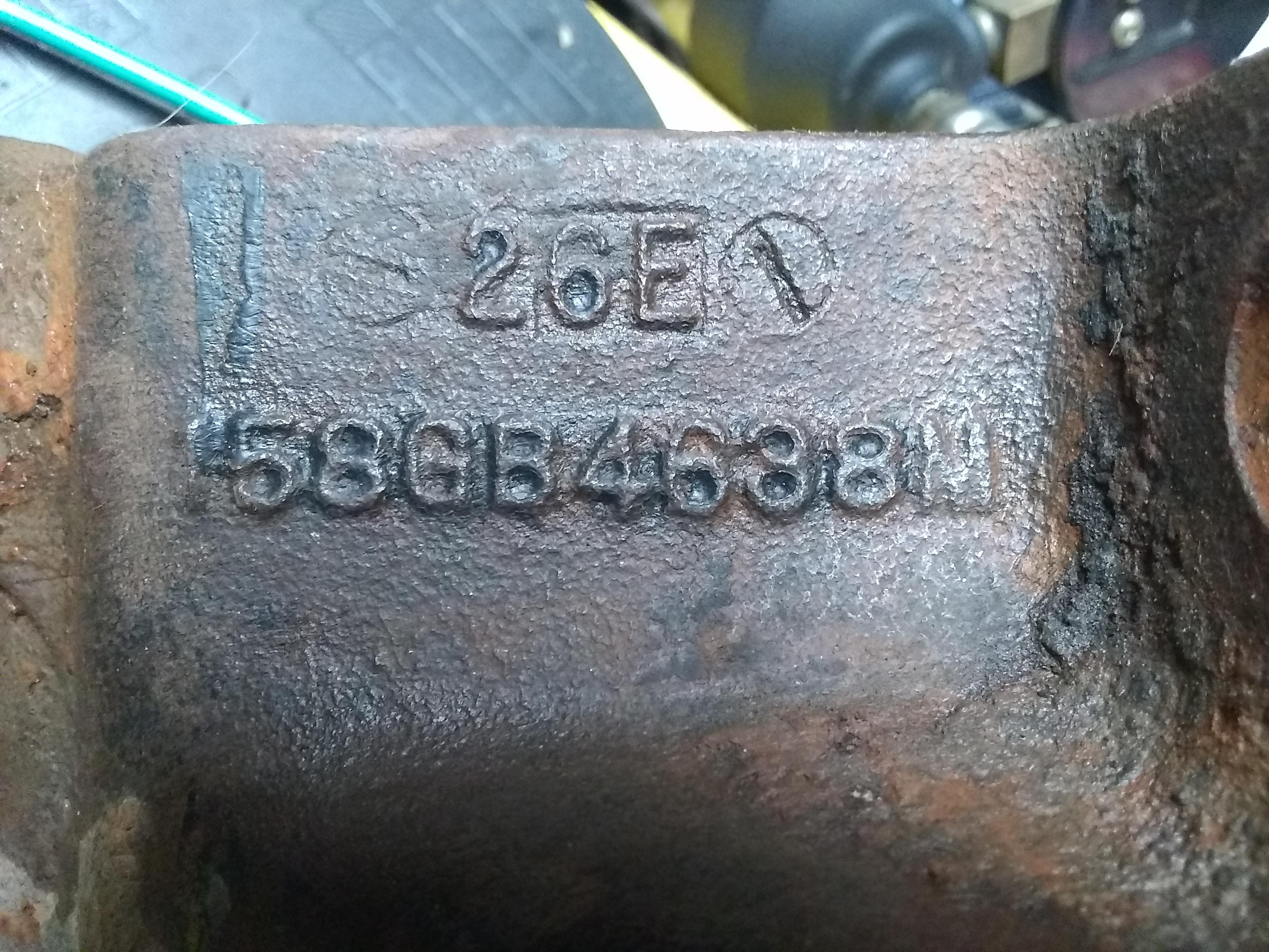

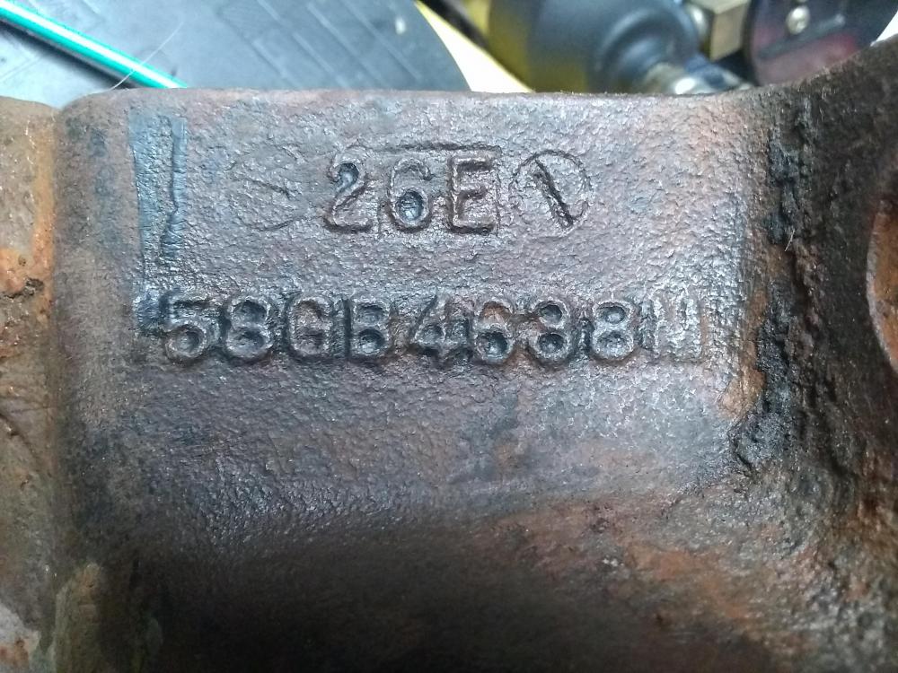

Best I can tell these mounts are going to position the engine just about the 5/8" forward that was mentioned in a previous post. It would save me a whole day and probably $200 in material to fab mounts. It's springtime,  I have dumped a shit ton of money in that old girl last year getting her ready for some big jobs coming up. She needs to go to work badly. I have two more just like her I need to get done.
No harm in trying. I know what I build will work but don't have a lot of time for trial and error. This is not an R&D project so attempting to help you. If you got the time then you should go with your "gut" feeling. Nobody on the internet is going to solve your problem using incorrect (by part number) items for the application; only you can do that with your ingenuity and persistence.
I realize they are not the right parts. I am 99% sure they will work though. I wouldn't try them if I wasn't sure. The only problem I might have is that they are not long enough to account for the extra width of a west coast frame. I can fix that with some spacers between the mount and the trans if I need to.
