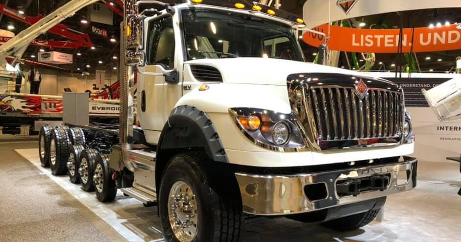

International shows new options at World of Concrete 2020
International Trucks is showcasing several vehicles from its vocational lineup this week at World of Concrete, including an International #HVSeries featuring the Hendrickson HAULMAAX EX suspension.
#WOC2020 https://bit.ly/373PIFw
Lots of people don't like these Workstar/HV's, but my friend  has a couple and he got me to drive one back to town for him one time. A dump truck with 20 and 46 axles on rubber block. It rode really nice and was comfortable. His are Cummins powered.
They got a really bad rep because of the original Maxxforce engines. And underhood space is bad. I'll say it again though, the new HX is the smoothest, quietest new truck I have ever driven. And I've tried all the north American trucks.

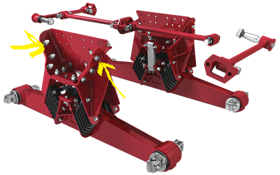

I also liked the Haulmaax rear suspension. I had that in my 05 Paystar. Lots of articulation and traction and a good ride. (Though Chalmers was still a bit better.)
Only problems I had with it were these bolts kept coming loose. Once I replaced them with good frame bolts, never touched them again.
