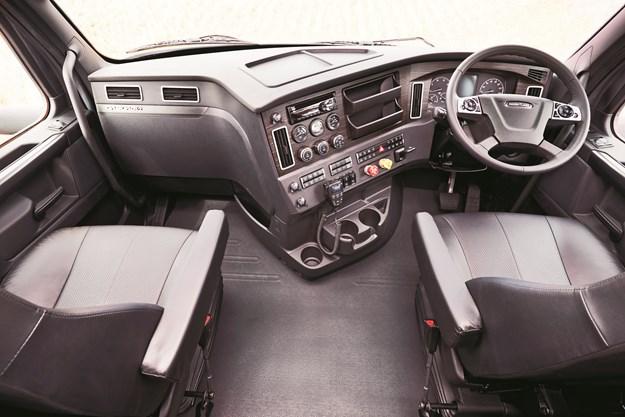

Cab and sleeper
Cascadia uses an aluminium cab shell and high-tensile steel doors, with Freightliner insiders here and in the US emphasising vast improvements in manufacturing processes and quality standards.
There’s a strong family resemblance to the current Mercedes-Benz range in the dash and gauge layout, with controls and switchgear placed for easy use and familiarity.
The standard dash trim is described as ‘subtle black with black bezels, while chrome bezels are available as is a woodgrain trim option.’ Standard seat trims include Laredo leather as well as vinyl or cloth options.

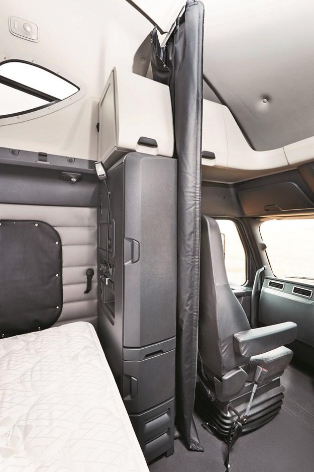

Cascadia comes as a day cab or 36-inch (91cm), 48-inch (122cm), 60-inch (152cm), and 60-inch raised roof sleeper cabs. Internal features include a sleeper area with dimmable LED lighting, a range of sturdy cabinets, microwave bracing, space for a fridge and a strong flat-panel TV swivel bracket that can hold up to a 26-inch (66cm) screen.
Single and double bunk options are available and all Cascadia sleepers are equipped with locally-sourced Sealy Posturepedic innerspring mattresses measuring 30 inches (76cm) across for 36-inch sleeper models and 35-inches (89cm) across for 48- and 60-inch sleepers.
Sleeper vents are available, as are sleeper doors with built-in windows on 48- and 60-inch models. There is also a right-hand baggage door on all sleepers, while the 60-inch is also available with an additional left-hand baggage door.
Freightliner is also introducing a battery powered HVAC climate control system as an option on all sleeper cabs. Powered by a condenser on the back of the cab, it is linked to four additional batteries and offers up to 10 hours of cooling and 34 hours of heating.
