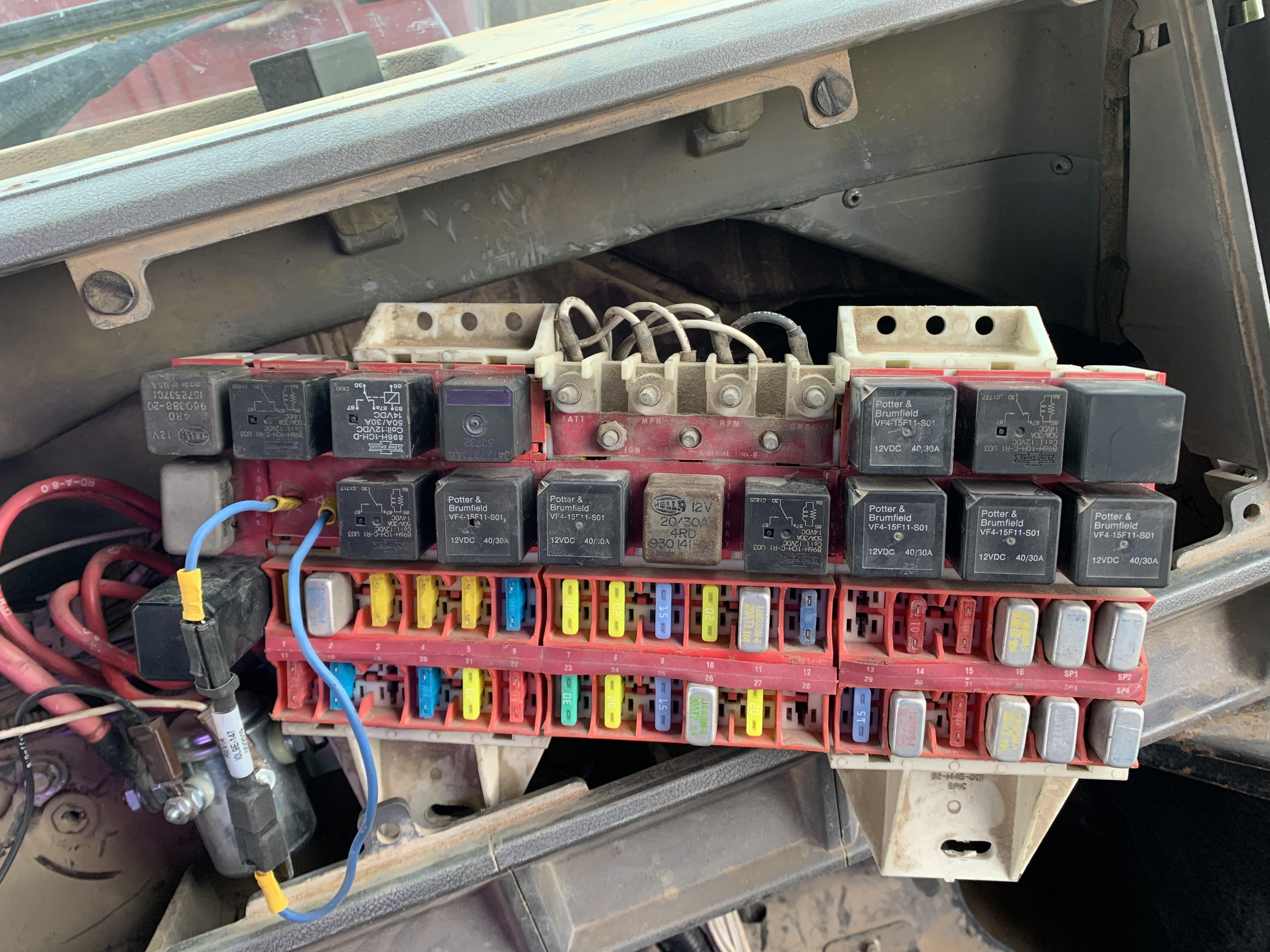

I have a 1994 Mack CH613 E7 350 and I am currently having problems with it the truck one day shut off while running and started off again it did it a second time and didn't start anymore. They said Fuel pump was bad had injection pump rebuild and would only stay on with starting fluid solenoid near the windshield motor was replace the engine was time again and so was the pump no diesel is going up to the injector lines. There is no current to the pump harness. I don't currently have any fuse diagram I dont know if the VMac ecm are bad which one is the one that sends signal to the fuel pump? Thank You all so much in advance

The silver solenoid in the lower left of your fuse panel have you checked it? I have a 95 Mack, sometimes it would crank and not start-that big solenoid is what powers the ECM, If you turn the key on and dont here the big click inside the dash-check that. Also check the wiring for bad connections, these older trucks there is no telling what it could be. I chased headlights not working for weeks, then finally pulled apart some connectors under the dash for the harness, cleaned the terminals and good to go.. Good luck and let us know what the fix is if you figure it out.
