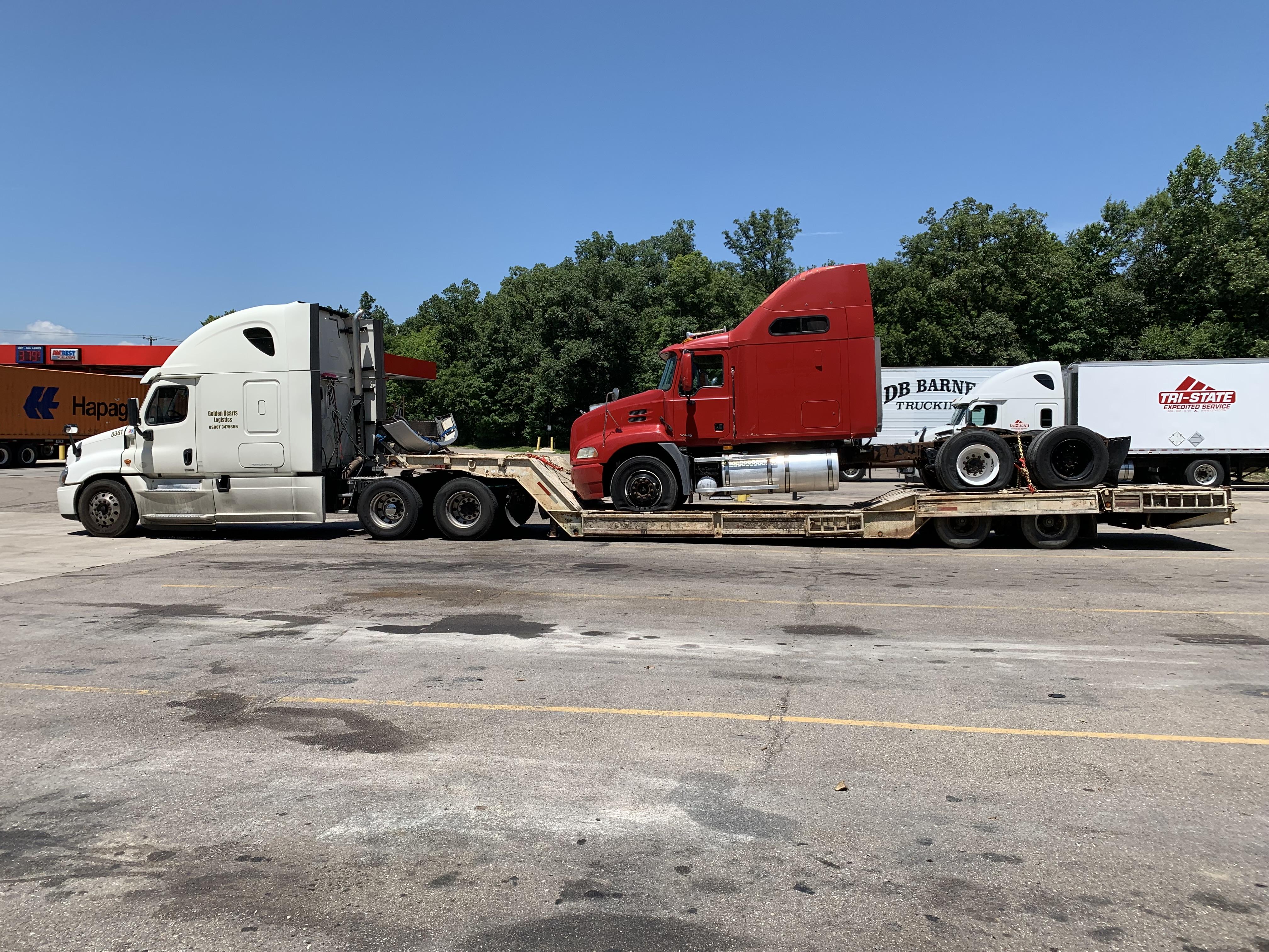

The truck is a 2005 Mack sleeper last 8
5N001649. Mack dealer says it needs #1 and #2 EPUS and EGR cleaned. It sputters kinda like water in fuel feeling. I’m not knowledgeable on engine repair but I can follow a manual. I bought the truck 2 years ago for $13,500 . It did fine with light loads in warm weather and flat surfaces but anything above 30,000 pounds was a problem. I’m going to set it up as a service truck/ salvage truck and equipment pulling a 1975 lowboy with a hydraulic dovetail. Also trying to decide if I should put a wet kit on it.this is the truck on the lowboy
