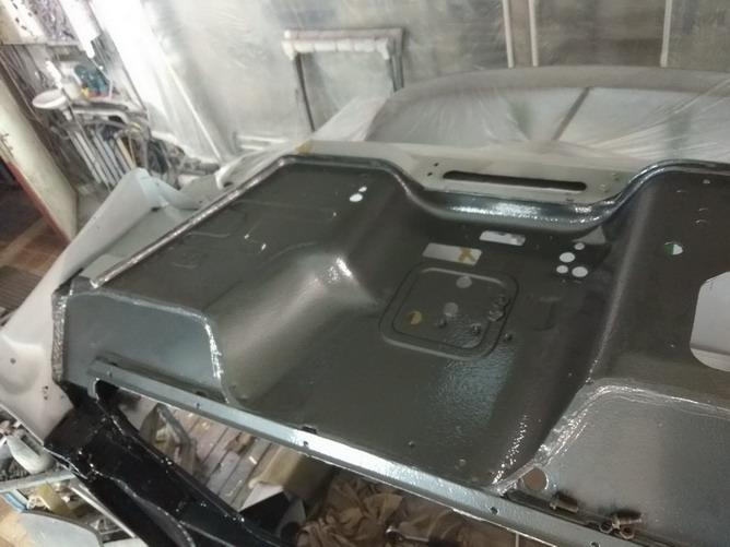

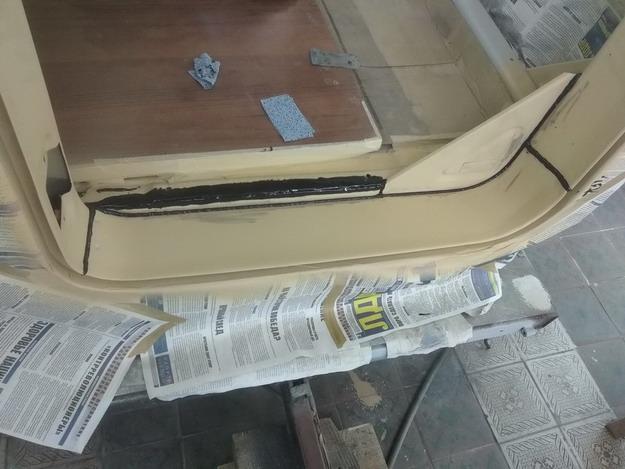

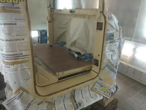

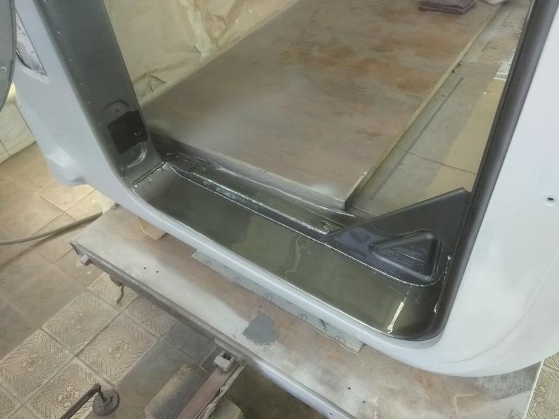

A bit of update.

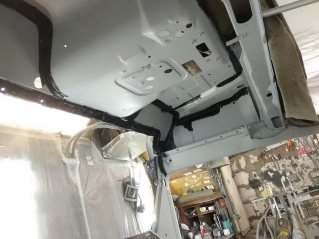

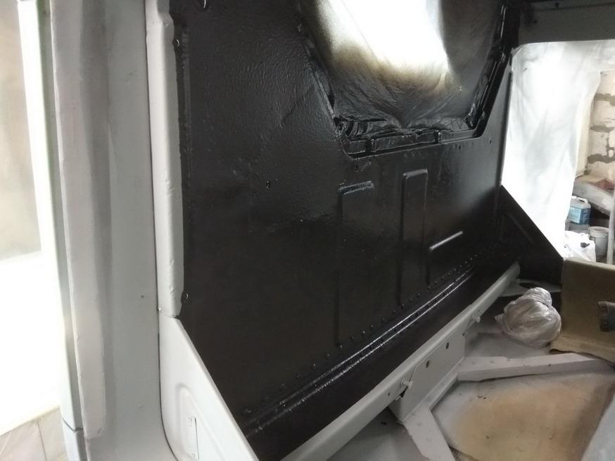

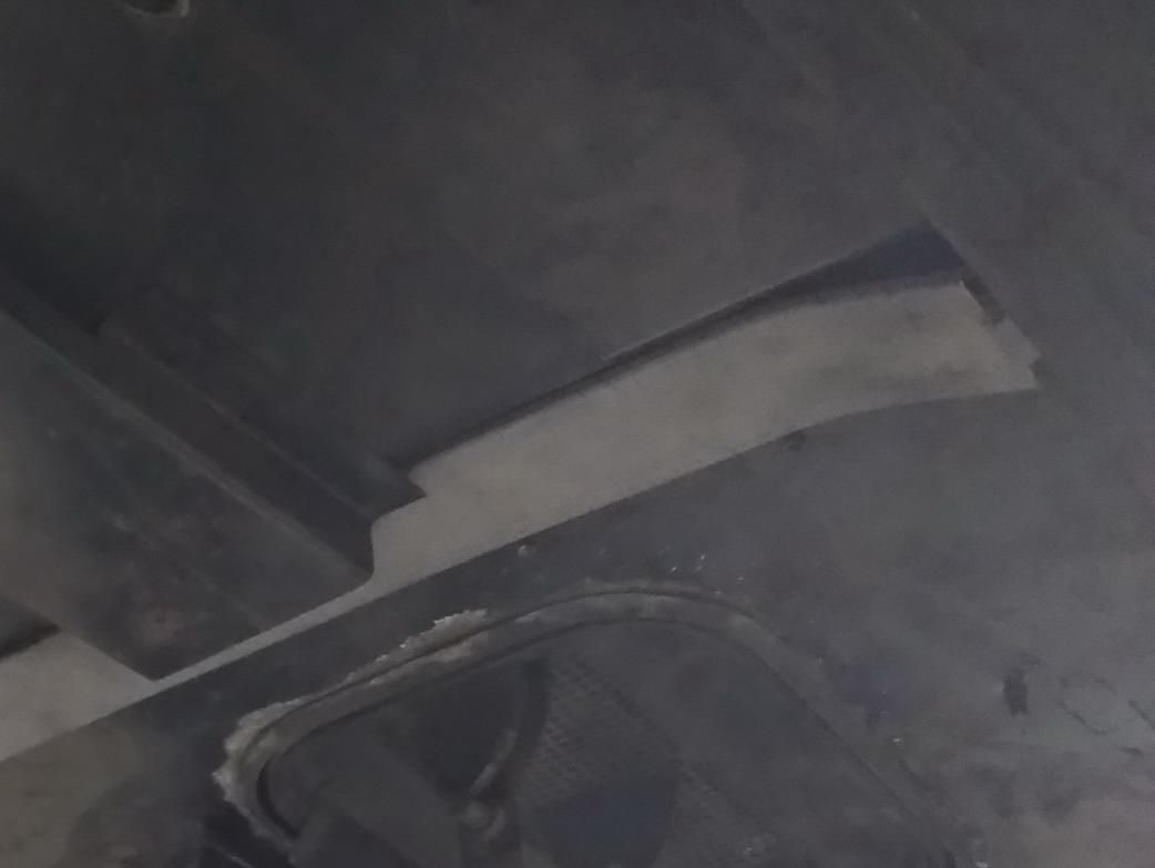

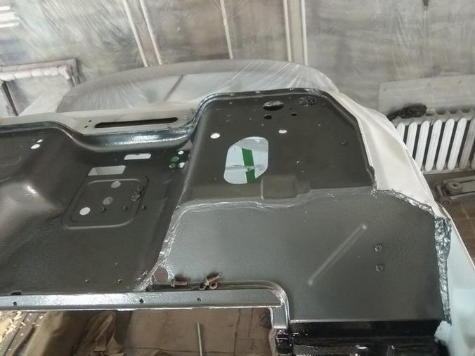

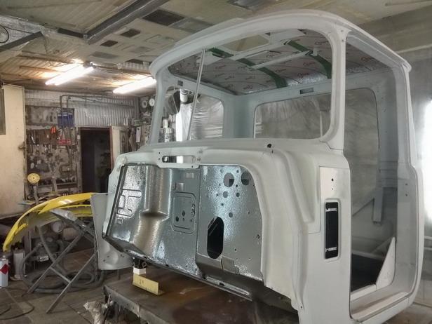

The cowl lower reinforcing plank installed, panel seams covered with polyurethane sealer, the inner side of the floor sprayed with sealer and painted black.

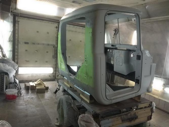

The engine side of the firewall covered with spray sealer and painted grey metallic as it was from the factory. To be true factory paint was matt but I made it gloss. Looks good on my mind and seems easier to remove dust or dirt.

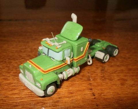

Smaller scale is easier to move around.
Wow! That's funny. i never knew the guy shared his tiny scale sculptures on the net. Seems not difficult to figure out which truck he used as an origin to built the model.

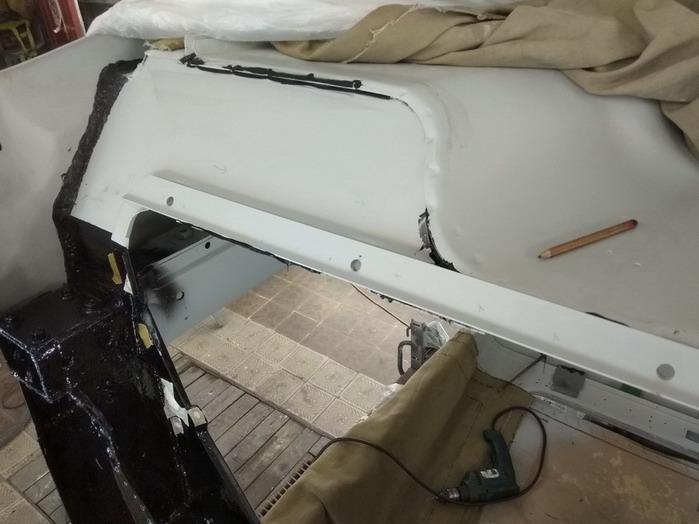

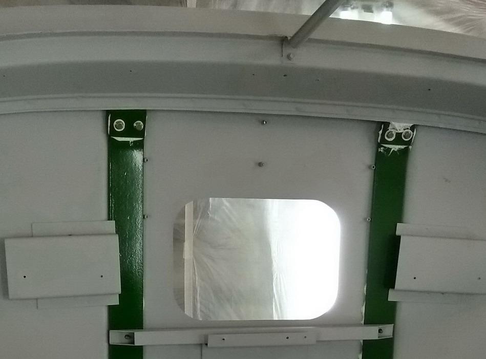

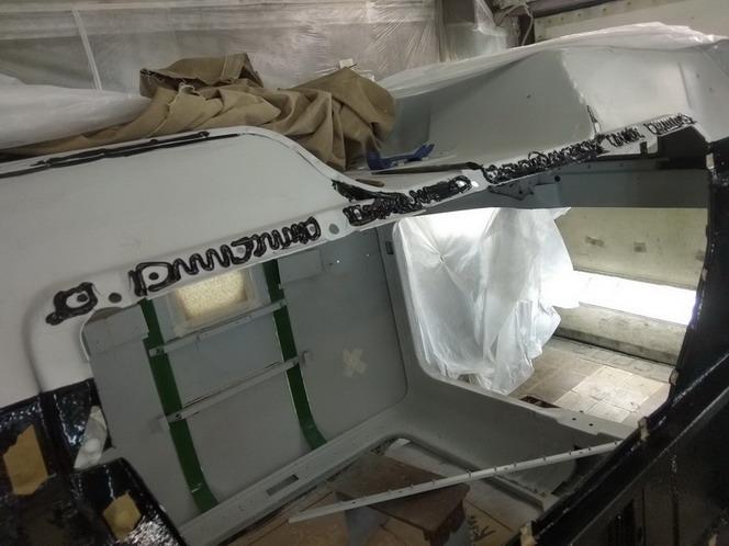

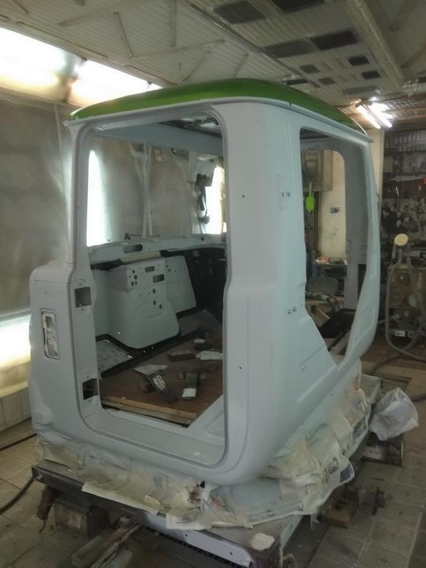

I like the roof supports. How are they fixed in?
Timmy,
That's a good question. I spent some while figuring the best option to fit the strips.
The matter was the roof had a kind of pocket at the rear and the front, a space above say rear wall top edge and windshield frame top edge. I bought a piece of 6x60mm steel stripe, just common construction steel, and bent it to put its rear end standing on that "shelf" of the rear wall top. Than it was bent following the roof curve getting off its surface gradually from rear to the front. I mean when you put the rear end in place the stripe gets as lower off the roof as further to the front making a gap. It was nearly 100mm of the gap at the front end. That way if you force the front end towards the roof and finally having all the stripe contacting it you have to apply sufficient impact to it, something like you can apply with both your hands. The roof gets supported quite well at the time but you need to lock the front end some way. For that I cut the stripe so you can pass the windshield frame top and drilled two holes near the front end. Drilled threads in the holes and cut two steel squares (shims?) off a piece of the stripe stock. Drilled two holes in each shim. Than when you force the support stripe to get place at the front you use pry bar to get it higher than the windscreen top, put the shim to its bottom side and onto the windscreen and attach it to the stripe end with two screws. Releasing the stripe you get its front end landing on the windshield frame top and applying tension to the roof sheet.
When I bent first stripe I managed its curve to apply maximum force to the roof where it seemed to be needed. Spent nearly 40 minutes for the 1st stripe and than 20 to duplicate it for the other side. The 1st picture shows a test fitted stripe with just a piece of steel to lock the front end in place. The 2nd one was made after all was assembled by the final design.
I also added two cross braces to support the center. Drilled holes in the stripes, put screws with blind heads in them and welded over. Sure ground off the excess. Than when the stripes were in place I was able to put braces onto the studs (former screws) by means of holes drilled and attach with nuts. Put plastic shims between the braces and the roof sheet to compensate the thickness of the stripes.

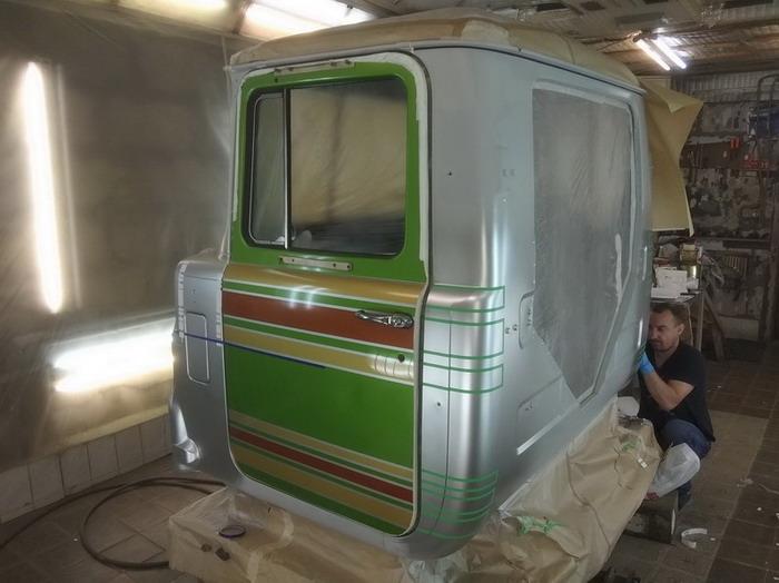

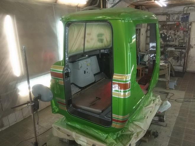

Wow nowadays very few people actually paint stripes like the old day now they just use stick on stripes.  Nice work
That's true. I made test attempts with vinil tape but it looked ways off from what I was liked to achieve.

On 3/31/2020 at 4:27 PM, Vladislav said:
The idea was to keep SGT general appearance but put some improvements
It looks amazing Vlad. I really like how you kept some of the SGT appearance . Just for the simple fact I remember seeing those trucks on the road. They always stood out. We actually called them Slime Green Trucks. So I really like how you changed the color slightly and added metallic .
These old trucks all have a story to tell. And by you keeping some of the SGT general appearance , you help keep that part of the story alive. Then with your changes, you just add to the story.
You're doing a great job Vlad !  look forward to seeing more progress.
