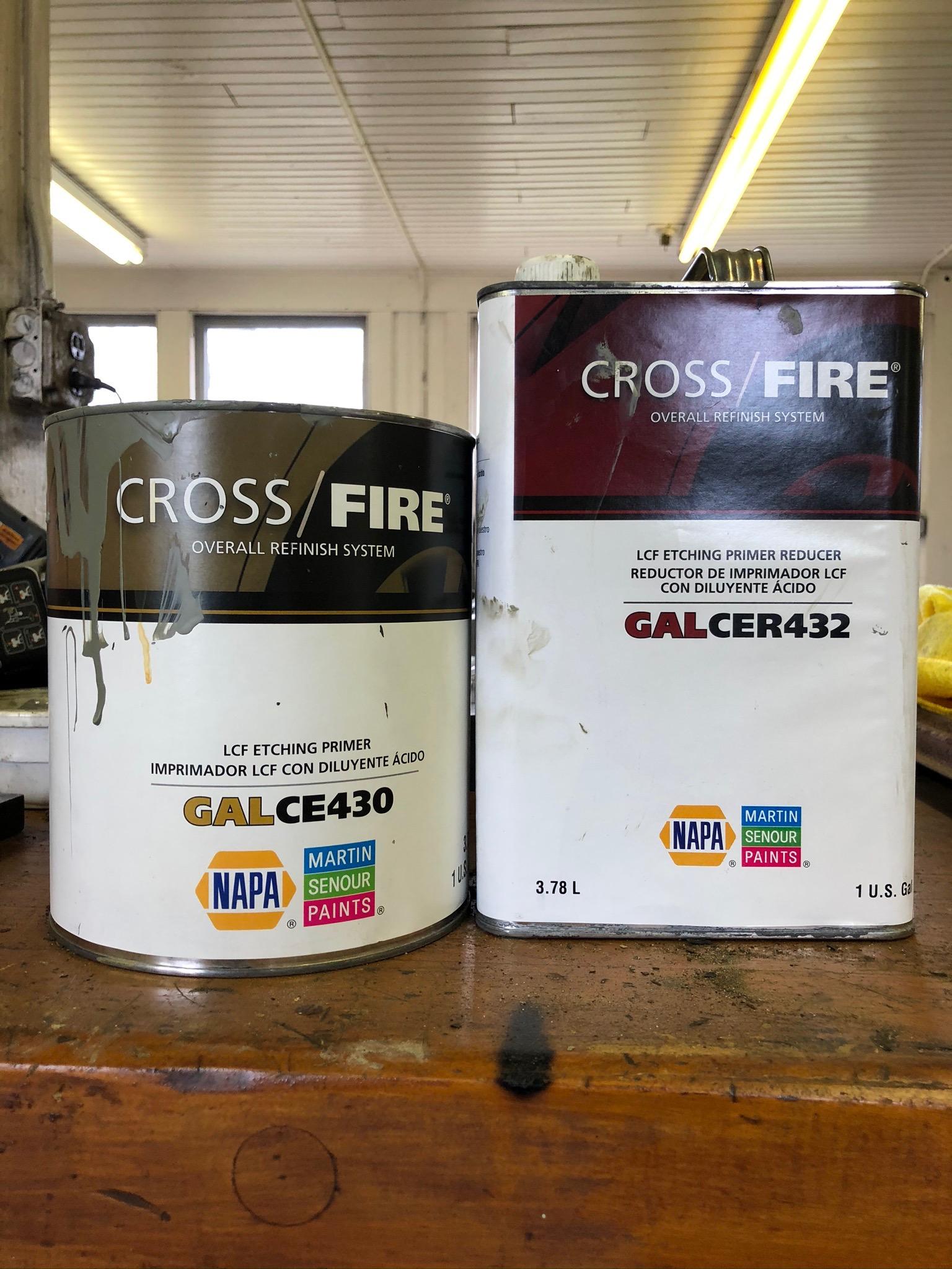

I've been using this etching primer from NAPA on everything, including the aluminum parts/castings. I'm going to use PPG Concept in "Fleet Red", paint code 75674, as a top coat. This was based on a talk with Matt Pfahl on what he's been using. My past experience has  been mostly with Dupont Centari enamel. I need to ask the PPG vendor about an epoxy/primer/sealer I used on my other B model project, as for compatibility. I had very good luck with my last job, and its lasted over 20 years with a lot of outside exposure. I don't do major projects like this often, so I ask a lot of questions leading up to painting and not wanting to have a very expensive screw up come out of it.
