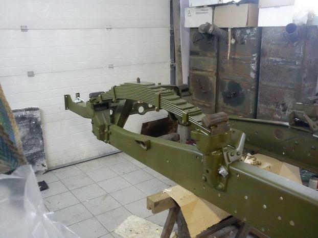

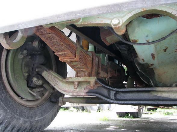

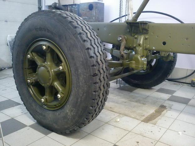

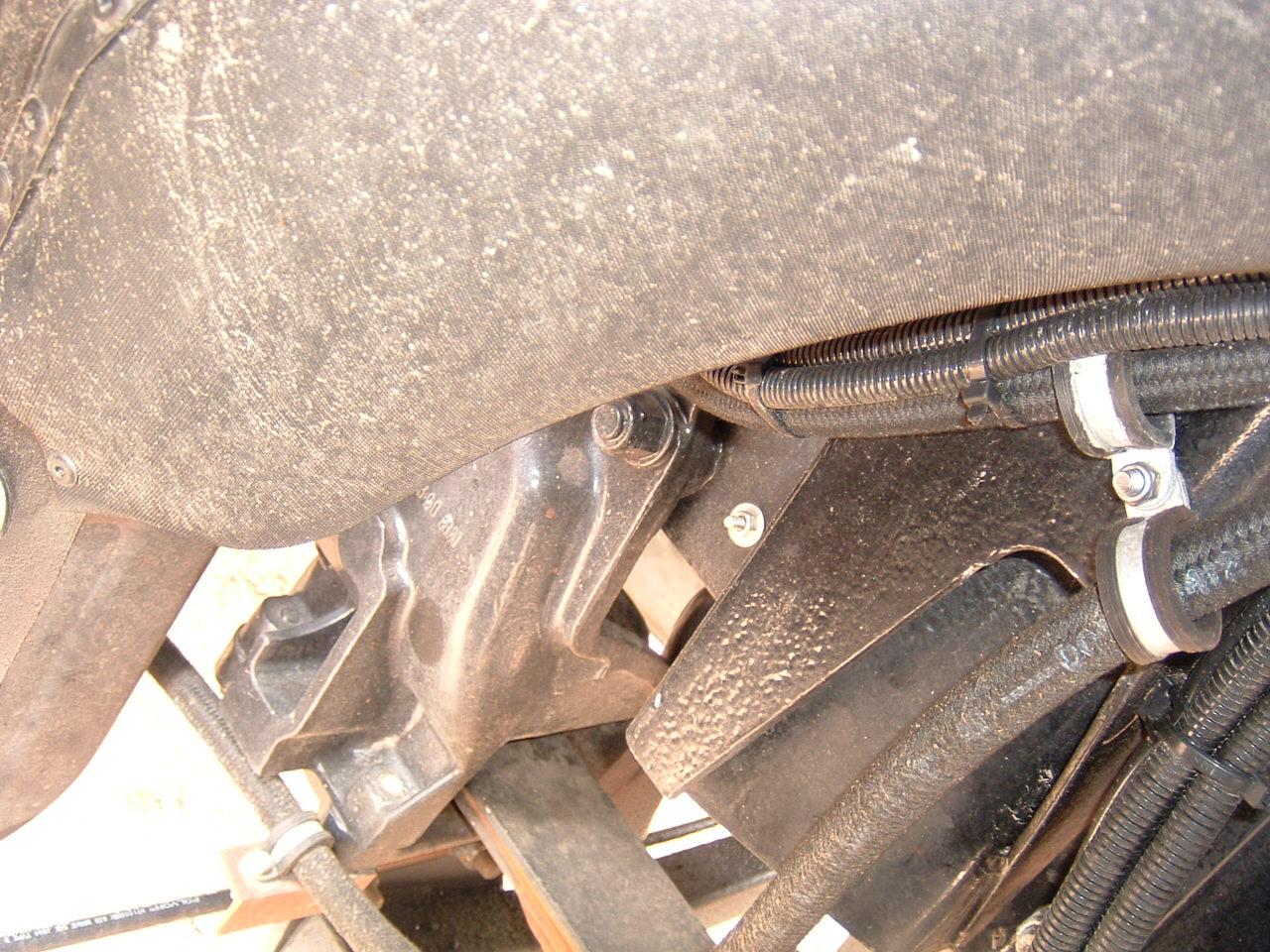

Not almost what you meant. That collar and pin setup was used on DM's including DM800 you are building. The style with rubber pads I mentioned was what was used on L-models including LT's. I have that setup in my 1945 military Mack. The front axle assembly used there was off a L-model I belive. The picture of the light green frame (not khaky) is a C-model front spring rear bracket. As you can see its body is similar to a R-model part by the shape but accomodates the spring end in rubber pads clamped with a cover. Difficult to see on the below the chassis picture but you can if zoom in.
I can see what you mean. The spring is clamped between the two ends of the rubber which is different to the collar arrangement which I thought you meant. Maybe this style predates the collar set up. More research needed!

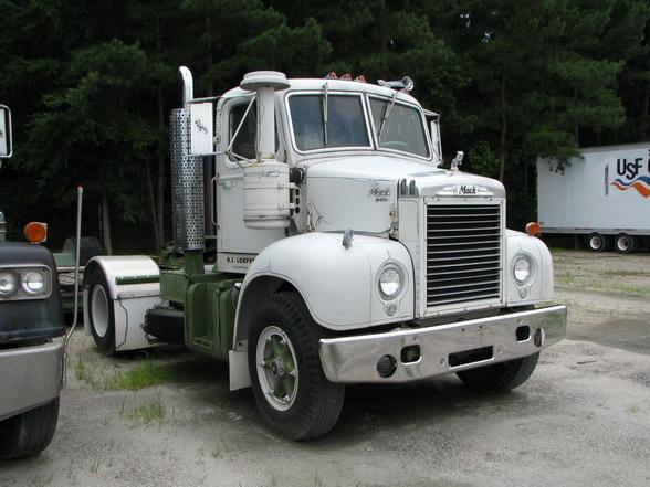

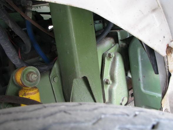

It looks like the rubber insulated spring mount stayed in production for a long time if it was still being used on the C series in 1963. Was it offered as an option alongside the collar and pin and standard shackle or was it replaced by these?
Here's a picture of the hanger on the above C series. It looks pretty much the same as the one in Vlad's picture.
