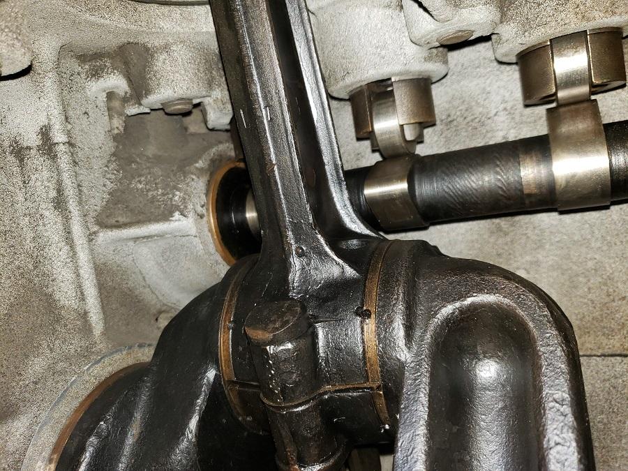

I would pull off the pair of inspection covers on the drivers side of the block and see if there is and bad stuff that found its way in, shoot some Marvel on the crank and rod journals to give it some help while the top end is soaking.

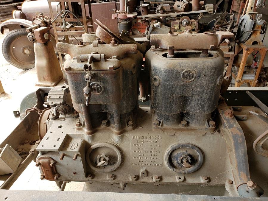

Thanks for the advice. What oil should I use in this engine. Its clean inside like its never been started, except these is a lot of heavy dust in there.  I will need to flush it all out of there out. I have a solvent tank with 40 gallons of new solvent. I might just wheel it on over there and spray the solvent in there. Then re-oil everything. I could not believe they had roller lifters back then.  I really do think the guy got through most of the chassis restoration a long-long-time-ago.

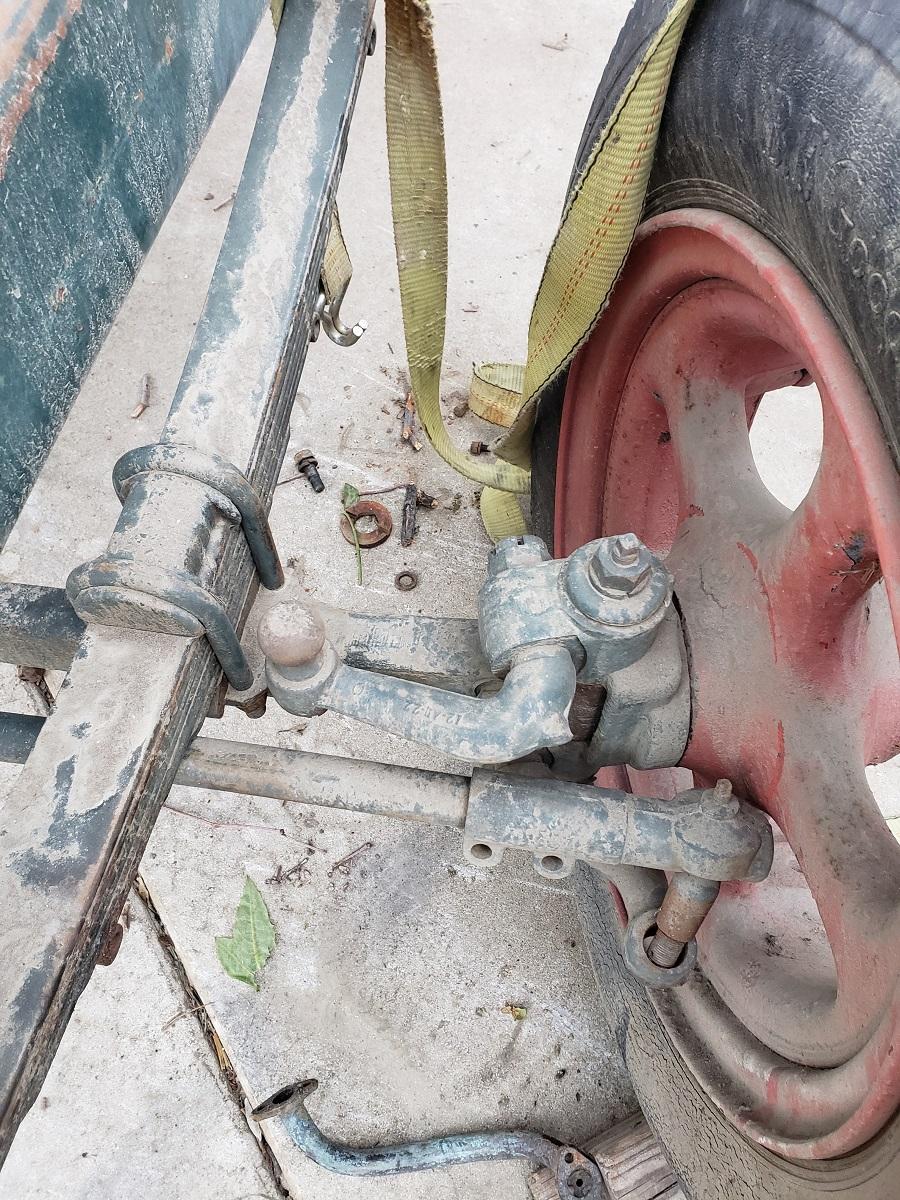

Not a rust pit on this truck20190430_185226.jpg.ecc670d1ddaef5ded3b25455ea829f05.jpg

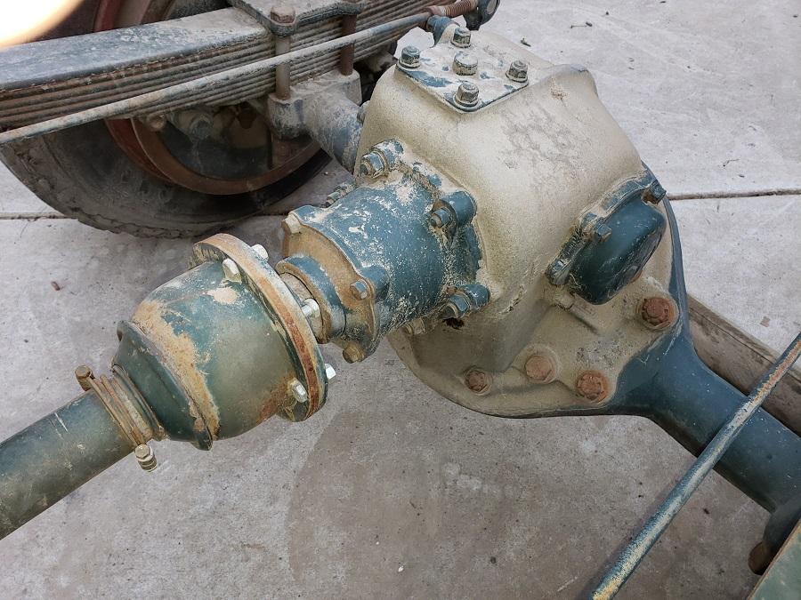

20190430_185521.thumb.jpg.c6567663b2fc0927aab262525933a8a4.jpg20190430_185530.thumb.jpg.1cbffc721dd202af06d942e14c803380.jpg20190430_185516.thumb.jpg.31a19f43a1362b6c618f58ea7350c5d5.jpg

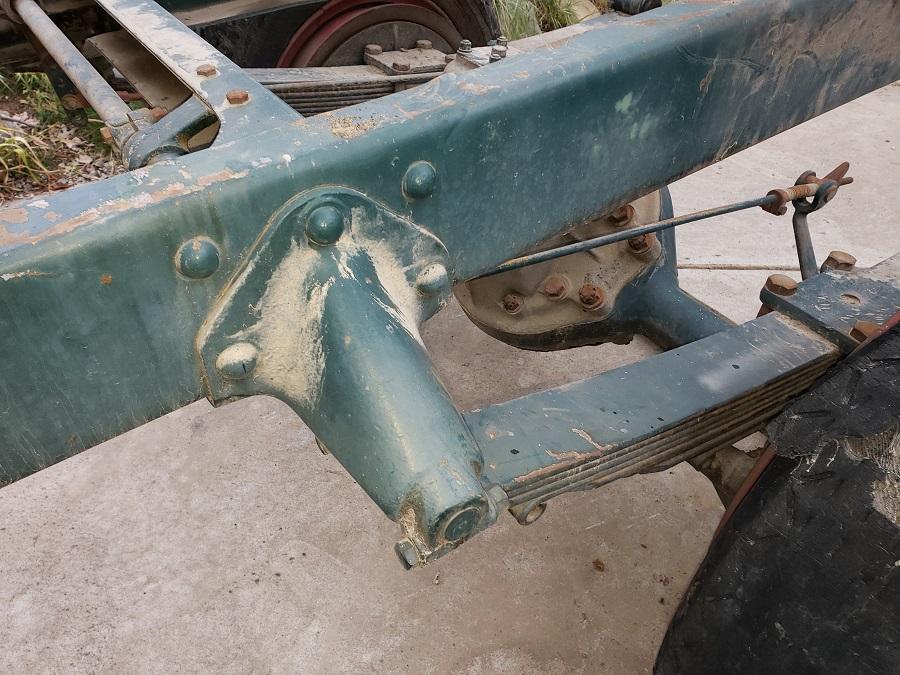

20190430_185234.jpg.947fee36af31af77252a18e365474289.jpg20190430_183355.jpg.436642def4b5bd244ad141059da21361.jpg
The only way to get that dust out of there will be to hose it out of there with solvent. No water ever got down in there.   As a former fleet mechanic I can say, that I wish all engines had inspection covers. I can't believe they had aluminum blocks that early.
