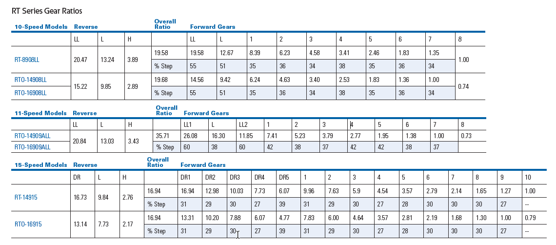

Did they put different gear sets in this transmission for dumps and semis?  Mine started life as a semi, but with a double frame, 44s, and 4.42 we bought it and converted it to a dump.  In GA we are at 64k gross on tandems.  Even after the engine upgrades with way more power, this transmission just doesn't seem to transfer power right too me.  I know what Mr. Wild will have to say about it, and with our other trucks being fuller's I tend to agree, but I dont want to give up on this transmission yet.

I am not sure what you mean by transfer power. But I think that transmission has a real low low like 26:1. I looked it up once on ratios it is similar to my rto-14909MLL road ranger. There is a lot of gears in the low geared area and the reverse is geared low too. My truck is a dump but started out as a concrete mixer. I think the lowest gear is to walk with a curb machine when pouring concrete. I know my dump works great under a milling machine. Similar to an 8ll but extra low in the low gears.

24.5 on the tires.  The low low is really low, slower than all of our 8ll double lows, which is great when we are milling like ahubbard said.  My problems are 1-4, even loaded unless I'm climbing a hill I usually go 1-3 and skip 2nd. Then starting out empty I go to the high side and put it in double low then shift to low then 5-6-7-8.  The high side of double low is in a range between 2nd and 3rd gear.  Shifting like that seems to be the smoothest where it feels like all the gear steps are setup correctly.  Even doing a rolling stop loaded it slides right into the high side double low nice and smooth and takes right off shifting smooth thru high side low and 5-6-7-8.

They look real similar except the low lows. My Mll trans is same ratios as the 14909all below in your pic. The 310mlr and 9LL Have almost exact same ratios. I have 4.42 rear as well. I was paying attention to my driving after thinking about your question. I find that I don’t rev real high in the lower gears. Actually kind of lug a little until I am

Larger displacement engines may tend to have a lower number on the rear, in the upper 3’s, because they can. Mack had to go mid to upper 4’s because of AI torque issue. The expectation was your going to rev the heck out of it because of it not having low end torque. They say so in the AI engine manual...page 18.
“The changes are more extensive and visible for the AC engine which is used in linehaul applications at governed speeds, than the AI/AMI engine which is used in vocational applications at higher governed speeds.” They saw how crumby the low end was.
The further into 4 you go the tighter the shift becomes especially on the low range. The number of MPH gained by in a 4th gear may be 4mph @4.64. The same 4th gear may gain 6mph when the diff is 3.86. The lower your gain the harder your shift.
Ex- take your overdrive trans and drop a 3.86 diff in and your top speed gain from 1300 to 2000 RPM is 32 MPH.
take the 3.86 rears out and drop in a 4.64 and now the 1300 to 2000 RPM OD gain is reduced to 27 MPH.
You may have tight shift windows, esp on the bottom, esp loaded going up a hill with a short span of gains between shifts.
Macks a challenging shift. I have to move the Log Dogs stick pretty fast to get my grabs with the 4.35.
The deepest ratio Roland had between modern trucks he was scoping was a 4.10 ratio.
If your skipping groups of gears loaded then you’ve overcome the need for a deep rear end when you modified the engine for more HP and torque.

1 with fuller 9L and 4.64, 1 with 8ll 4.64, 1 with 8ll 4.42, 1 with 8ll and I'm guessing mid to high 3s cause that truck will run 90mph, 1 with a super 10 and low 4s.  I really like the super 10, but with no deep reduction it will wear your leg out under the milling machine.  The quick shift doesn't bother me, I have had to learn how to let the jakes hit between shifts. I have no doubt this truck could probably use a taller gear, but if the trans is still a pain, is it worth it?  I've talked to other guys who say there t310mlr shifts nice and easy, so if I need a rebuild and it costs 7k or I can get a fuller for $3,500.  I hate to give up on the mack trans, but I feel like the $ is making the choice for me.
